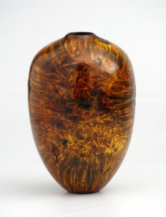

lew Posted May 5, 2020 Report Posted May 5, 2020 Just guessing here but, probably there was still a fair amount of moisture in the wood. As it finished drying, the stresses changed and resulted in the cracking. I used to follow a turner who went by the handle of "Trifern". He said that if you turn wet wood really thin, it will have less of a chance of cracking. Here's one of his pieces- Here's an idea to accent the crack- Lissa Hall and Gunny 2 Quote
