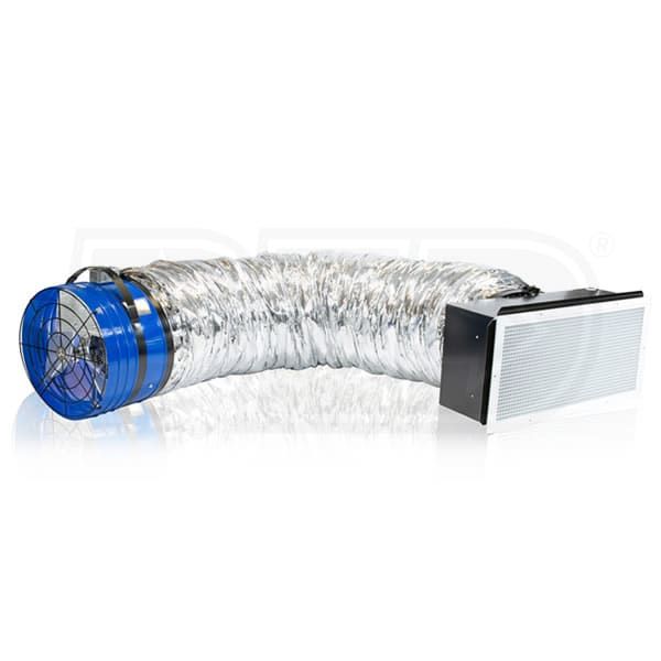

May 1, 20206 yr Author comment_227217 Looks like I am doing the install, folks out here want about 500 bucks to cut a hole in my ceiling and bolt a fan to the ceiling joists. I am all about paying the trades what they are worth, aint saying they aint worth it but, I just aint got that kind of money. So I am looking at a couple fans, the low dollar ones, and the higher dollar ones. The low dollar ones are along these lines. The standard fan, biggest complaint it noise. About 300 bucks. The higher dollar ones are along these lines, no complaints on these, and they are very quiet. These are 800 bucks, with Lowes veterans discount, it'd be close to 780.00 out the door. Any of these I can install in a short day, but I am torn between them. The big money one is, well big money. If it wasn't for the noise complaints on the traditional lower cost fan, I'd put that one in. Ho hum. Report

May 2, 20206 yr comment_227238 I have the large one, doesn't seem loud to me except when a chunk of belt came off and I heard the thump of the belt. Easy fix. Pros are it is cheaper and easy to do any repair or maintenance such as belt replacement. Con's it is much larger hold in your attic and Momma might not like the large louvers. Mounting will be fun, you have to block off and brace for the fan and of course will have some clean up and touch up trim to do. You would want a screen somewhere to keep the bugs out. That is a challenge sometimes. I have two doors I put insulate board inside as I made them and a heavy fleece curtain I sewed up to go over that for winter weather. Effective and it hides them well. But mine stands upright. The other unit is pricey but delivers alot for a small package. Pro's would be smaller unit less eyesore and same or better cfm. Con's it is direct drive and despite what they claim it might get noisy as time goes by. Smaller unit mans more heat in a concentrated place as the motor runs. Are you in a hurry for this? I put out a few feelers with some people I know. Might turn up a deal but that might be a week or so before I hear anything. Can't promise anything but some of these people would love to even up the score sheet on favors they owe. Report
May 2, 20206 yr Author comment_227248 Gunny, thanks for the info, and thanks for the score sheet! Gonna install tomorrow, the next few weekends I'm booked up, so this weekend is it for me . Going to Lowes tomorrow to kick some tires. We'll probably bring home the Quiet Cool, man it's a lot of money for a fan, but it has great reviews. Installation is easy compared to the bigger fan, the Quiet Cool will fit between any layout 16" and 24" ceiling joists, no cutting or modification to the framing, only cutout square in ceiling drywall. Report

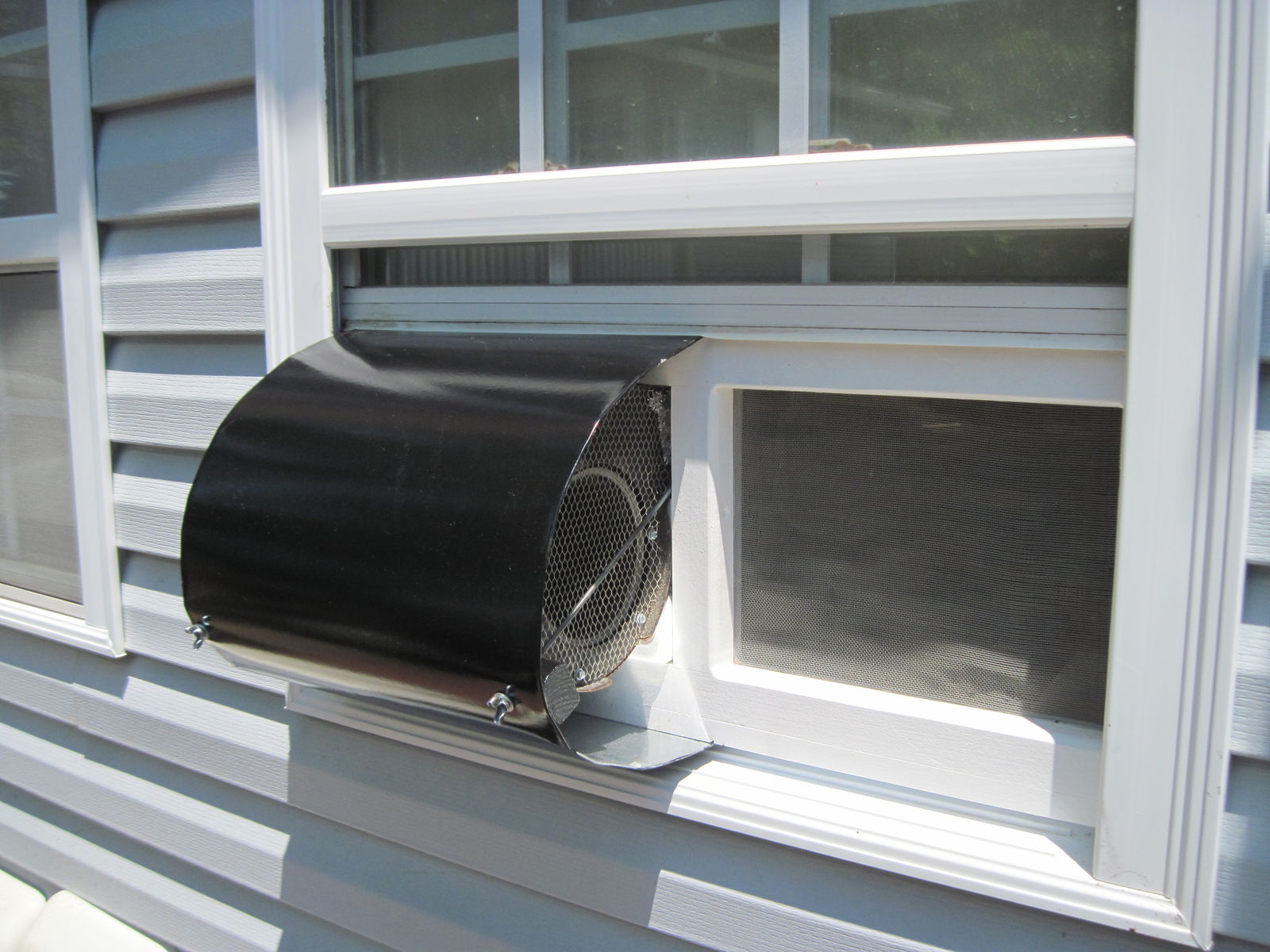

May 2, 20206 yr comment_227252 33 minutes ago, John Morris said: Installation is easy compared to the bigger fan, the Quiet Cool will fit between any layout 16" and 24" ceiling joists, no cutting or modification to the framing, only cutout square in ceiling drywall. Yes I read through it and the reviews. Pretty impressive and as you said it requires little modification. A solid addition. I am working on a small 18 inch or less fan build to go into a storm window to ventilate my new finishing room. Rule for this project is no modifications to storm window. Box I make for the fan must be able to sit in window. So far nothing stock made will do at less than $150. I can do better. Kinda like this little gem I made for my shop from a stove vent fan motor. Report
