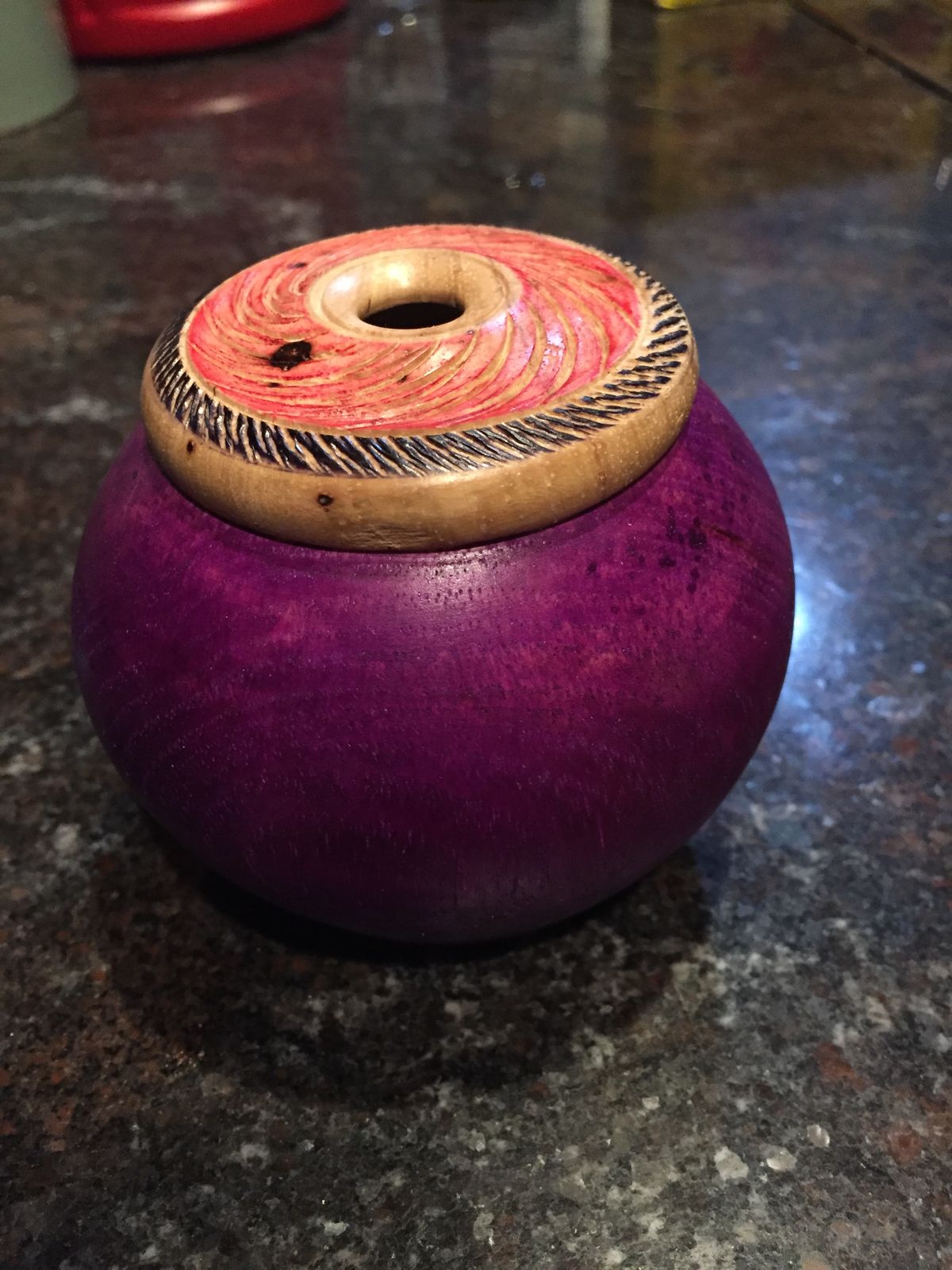

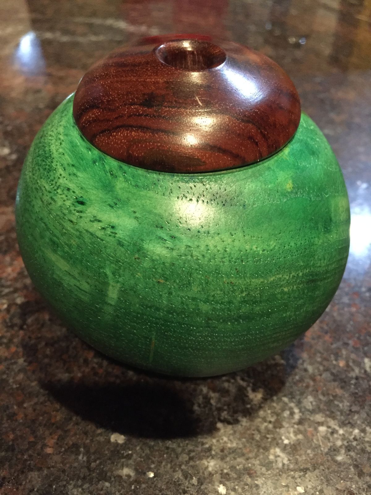

Ok here are the rest of the bowls. Still need a couple coats of lacquer.
All are pecan for bowl. This one has a cherry collar.
A variation on the burn patterns, dyed with Chestnut Stains, walnut collar.
Azobe collar on this one.
Those look great!!!!  Are you spraying the lacquer or brushing it on?
Very cool & unique Gerald.
I love the different colors and the burning technique ! They really are beautiful. It’s always nice to have a piece of art that was made in the shop to give visitors.
