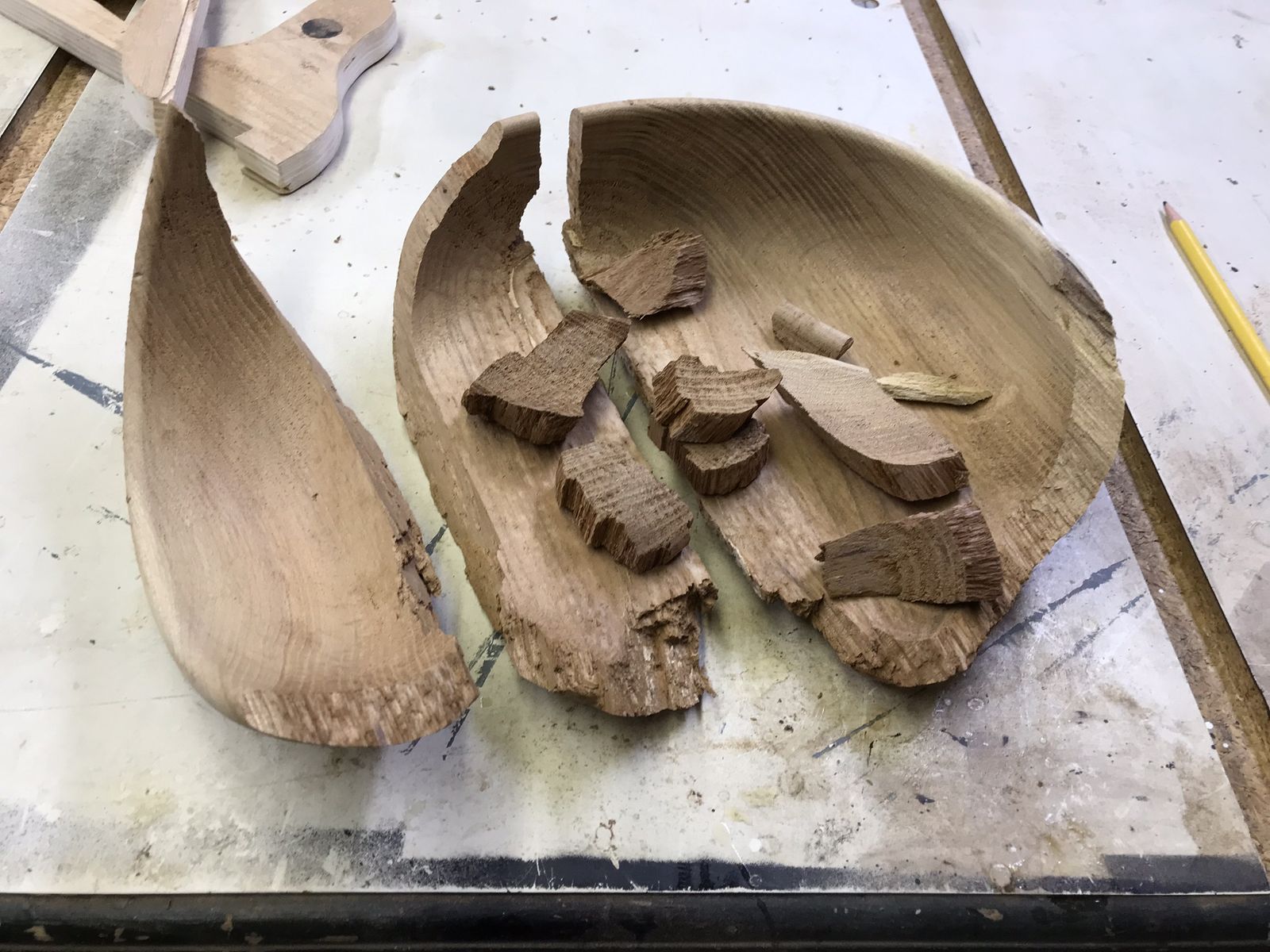

 Now, I always use face shield and mask. I didn't always and quickly found out some woods  aggravate my allergies, even if to get that last little bit done. I know better than not to use my PPE, I used it during all my working years and it was second nature to grab it before every job that required it.
Why? Because-
I was experimenting with different speeds using negative rake cutters. Wondering if faster produced smoother surfaces. Apparently the bowl didn't like 2800 rpms. Still haven't found all of the pieces. This was a piece of locust.
