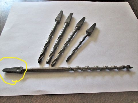

Pilot holes....as long as they don't go into my thumb.   Either in an electric drill, or a 6" sweep brace...

Do you have an auger bit small enough for pilot holes?
Might have a few..
Regular bit is a #5 = 5/16"....smallest twist drill is a 5/32".....
A #6 auger bit would be the same as a 3/8" drill bit...or, about the same as the counter-bore bit I use.
