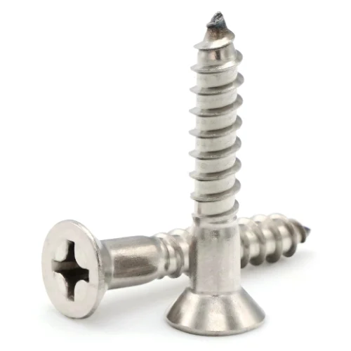

I'm reading some 1980s FWW and there was a slew of letters responding to a hint in a previous issue to use sheet metal screws instead of wood screws.  Some people commented that sheet metal screws (like drywall screws) are threaded all the way to the top so they don't draw the upper piece down to the lower piece.  I agree with this.   However 1980s wood screws were a lot different than the screws I use today.   The ones today have a constant diameter shank head to tip.  The ones back then had a fatter shank at the top.  My old combo pilot/countersink had a tapered drill bit to accommodate this; the newer ones just have a standard drill bit.  I think the difference is "cut" / "extruded" / "rolled" or something like that.   Here is what all my current ones look like:
Here is about what the old ones looked like:
Edited by kmealy
