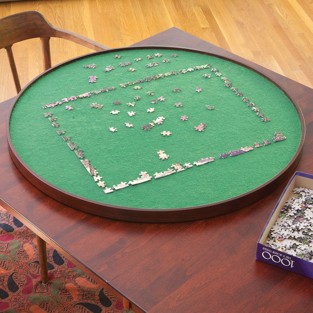

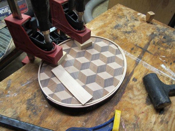

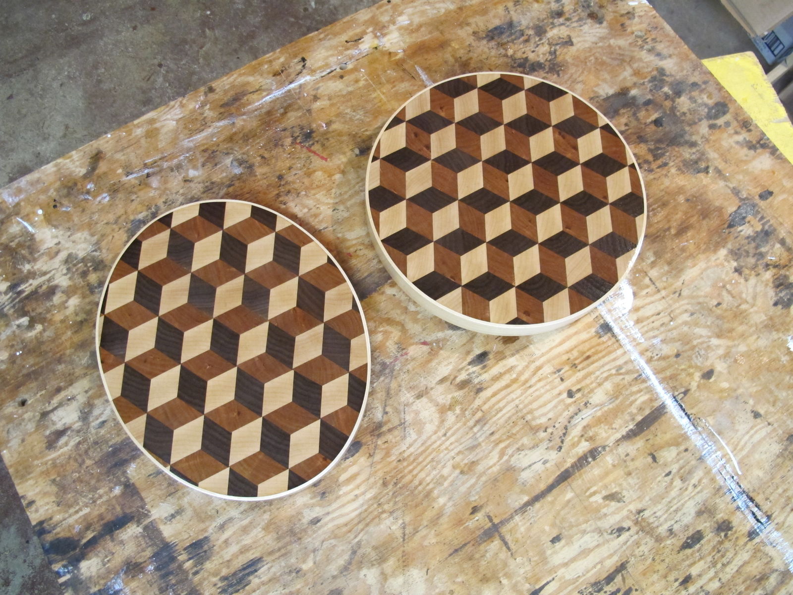

I did some smaller edge banding on some table top trivets. These were done in maple.

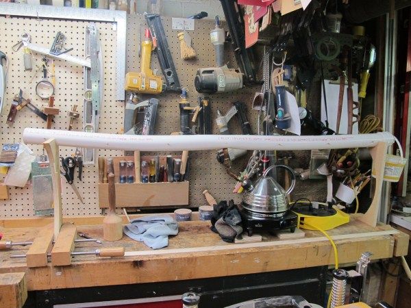

I made a steam chamber out of PVC pipe and bent the edge band
A word of caution, the PVC pipe was not solid plastic- more of a cellular wall structure. It did not hold up well to the heat. But it worked for what I needed to do.

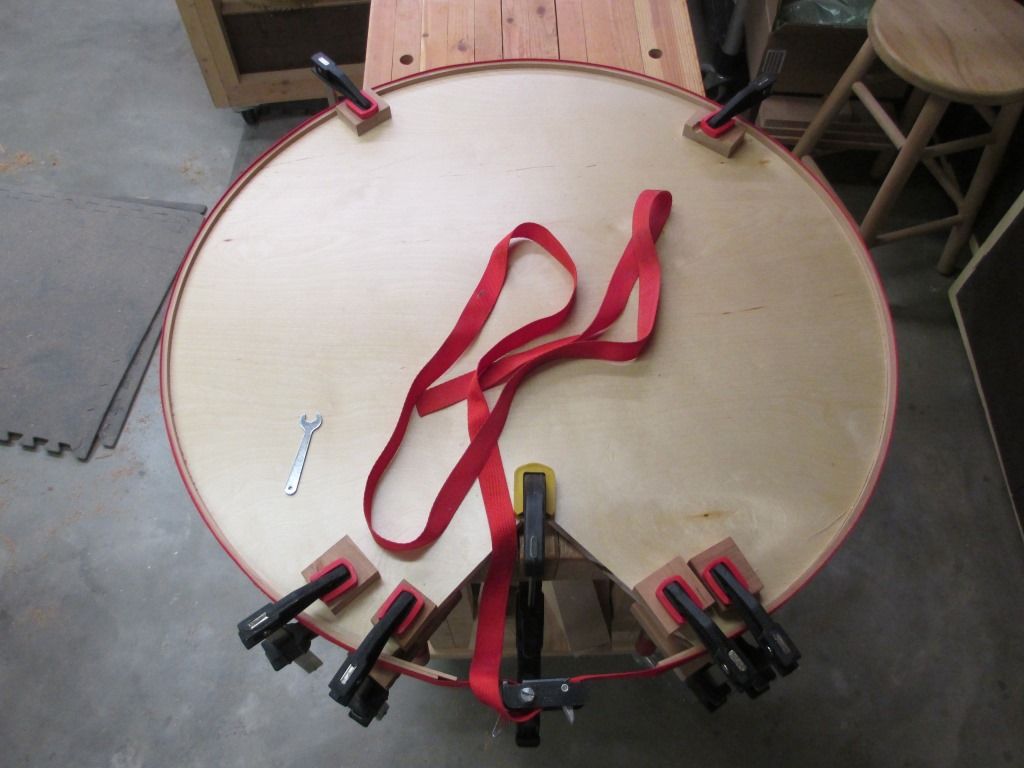

I used a web band clamp to apply the pressure and bend the heated wood.

That's actually how I did the joint on the round table trivet
