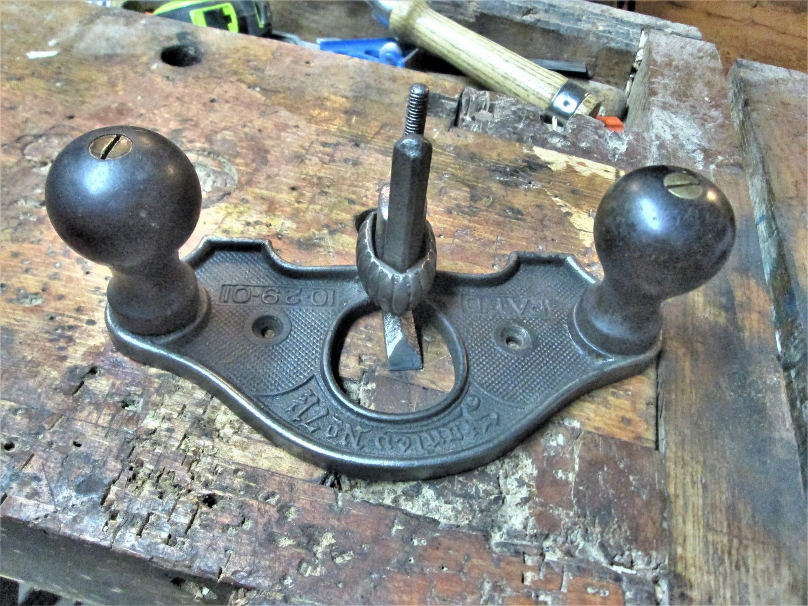

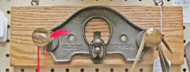

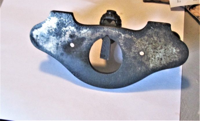

January 12, 20206 yr Popular Post comment_215228 "It followed me home, can I keep it?" When last seen, this was screw to an Oak plank, and hung as a coat hook....tag said "Dowel Cutter" $32.50 Plus sales tax. Got rid of the plank,....meh.. Had some issues going on....Got rid of the "coat hooks" , easy-out the broken bolt. Ordered the depth adjuster wheel ( $20, ebay) and cleaned things up a bit.. Easy-out wasn't....iron needs a lot of work.. Sole is flat, and cleaned up.. Tool drawer, I needed a wrench, and a tap.. 1/4" x 20. Have since bought a new thumbscrew at Lowes....1/4" x 20 x 3/4" long. will need to grind a point on it's end. About them handles? had some "spare" knobs, with bolts, had to find 2 that looked like they matched each other... Close enough? Plane is a Stanley No. 71-1/2, patent date is 10-29-01.....1901, that is. Think I can keep it? Report

January 12, 20206 yr Author comment_215249 Note: This is what it looked like, when I bought it.. Called a Dowel Cutter... Been watching this for almost a year....3 block walk from my house..... Report

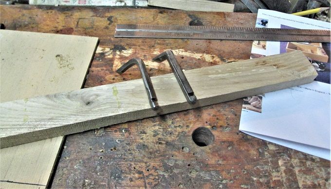

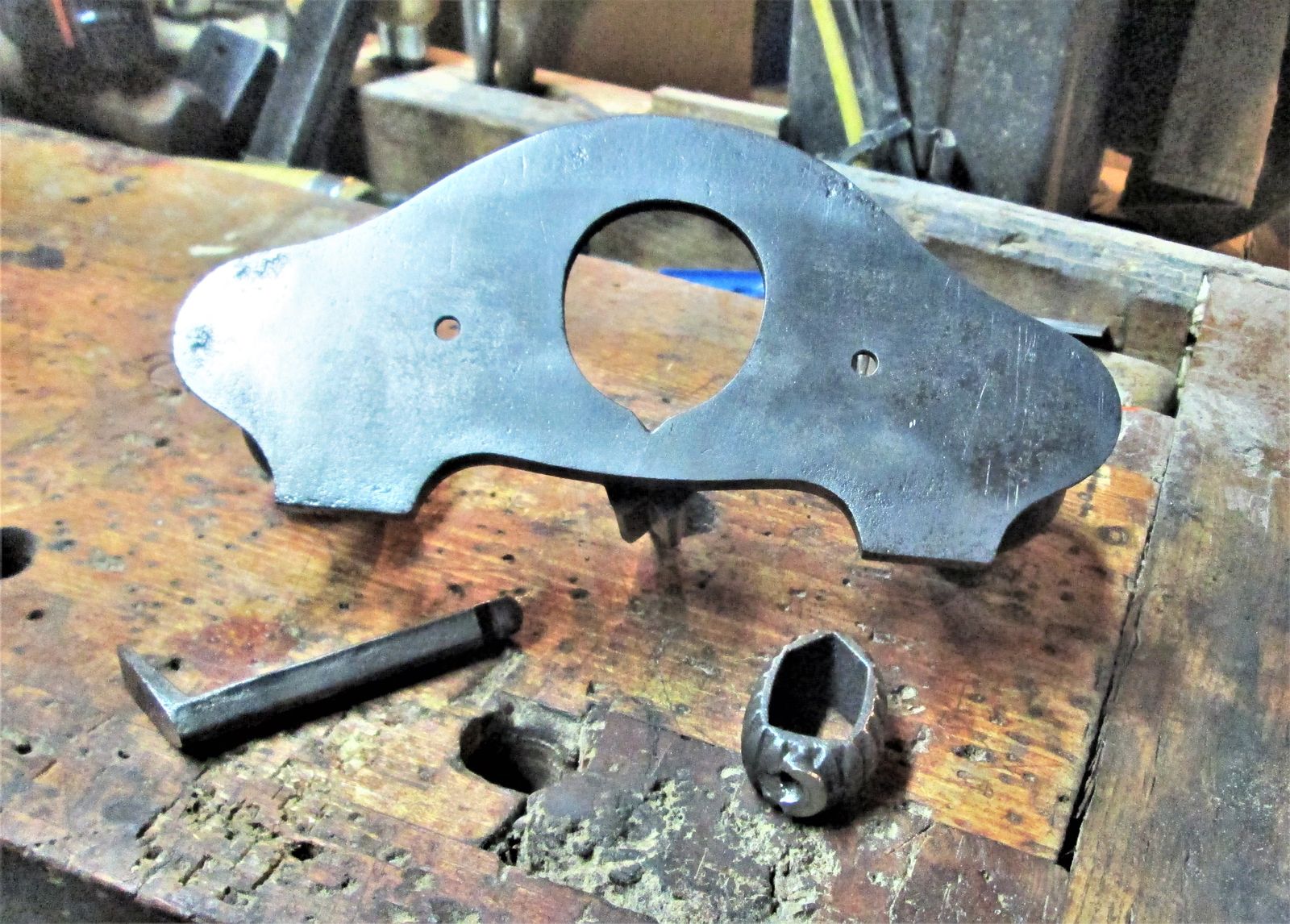

January 14, 20206 yr Author Popular Post comment_215347 Ok, we gaining on it... Handles installed. Iron is now as sharp as I can get....and it's edge is even straight. $0.45 Thumbscrew....end has been ground to a point. Wheel gets here, Thursday. Test track? Knifed the lines, then used a backsaw....results? And a flat bottom.. Been doing a bit of grinding, today... Trying to turn this... Into a 3/8" wide cutter....about 1/2 way done.....the 1/2" one is more like 0.475" wide.... Might just be a keeper.... Report

January 16, 20206 yr Author Popular Post comment_215566 Rehab complete. adjuster wheel is cleaned up, and installed Might be a keeper... Report

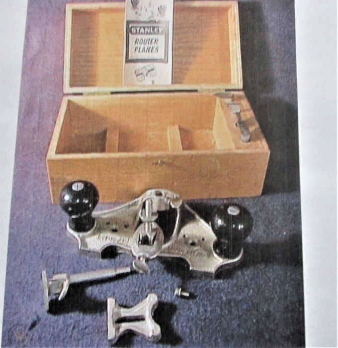

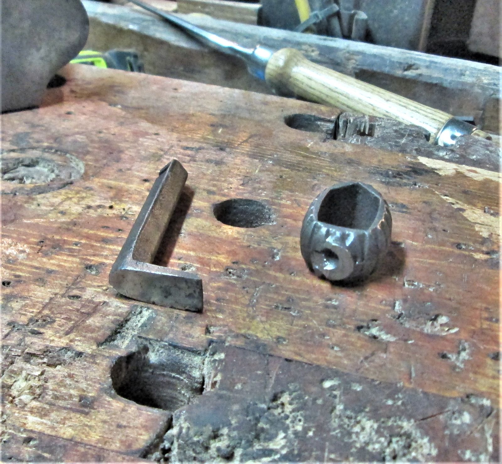

January 24, 20206 yr Author Popular Post comment_216396 Roh kay, raggy...Since I now have a better grinder wheel on the grinder...decided to finish working of the 3/8" cutter from an allen wrench... had to get a cup of water...had to shorten the length a bit.. As it was a bit too tall, a case of grind and dunk, grind and dunk...Once it was the right length, and the end rounded over...then a Dremel with both a cutting wheel, and a grinding wheel the right size to make the notch...Two cuts to define the notch, then the wheel to make and level the notch..test fit? And, we have a 0.380" wide cutter. Look just above the left knob, you'll see a track made by this cutter. Now..my Stanley #45 has it's own box/case. There are 3 other planes that call a box home.. A Ward's ( Stanley) #78, a Stanley #39 3/8" Dado plane, and that Auburn Tool Co. No. 181 skewed rebate plane...had to tear down the 78, but, everything fits...even the lid closes Sooo, thought about building a box to house the 71-1/2, and it's cutters....might have some lumber left over.. Not sure about a case for that other router sitting there.... Did a screen shot, of a candidate for such a case....might just keep me busy over the weekend? Edited January 24, 20206 yr by steven newman Report
January 24, 20206 yr Author Popular Post comment_216470 Found this on the inter-webby.. I think I could build a better version? Might take a weekend? Report

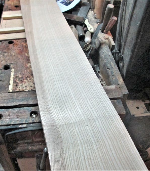

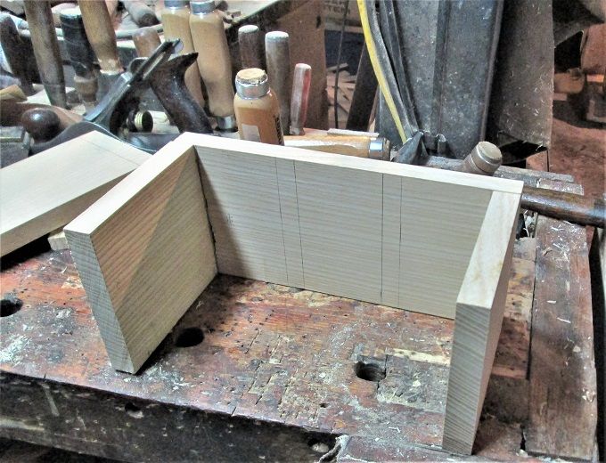

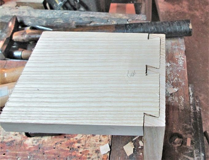

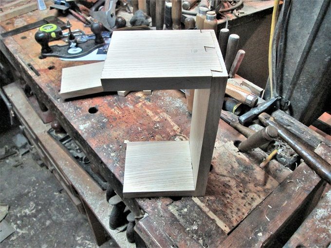

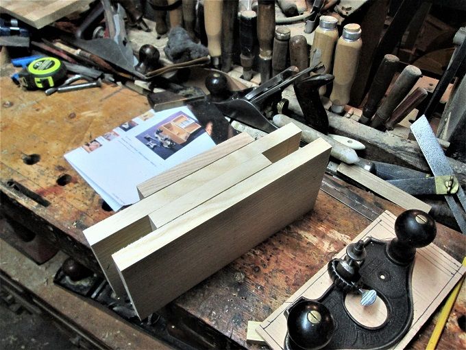

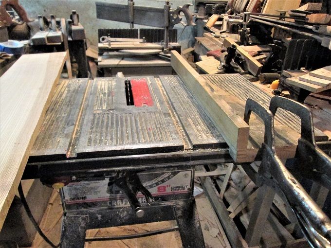

January 25, 20206 yr Author comment_216525 Roh, kay...here we go, again.....drew a few lines, once I found a decent piece of plywood for the bottom of the box-to-be.. 1/4" in from two edges....this is to allow for a groove to house this plywood....bunch more markings coming. And the rest of the grooves...mainly to allow the plane to sit in the box.. In theory....however...other things must fit inside. There is a wood block to hold the cutters.. Which sits between the plane and the end of the box...like this... Had to add a bit...I also traced around the plane. And, made 2 runners for the plane to sit on... Cut the plywood to size.. So..NOW I can figure out the sizes of the box's sides....There is a plank, that I'd like to use.... So the grain runs all the way around the box...There was a slight problem, though.. Edge I wanted to use was a bit too wavy...other edge was a bit better.. Plank was also tapered, end to end....we have ways.. Set to the narrowest width, set the better edge against the fence, buzz the bad edge off, reset the fence a bit, and straight line the other edge. Not enough room to cross cut the plank on this saw...again, we have ways... This keeps up, I may have to send this out to be resharpened... all sides cut for length.. Don't really need the box this tall.. Just a little off the top? Next ...set up the other router, with a 1/2" dovetail bit. Cut a few sockets, doing pins first....then laid out and cut a few tails.. Will fine tune the fit, after the grooves are milled..got a second end done.. Nice, when I need a hammer to drive these together...let alone drive them apart.. Was getting a bit tired... Swept the floor, and called it quitting time. May work on the other two corners tomorrow....start time was 1445 hrs...quitting time was 1630hrs... Stay tuned...might get interesting.... Report
