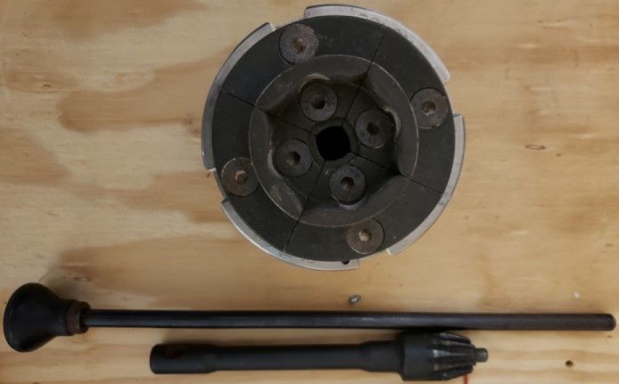

It is a decent price considering the cost of a new lathe and then buying a chuck.  A new chuck will run about $150.  Changing the belt is the only way to change speeds on this lathe.  Delta sells an electronic variable speed lathe model 46-460.  The Crown lathe tools would be another $150.  Is there a picture available?
Here it is
Get it, take her for a spin and learn how to turn.  In time you may see you want bigger and get one, or have both.  I have a JET 12x14 since 2001, works great and still use.  Got a Rikon 700-100 for $75 with chucks and tools few years ago.  Only thing I have yet to do is get extension bed for longer turnings.  Both have been great for the limited turning I do.  BOTH have step pulleys so I have to change the belt to get different speeds.  They work, I don't mind.  I keep a pen jig in the JET and a chuck on the Rikon.
That seems like a good lathe to start on Larry. But one warning. Turning is very addicting. Also find a local turning club. A little instruction goes a long ways to making it a pleasant experience.
Paul
I missed seeing the chuck I would go for it now.

Well I am not sure I got as good of a deal as you did but I was able to pick up the Delta LA200, the chuck and the tool set for $175

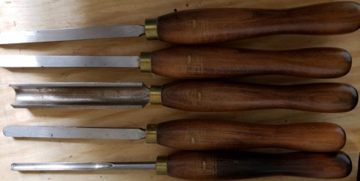

The tool set is the Crown 280 5 Piece and includes a 3/4" roughing gouge , 3/8" spindle gouge , 1/4" parting tool, 1/2" round nose scraper and 1/2" skew chisel.  They look to be in good shape however there is alittle surface rust on the 3/4 gouge (should clean up easily).  This set list for $175 on Amazon.
I think you did well. Now to get it set up and have some fun.
I say you've done very well. The Crown tools are decent and I believe the chuck is a Oneway brand which is also a good deal.  Congrats on the new lathe.
