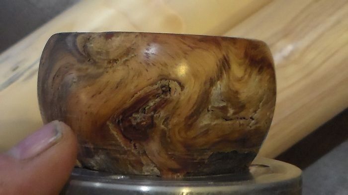

November 26, 20196 yr Author comment_210300 I went ahead and turned it a bit with the faceplate and this is what I got... I think these burls may have some potential... Report

November 27, 20196 yr comment_210317 Beautiful! Judging from your thumb, are they 3-4" in diameter? Jim Report
November 27, 20196 yr Author comment_210318 The small burls are about 3 to 4 inches in diameter, the bigger ones about 6 to 8 inches in diameter and the bigger ones are more football shaped than circular most of them. Ohhhh wait, you meant the bowl/cup thing, it is exactly 3 inches in diameter and 1 9/16 inches tall. And it is all the same thing just different views of it. Edited November 27, 20196 yr by MountainGaurdian Report
November 27, 20196 yr Author comment_210319 The wife wants me to make a top for this and shape the edges like an acorn and put an acorn stem on it as a handle. Trying to think exactly "how" I would go about doing such a thing. Was thinking I could put the bottom of the lid to the face plate and then tool in with a flat bit from the side and leave the central piece the same diameter as the inside of the first piece. Then as I get toward the middle of the next burl I can leave an umbrella shape facing the faceplate. Tool out the top almost smooth leaving some irregularities. Then cut off the center piece attached to the faceplate and run the edges on the small table top scroll saw to get the acorn top shape and then do a little bit of hand carving. I can carve a small acorn stem top out of a separate piece of wood and drill and glue that in as a handle set at a bit of an angle to the top maybe. Then color the top a slightly darker color. Still working it out in my head, to see if there are going to be any hidden surprises with that... lol... Report
November 27, 20196 yr Popular Post comment_210336 For a box you need to flatten the top of this piece. Make a top with the very to in the chuck or mount (faceplate) and set the tenon which goes inside the box a friction fit or if not you can use a paper towel to hold it tight. Now you say where is this going.... After turning the inside of the top fit it tightly to the bottom and put the box on the lathe between centers. Now you can shape the acorn as you think it should look. I have never done a acorn but you are just turning a box in a acorn shape. Report
