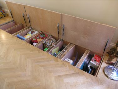

October 6, 20197 yr comment_204206 1 hour ago, BillyJack said: trying to put 7 senco staple/nail guns,4 cordless drill/screw guns and 3 sioux pneumatic in a 48" shelf cabinet is becoming a pretty big task. Trying to think positive... Is your shop on slab or raised foundation? Report
October 6, 20197 yr comment_204217 2 hours ago, BillyJack said: Raised ranch garage shop I was thinking something along these lines? Report

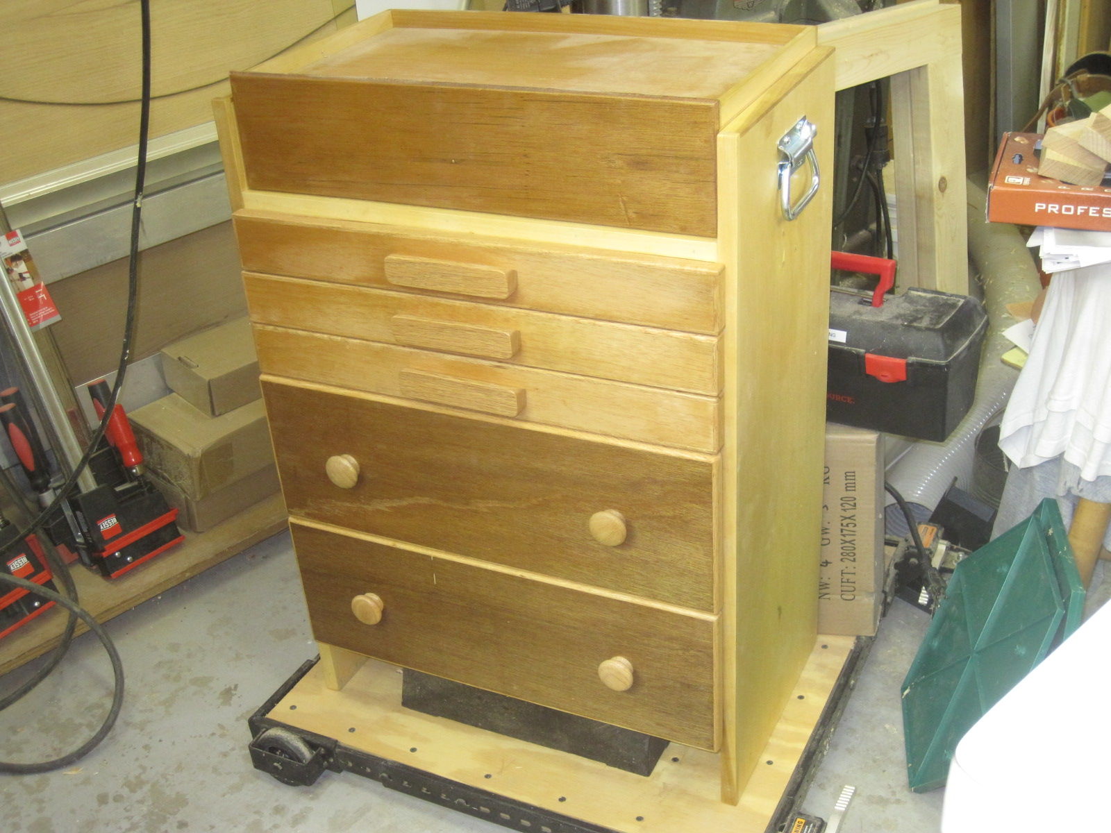

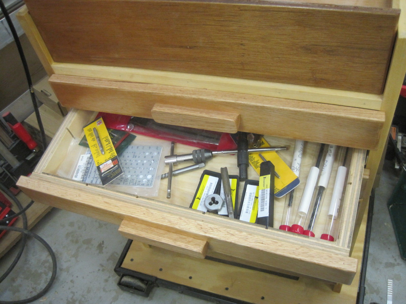

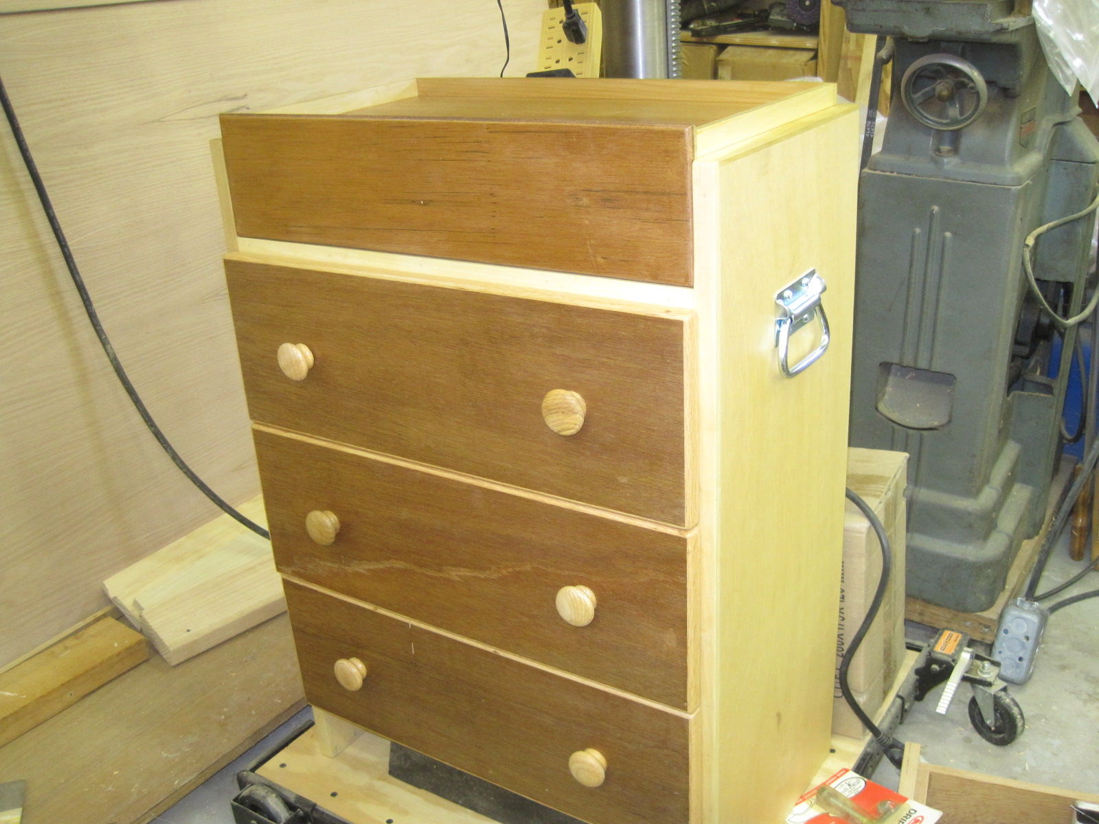

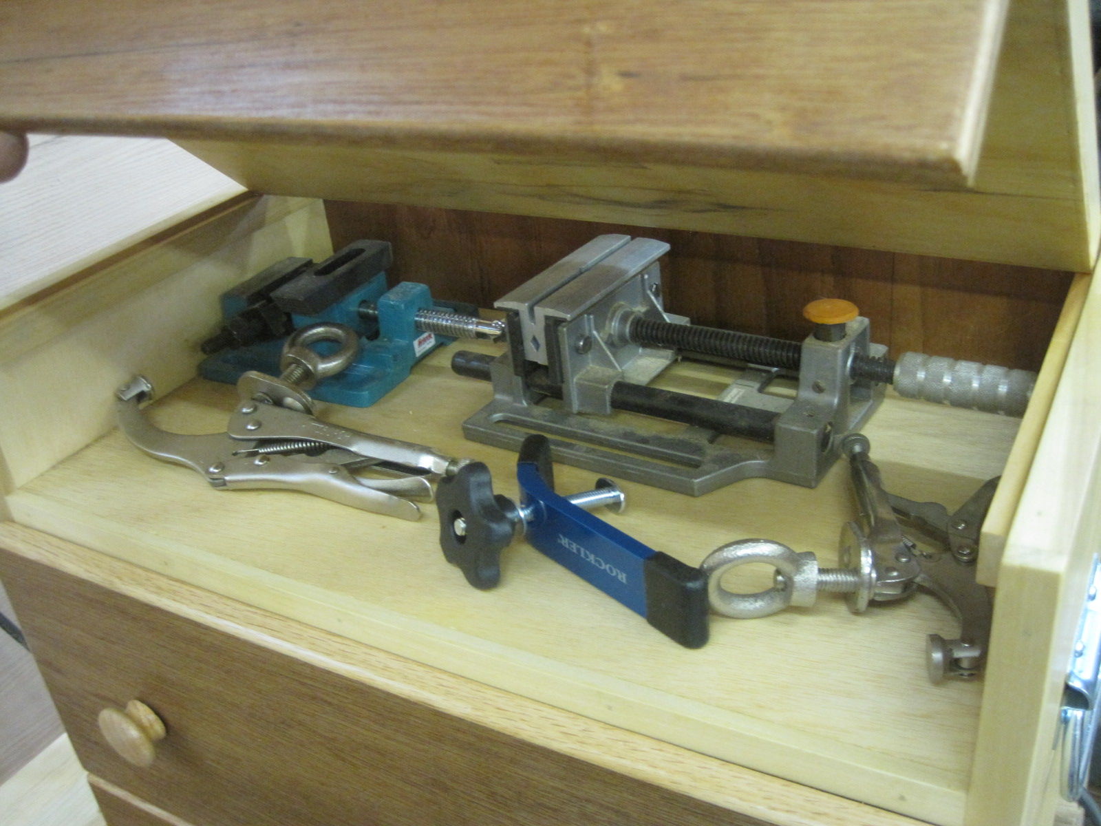

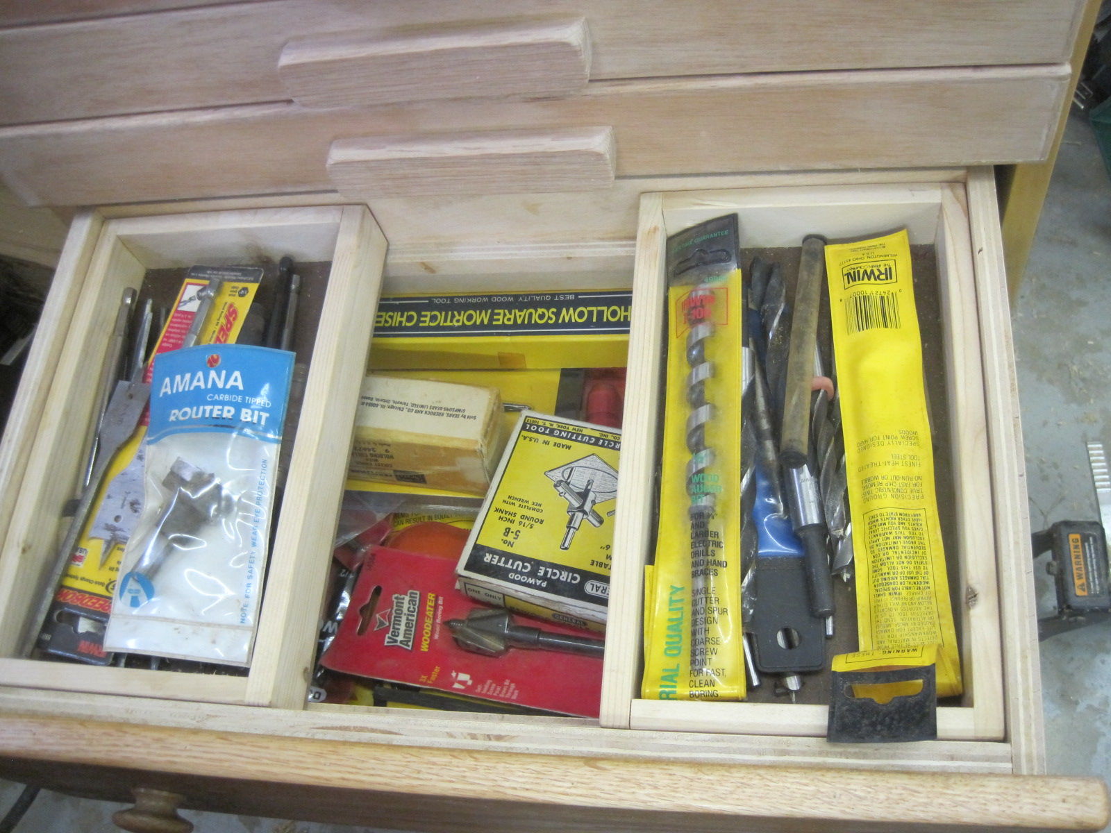

October 6, 20197 yr comment_204225 +1 on the shallow drawers, much more efficient to have the tools in a single layer. I built a cabinet underneath my drill press with three deep drawers, found myself constantly digging to find things so replaced the top drawer with three shallow drawers, the perfect solution. The original cabinet with three deep drawers. The cabinet after replacing the top drawer with three shallow drawers. Also added sliding trays that can be moved for access to the lower contents or removed completely if necessary. The shallow drawers are perfect for drill bits and so forth which have minimal height. The top section has a removable cover to hide vices, clamps and various tools, and also gives me a surface to lay things on while I'm working at the drill press. I now plan to redo my large bench, replacing most of the deep drawers with a mix of not so deep and shallow drawers, sized to match the height of the contents; I figure that the ratio of deep to shallow drawers is probably going to be at least 5:1. The shallow drawers in the drill press cabinet are just supported on lengths of aluminum angle, will do something similar (angle, wood strips or dadoes) on the other bench as there's really no need for slides as there shouldn't be too much weight in these smaller drawers. Definitely going to make life easier and (hopefully) reduce the time spent looking for a specific tool. Report
