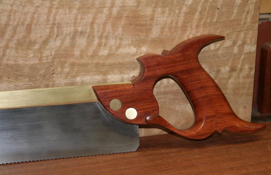

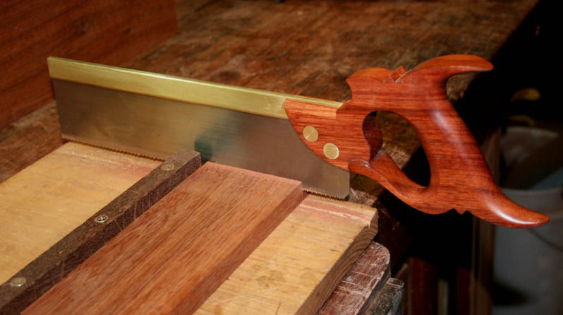

The first is a carcase saw: 14" long and 2 1/4" wide saw blade, 14 ppi crosscut. The wood is Jarrah.
This was a lot more work than the end result indicates. The raised lamb's tongue is tiny for the extra effort involved in carving away all but the raised areas (one on each side of the handle) before shaping the handle ...

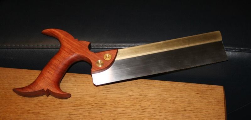

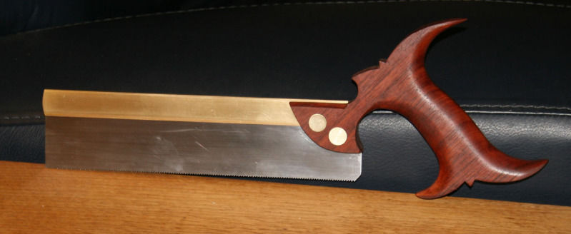

The following is a joinery saw, 9" long plate with 1 1/2" of cutting area and 16 ppi crosscut.

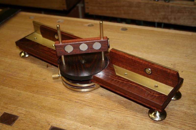

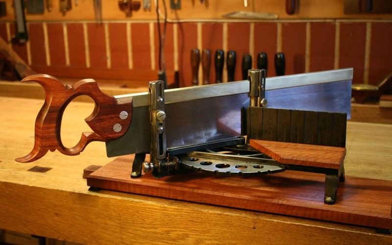

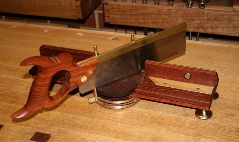

I always wanted a small mitre box. The large Millers Falls #74 and #75 are gigantic, and really carpenter tools - not for fine woodworking. I wanted the Millers Falls #15 1/2 ... but they are like hen's teeth and expensive.

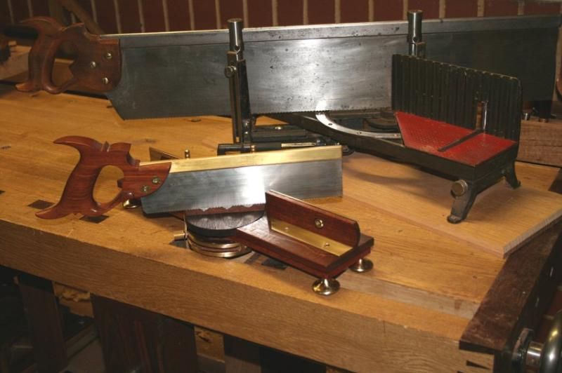

So I build one, which I called the Steam Punk Mitre Box :)  See the difference in size with a #74 ...
The mitrebox is Jarrah and brass, just under 17" in length, 4" deep, and 3 1/4" to the top of the fences.
It utilises rare earth magnets on a slide as a saw guide ...

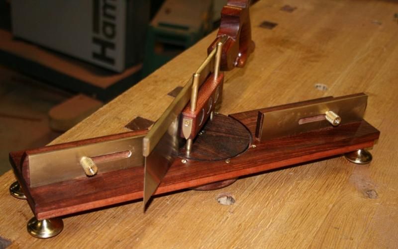

This is the rear: sliding fences and angle marker ....

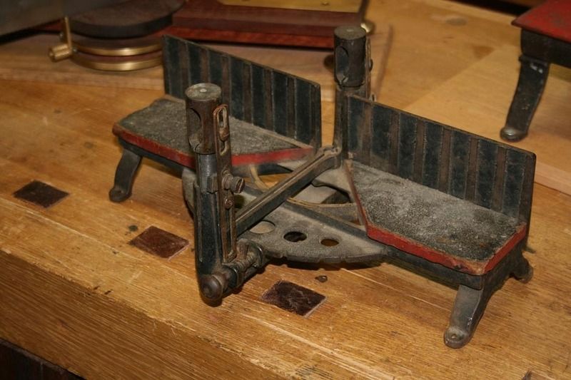

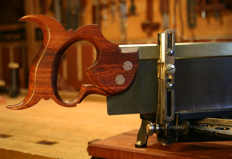

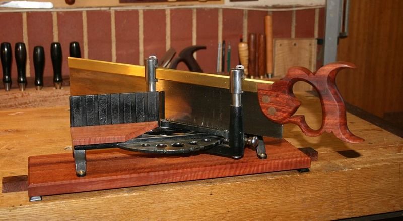

A few years ago, I managed to win this Millers Falls #15 1/2 mitre box on eBay cheaply as it was, well, buggered ... welded and missing parts, especially the specialised mitre box saw ...
The original saw was 16" long with a depth of 2 1/2". The one I built has a plate filed 13 tpi crosscut, and is 0.20" thick. The saw handle was inspired by a Grove tenon saw handle made by George Wilson, whom I consider to be one of the finest craftsmen around, whether tools or musical instruments. George built the saws for Colonial Williamsburg.
Restored box and saw ...
