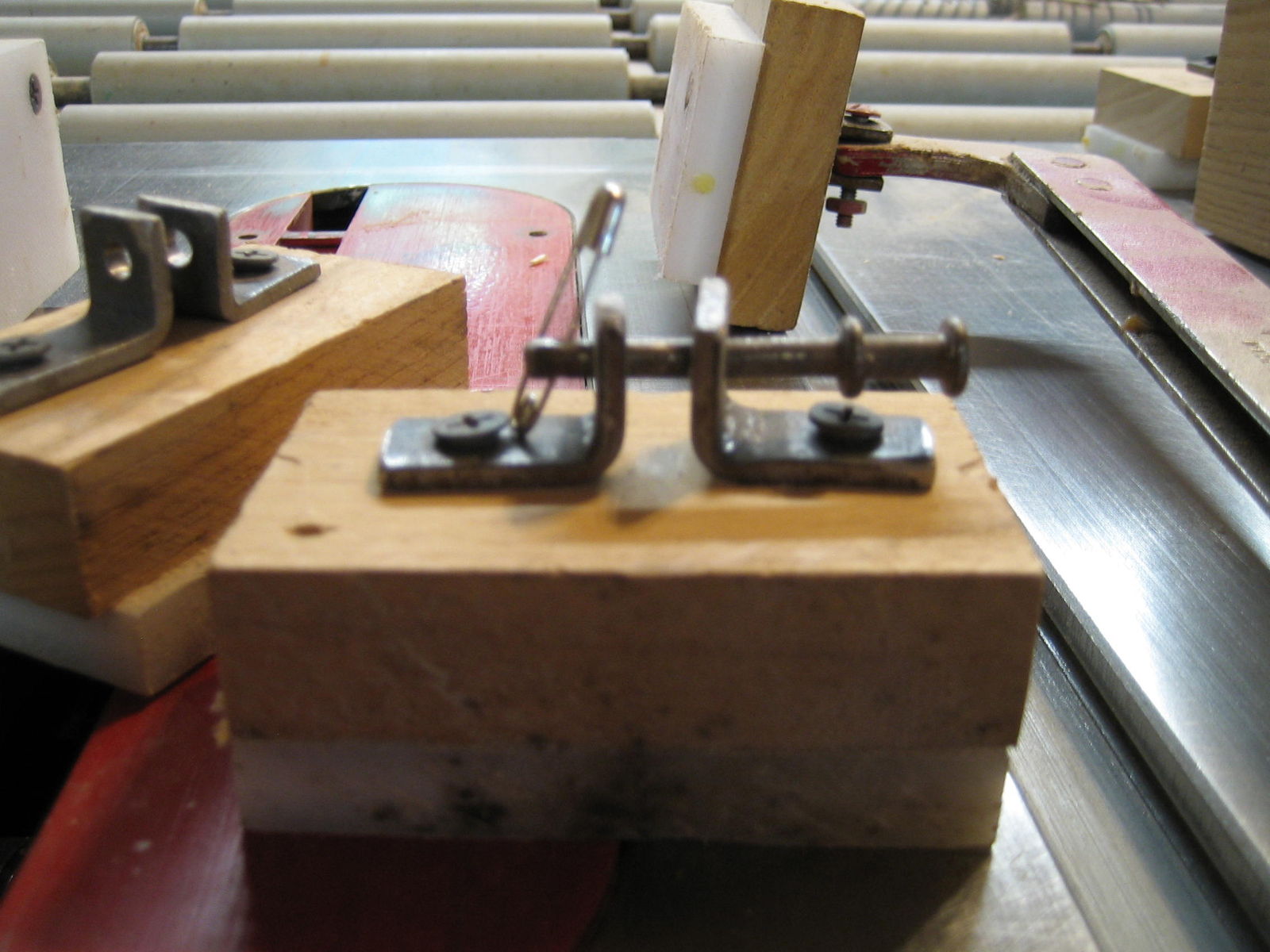

This need very little explanation.
Here's my version.

I did the same thing only used discarded HDPE cutting board material from a friends restaurant. Glue doesn't stick to the plastic.

Gene I bought the strap 3/8" wide x 1/8" thick from Muller Metal building supply and a regular vise and a hammer is all you need.. and the pin is a double headed nail I use in concrete forming.
  The long pads  work good keeping three narrow boards in line and the slickum material came from Walmart. IMG_2122.JPG.e95cd0e673727f6e03e332b0455a985e.JPGIMG_2124.JPG.5b998cd1c9dc9e2cb4421e562c9471a5.JPG
Same here, used Formica scraps on the wooden blanks.  Same result, glue won't stick.

@Gerald Like the idea of no drilling thru the clamp metal ends.
