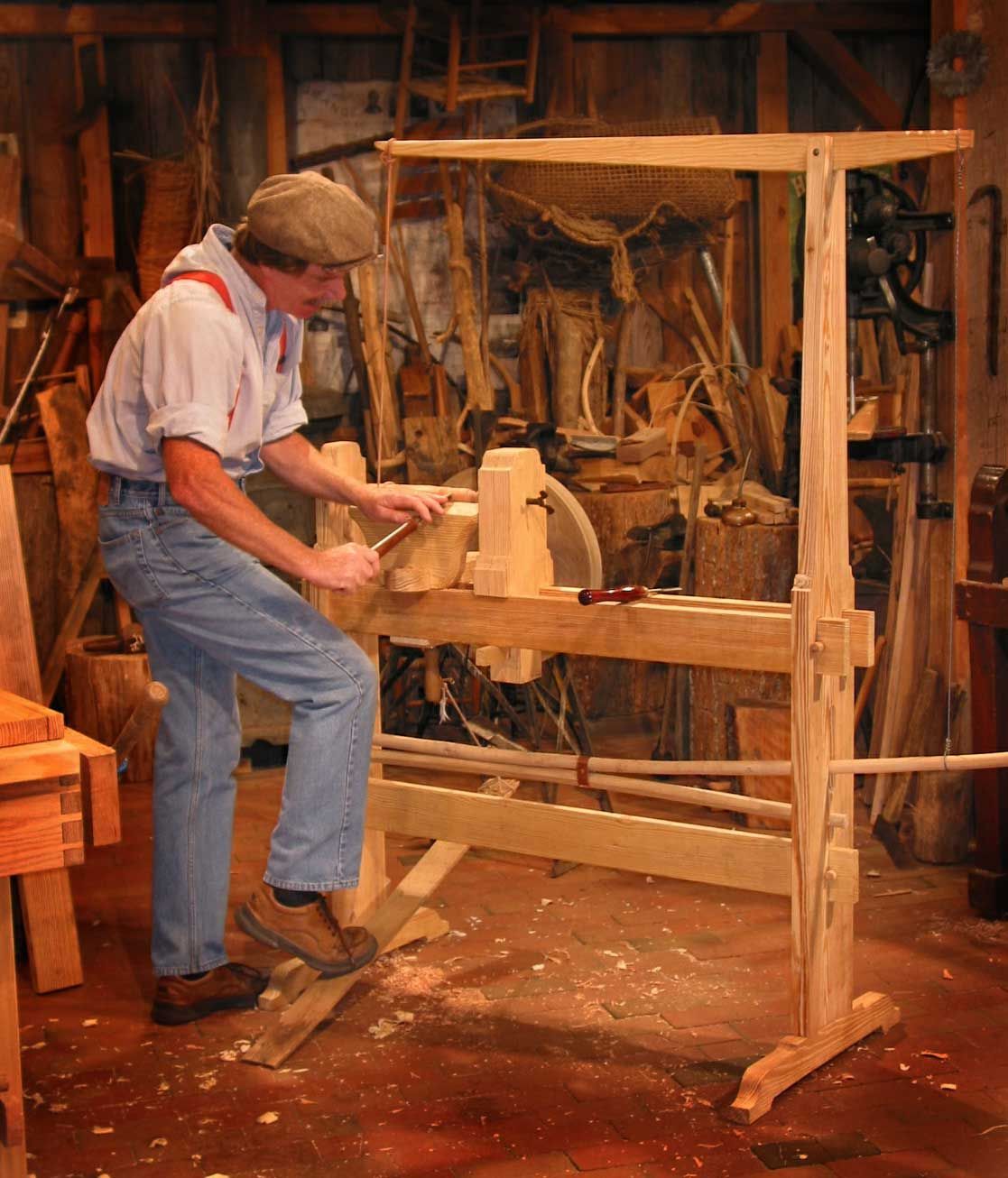

July 1, 20197 yr comment_194812 Or just use one of these Artie and be danged with all the safety gear! Report

July 1, 20197 yr Author comment_194862 15 hours ago, John Morris said: Or just use one of these Artie and be danged with all the safety gear! So I’d probably be out of energy after 2 minutes, what kind of turning can I get done in 2 minutes? Report
July 1, 20197 yr comment_194863 2 minutes ago, Artie said: So I’d probably be out of energy after 2 minutes, what kind of turning can I get done in 2 minutes? One scratch! Report
July 1, 20197 yr comment_194866 1 hour ago, Artie said: what kind of turning can I get done in 2 minutes Turn around and go back in the house and sit down. Report
