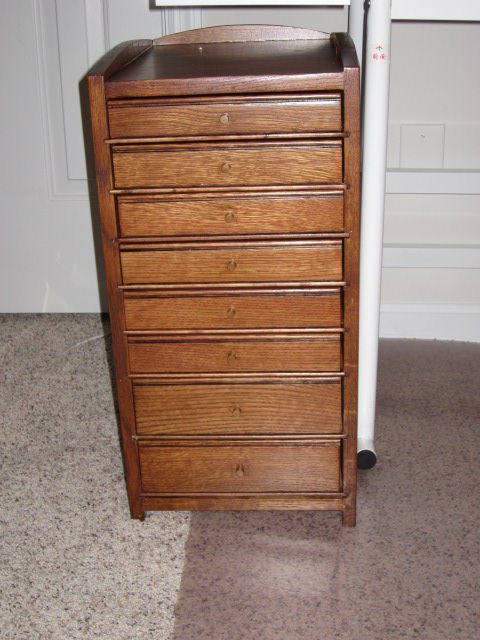

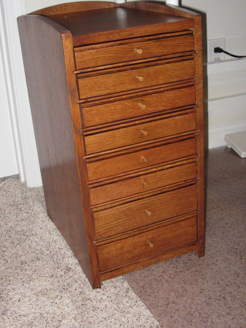

June 24, 20197 yr comment_194324 4 hours ago, Michael Thuman said: I was going to dye the whole peice to hide the lighter colored sap wood on some white oak then use Minwax stain to highlight the grain. Looks like I do not need to dye becuase the stain has dye. So I will make some samples and upload them. 1 with dyed then "stained" Then just "stain". The idea is to pop the grain but I do not know how now. Do you? It really depends on which color Minwax you use. Like I said, some are dye only, some are pigment only, and some are both. Use Flexner's method to determine which. Another method that I frequently use is stain (my term for any of the three varieties above), a coat or two of finish, then a coat of glaze, then another coat or two of finish to lock in the glaze. Here is such a project from white oak. The glaze also highlights the beading. Report
