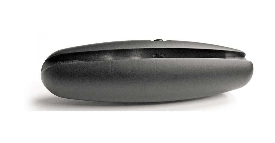

With the Veritas Low Angle Jack you can also put a grip on the side of it to make it easier to handle, you can do this for any plane actually. See link below for an excellent article by LV for making a grip.
And Lie Nielsen has a factory made grip to use for their bench planes, it may fit your 62 as well.
WWW.LIE-NIELSEN.COM
Hot Dog for the Low Angle Jack Plane This powder-coated Aluminum 'Hot Dog' attaches to the side of the No. 62 Low...
