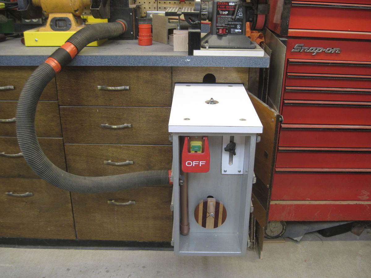

Gunny Posted May 25, 2019 Report Posted May 25, 2019 I have two router tables. One built into my table saw assembly for larger work, the other is a pull out cabinet/ drawer mini router table for smaller work. The cabinet build is about 1/3m of the way back from the front edge. My thinking was as the space is limited I left that larger back open to be able to accommodate larger pieces if needed. For my tablesaw I have a EZ router raiser lift, for the mini I made my own using drawer slides and a lab lift. Took some work but I enjoyed the challenge. If you are looking for ideas the mini router table build is here https://thepatriotwoodworker.com/forums/topic/24091-mini-router-table/?tab=comments#comment-172198 Artie, FlGatorwood, p_toad and 1 other 4 Quote

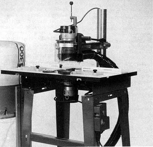

Popular Post Kevin Beitz Posted October 7, 2019 Popular Post Report Posted October 7, 2019 My router table is a little different.... Gunny, Artie, HARO50 and 4 others 5 1 1 Quote
Gunny Posted October 8, 2019 Report Posted October 8, 2019 25 minutes ago, Kevin Beitz said: My router table is a little different.... Well that is a interesting approach. Tell us about it, how you did it, why you decided to use this method. Always interested in a new idea. FlGatorwood, Cal, Artie and 1 other 4 Quote
1fizgig Posted October 8, 2019 Report Posted October 8, 2019 Yes please, that would be interesting! Gunny, Cal, HARO50 and 1 other 4 Quote
Popular Post John Morris Posted October 8, 2019 Popular Post Report Posted October 8, 2019 2 hours ago, Kevin Beitz said: My router table is a little different.... Now that's a horse of a different color! I love it! FlGatorwood, Gunny, HARO50 and 2 others 5 Quote
Popular Post Kevin Beitz Posted October 8, 2019 Popular Post Report Posted October 8, 2019 I found this tool at a surplus liquidator covered with years of dust. The tool was never used. It gas a funny name. "10 Fingers Router". Ten Fingers Corporation Texas. RAMR-S model. John Morris, Gunny, HARO50 and 2 others 4 1 Quote
Gene Howe Posted October 8, 2019 Report Posted October 8, 2019 (edited) Here's what I use. Shopsmith calls it an over arm pin router. The picture is a bit misleading. Although a router can be mounted under the table and used as a router table or, mounted in the arm as a pin router, both at the same time would be problematic. It's a lot of fun to use. Edited October 8, 2019 by Gene Howe John Morris, Artie and HARO50 3 Quote
Kevin Beitz Posted October 8, 2019 Report Posted October 8, 2019 I got one somewhat like that from the junk yard. The only thing that was wrong with it was a 90% gear was broken. So I made one. Gunny, HARO50 and Artie 3 Quote
