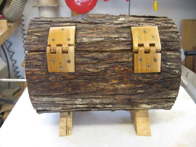

While recuperating his buddies would come to visit and one day one of them brought him a piece of fire wood from the tree. He then later asked me to make him something from the block of wood for a remembrance of the experience.  So here is what I made.

So whats' the diameter of that log, it looks huge on your band saw. But I am thinking that is due to optical disillusion.

it is 14"L X11" diam.  and inside is 11"L X 6"W X 6"D It doesn't weigh that much, it is cedar.
Looks waaaay bigger. Must be my small beady eyes..........
Great job . How did you get the bark to stay on?
When I got the log, it was soaking wet. So I trimmed the ends as square as I could on the bandsaw. Then I slabbed all 4 sides, the water ran out of it when I cut it. This happened in Dec last year, and I set all the parts on the shelf in the shop to dry.
When I started to work on them last Wednesday, the bark shucked off. So I cleaned off all the loose stuff and spread a liberal coat of TB II on and put the bark back on and clamped them down. It seemed to work to hold the bark in place. When I finished them I put a good soaking of water based Poly on the bark to keep it from flaking off,and give it a little sheen.
