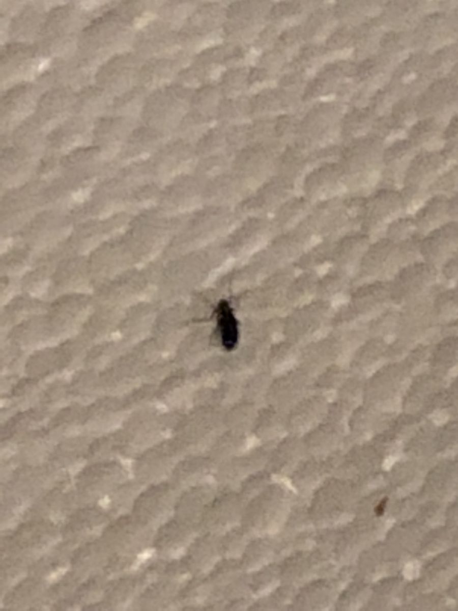

April 24, 20197 yr Author comment_188641 We have a winner and we were all wrong it’s powderpost beetles. The variety that does not care if it’s hard or softwood. Been clearing the shop out the past couple of days and finally found one. Already got the infested wood out and borecare arrives in the morning. Considering all the untreated lumber is in the garage it sucks but it’s a finished garage....not sure that’s going to help but at least I know where to spray now. No signs of them in the house thank god. Report
April 24, 20197 yr Author comment_188642 Here’s a pic of the little guy....*pokes with fire* my bad Report

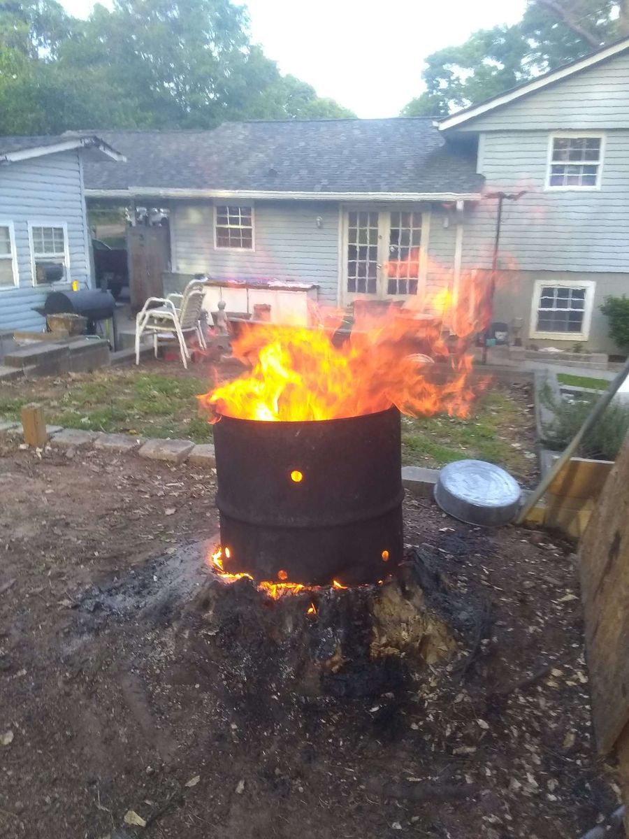

April 24, 20197 yr comment_188646 2 minutes ago, Mijohnson1984 said: I wonder if running two forges would do the trick. Maybe, been burning a stump for a few days myself. Report
April 24, 20197 yr Author Popular Post comment_188647 That’s no easy task wet and dense. *shivers*. And the wife was wondering why I held on too my forges. Because somethings need to die in a firey inferno. Spiders, wood boring insects, my addiction to skittles and dc pepper, my ex. Did I just say that....... Report
April 24, 20197 yr Popular Post comment_188649 Somehow I always seem to be in charge of the fire thingy!! Edited April 24, 20197 yr by Woodbutcherbynight Report
