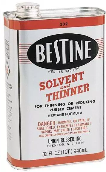

March 12, 20197 yr comment_182136 Does any manufacture package lacquer thinner in plastic ? I have only seen in metal cans. Roly Report
March 12, 20197 yr comment_182141 Just guessing that metal cans are cheaper than containers made with PTFE. Report
March 12, 20197 yr comment_182151 2 hours ago, Roly said: Does any manufacture package lacquer thinner in plastic ? I have only seen in metal cans. Roly not that I know of... Report

March 13, 20197 yr comment_182177 Coors has a beer in a metal can with a screw top. Have a six pack, enjoy an evening and rinse out. Perfect for small jobs. Don't like beer? Share with neighbor. Report

March 13, 20197 yr comment_182259 11 hours ago, Woodbutcherbynight said: Coors has a beer in a metal can with a screw top. Have a six pack, enjoy an evening and rinse out. Perfect for small jobs. Don't like beer? Share with neighbor. Now, if Fosters only had the same can design....ya know, for those bigger jobs. Report
