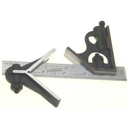

    2. A little more is a tool for lathes to find center on either square or round blanks and mark a line. With this tool you can do some irregular shapes by making several lines across the piece and select a spot in the center of all the marks.image.png.31fe9e4a15aefd51d31078a2ff568fb8.png

Great tips Gerald and something I'll be needing in a while as I need to start doing some turning with my Shopsmith. I've done the X on square/rectangular woods but what about round? Is that a tool in the picture and if so which one?

The center finding tool works for round too. You can get this center finder in many places even Amazon.

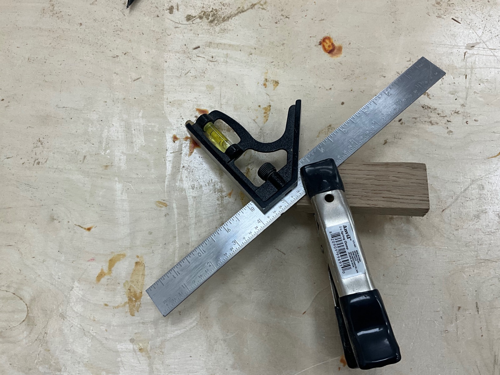

I needed to do some center finding for a turning project tonight and it was getting a bit frustrating.
Enter the jury rigged center finder.
If you have a combination square, a piece of wood with a flat side, a 90* corner and a flat base that you can index on the 45* portion of your combination square, you have a center finder.
Align the flat against the 45* side of the combo square even with the inside edge of the ruler where it intersects the 45* slope and clamp it in place.
It probably isn’t quite as user friendly as the one @Gerald posted, but it works well in a pinch.
Some are combination squares are sold with center finders.  Maybe you could make one for yours.
