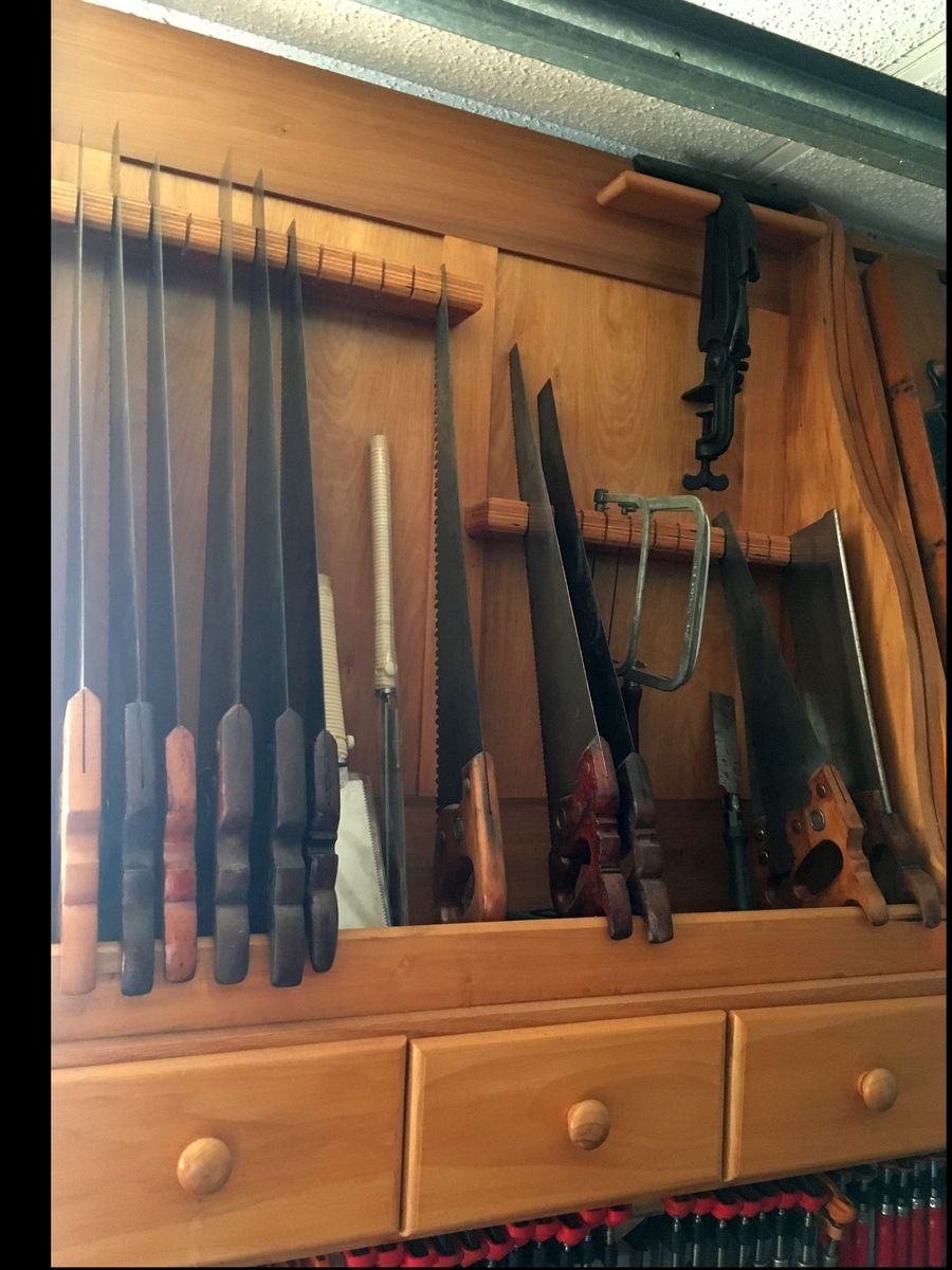

He are some of the saws that I have. These are my "daily users". They are an eclectic bunch; Distons, Atkins, Warranted Superiors, and a couple I can't ID. All of them refurbs. All with straight plates, refinished handles and etchs preserved when possible. I, also, joint, sharpen and set my own saws. You can see my Diston saw vise in the upper right on the till.

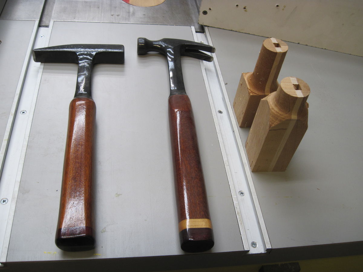

These are his old hammers I made new handles for few years back.  Metal shank was stamped 1953.  Made a channel inside the blank then glued up and turned down. The blanks are from another project, just using them here to show what I did.   Oval shaped the handles on the lathe then did the rest by hand to match up the tops.  They have a nice heft and feel, worked at it to get them balanced.  No, they do not get used.  :Laughing:

...and you did 'em proud...very nice.

Nice job on the hammers.  :)
Thanks!!
