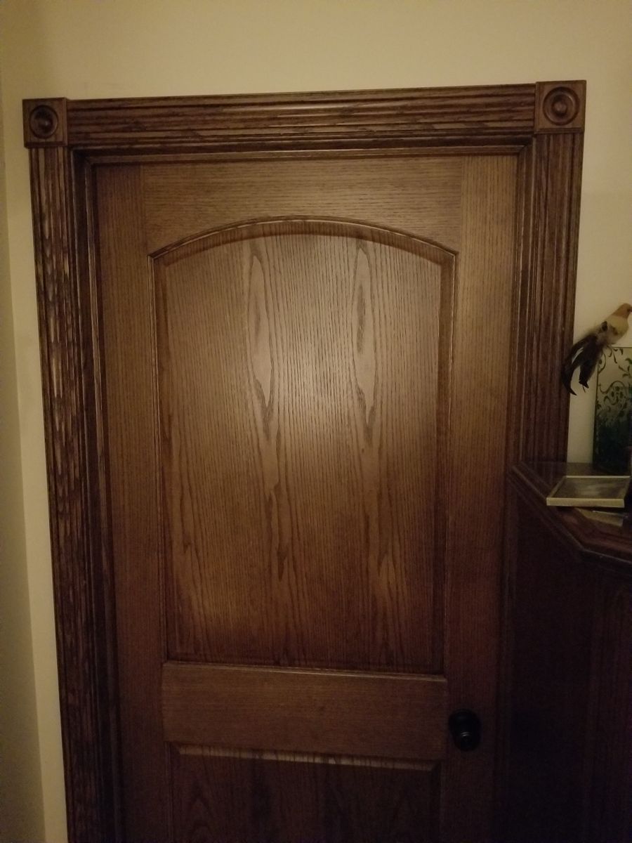

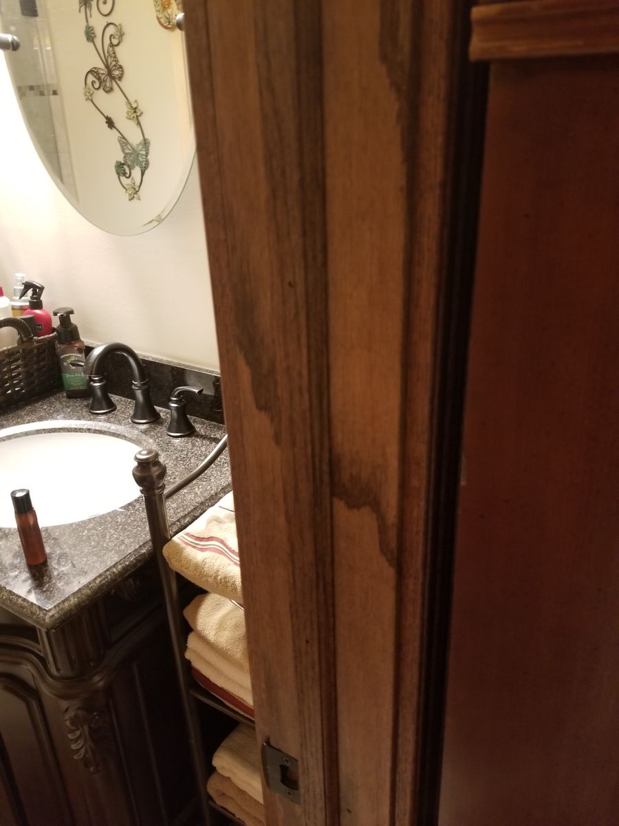

February 12, 20197 yr Author comment_178188 18 hours ago, kmealy said: I am wary of just adding water to a w/b finish. It's a delicate balance of a dozen or so components and may not act right. It's not so much a problem with oil based -- add as much linseed oil or mineral spirits as you want. Beading, craters, and circles on the finish is often a sign of silicone oil contamination -- generally due to Pledge, but also from a can of silicone oil directly or indirectly. A coat of shellac sprayed on will seal that evil stuff in. This was bare wood that was stained with oil based stain. When I stripped it all again by sanding back down to raw wood and re stained it then used full strength poly no craters or divots were apparent. I think before it was the water getting pushed out ot the finish. I am all good now a small brush with overlaping strokes and barely wet just enough to coat the surface. Between coats 400 and now a brown paper bag to even it out. It looks fine and I am very happy with the outcome. Report

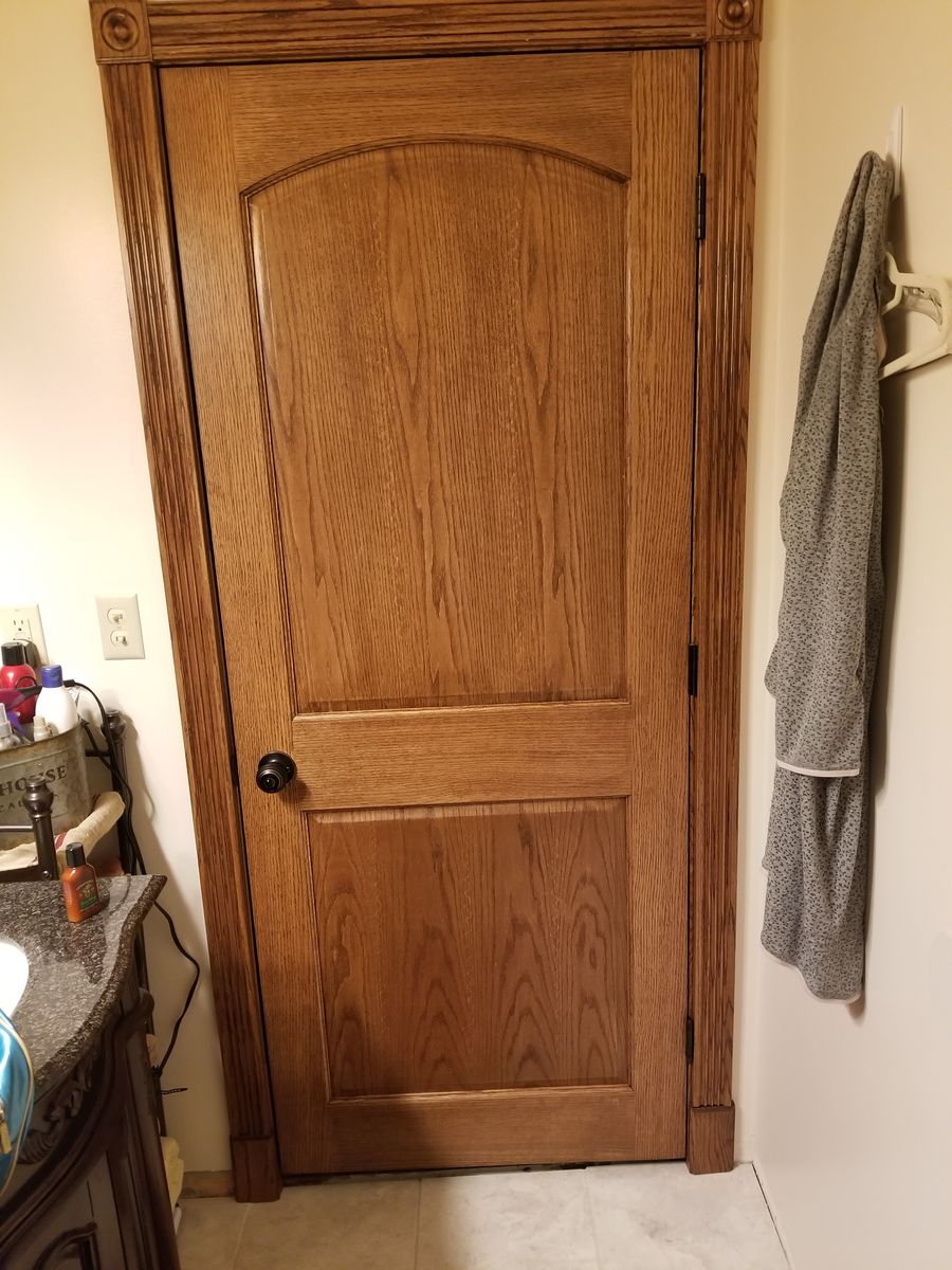

February 19, 20197 yr Author comment_179079 19 hours ago, Dadio said: That may be the reason,water and oil don't mix,they say, that is why I always seal with shellac. The only time I don't is when I finish a piece of raw wood and don't want the yellowing of the shellac, I will seal with the WB poly. it will raise the grain like crazy, but after it is sanded the next coats go on as smooth as can be. I am glad you solved your problem, keep doing what you are doing if it is working good for you. The only suggestion I have is in the future try it out on a scrap piece before you put it on the furniture, it will save a lot of sanding, and you can throw the scrap away, and try another. Herb Thanks pictures are comming tonight. Report
February 21, 20197 yr Author comment_179288 On 2/19/2019 at 7:47 AM, Michael Thuman said: Thanks pictures are comming tonight. Report
