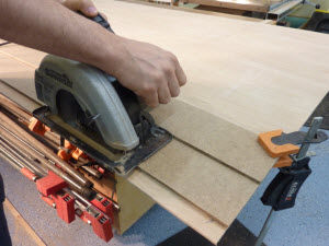

This is what I use Michael, you can make your own to fit your saw and the exact blade you are using. You'll have a nice clean edge.
I have several for my routers too, zero clearance, and set the straight edge at the measured line.

This looks good if you are cutting the OSB top on the table.  But then how do you clamp your fixtrue to the table to all the saw to pass?
