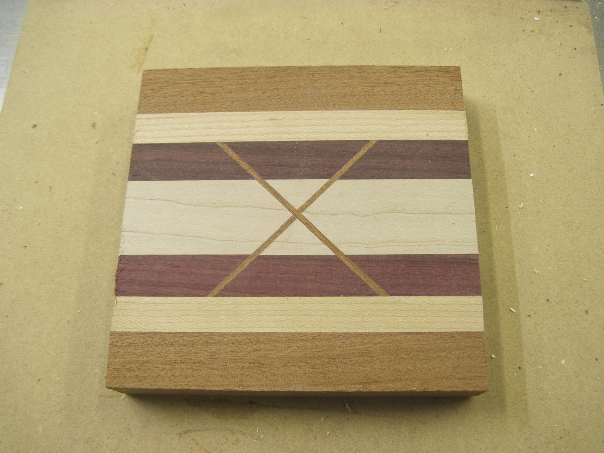

Gunny Posted January 1, 2019 Report Posted January 1, 2019 In making my lift for the router I need a wheel that turns a small Lab scissor lift. How would I manufacture a wheel say like the Delta one pictured or something with some holes in it? Tools available are a lathe, bandsaw okay just about any tool but the skillset may be lacking with the lathe. FlGatorwood 1 Quote

Gunny Posted January 1, 2019 Author Report Posted January 1, 2019 2 minutes ago, Stick486 said: or make your own... That is what I am thinking. Already made the wheel as shown out of some plywood with the circle cutting jig on the BS. Recessed the back to accept the 5 stared knob. This was proof of concept, I used plywood. FlGatorwood 1 Quote
Gunny Posted January 1, 2019 Author Report Posted January 1, 2019 2 minutes ago, Stick486 said: http://woodarchivist.com/2673-diy-handwheels/ Made that kind before. Only issue here is the lab lift has reverse threaded metric bolt, of which I have none in supply or sourced. So I am stuck with making a wheel I can adapt to the 5 star knob it has. Was thinking more like a wagon wheel look. FlGatorwood 1 Quote

Popular Post Gunny Posted January 5, 2019 Author Popular Post Report Posted January 5, 2019 Crank wheel now turned. Have to get the suicide handle turned next. For anyone interested a 7mm pen blank brass insert can be used to turn a handle of smaller size and gives you a nice brass surface inside to wear instead of wood against a steel 1/4 bolt. Cal, FlGatorwood, hawkeye10 and 2 others 5 Quote
