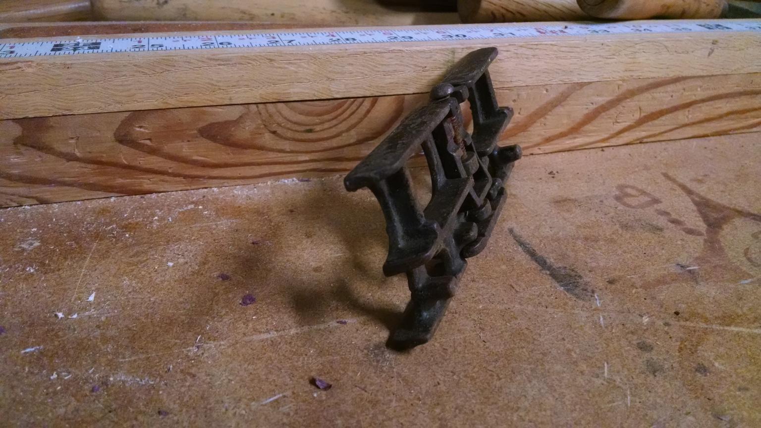

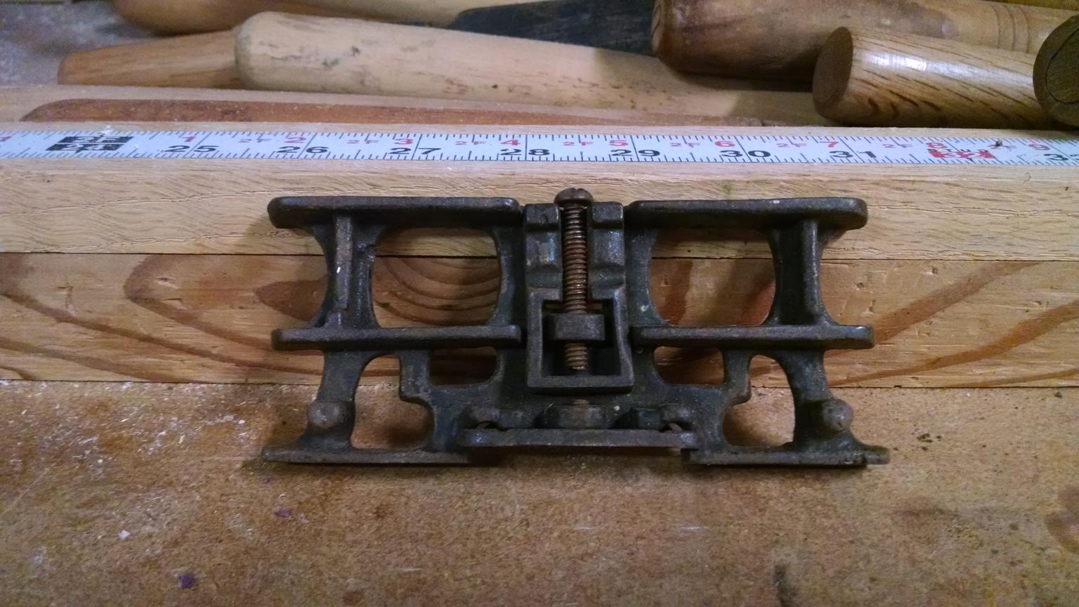

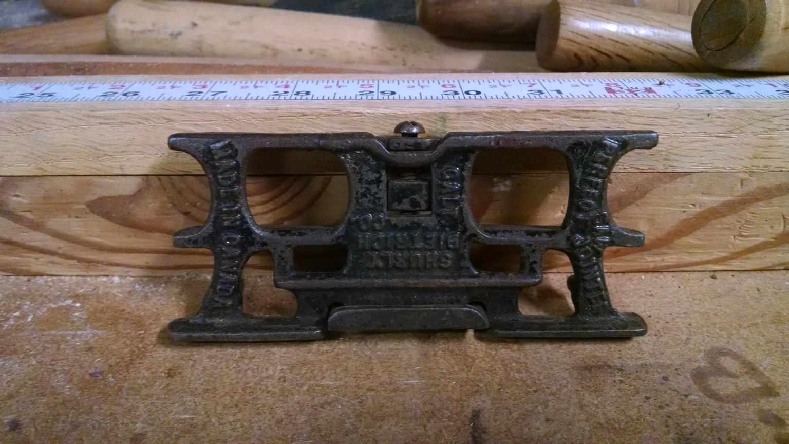

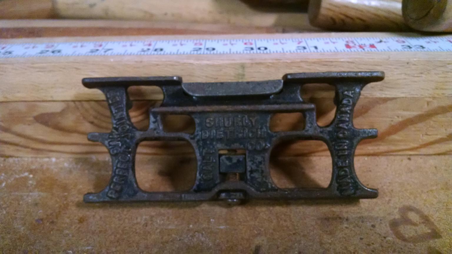

What does this tool do? I found this in a collection of tools I have that was given to me. Any help is greatly appreciated.
Posted (edited)

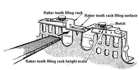

Missing a file, but a flat file is inserted/held in place then run across the top of hand saw teeth to joint for a consistent height before sharpening.

See page 71 of the catalog...new it was $3/doz...since yours is used I'll give you $0.25 for it.:ROFL:

Well all be gosh danged, thanks Gramps! I actually have four four of them!
So I have this saw jointer, I have a tooth set, I do have files, guess I'm ready to delve into the art of saw setting and sharpening!
