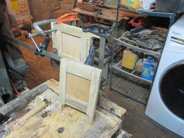

End panel was checked for square....and found wanting...we have ways...
Small part, meet small plane.  Got that job done....set the front and back "Sammich" into the vise...for the same thing..
Yes, both panels are in there...weapon of choice?
Actually, both planes were used....and the beltsander...and a small drum sander I could install in a drill...got things to finally match each other, set aside one, and worked on the other, as it needed grooves done..

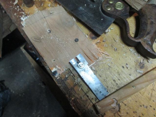

Retract the spurs...don't need them, nor the depth stop..
Remember that  cutter I sharpened up?    It also has it's own depth stop.   hardest part about this?  getting it mill to the tongue exactly where you need it...dang fussy.:BangingHead:.clamped the panel where I could do the milling..
And, where it won't move around...first try...meh...more fussing, more cussing..wound up with a skinny tongue..:PullingHair:
Will fine tune it later...flipped the panel...a few times, didn't matter, plane wanted to dig in regardless of the grain directions...finally  got it to a dry fit..

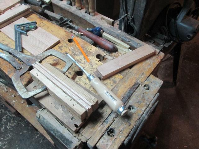

Ok, tongues were done for today, end panel needed the groove finish out...
At least, I could use the backsaw all the way through...and then pop the waste with a chisel...Wall on the edge is a bit ragged,  tablesaw will clean it up.

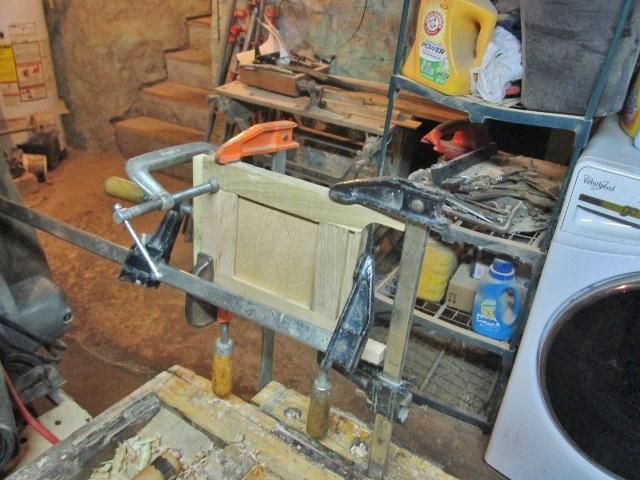

Placed this in-between the other two sides...with one clamp..
And that spreader bar.   Waiting on glue to cure, before i tackle the last panels....hopefully, the tongues come out better.   Cutter was designed for 3/4" thick stock...this stuff is a little thinner...should have used the 3/16" cutter, instead....oh well.
