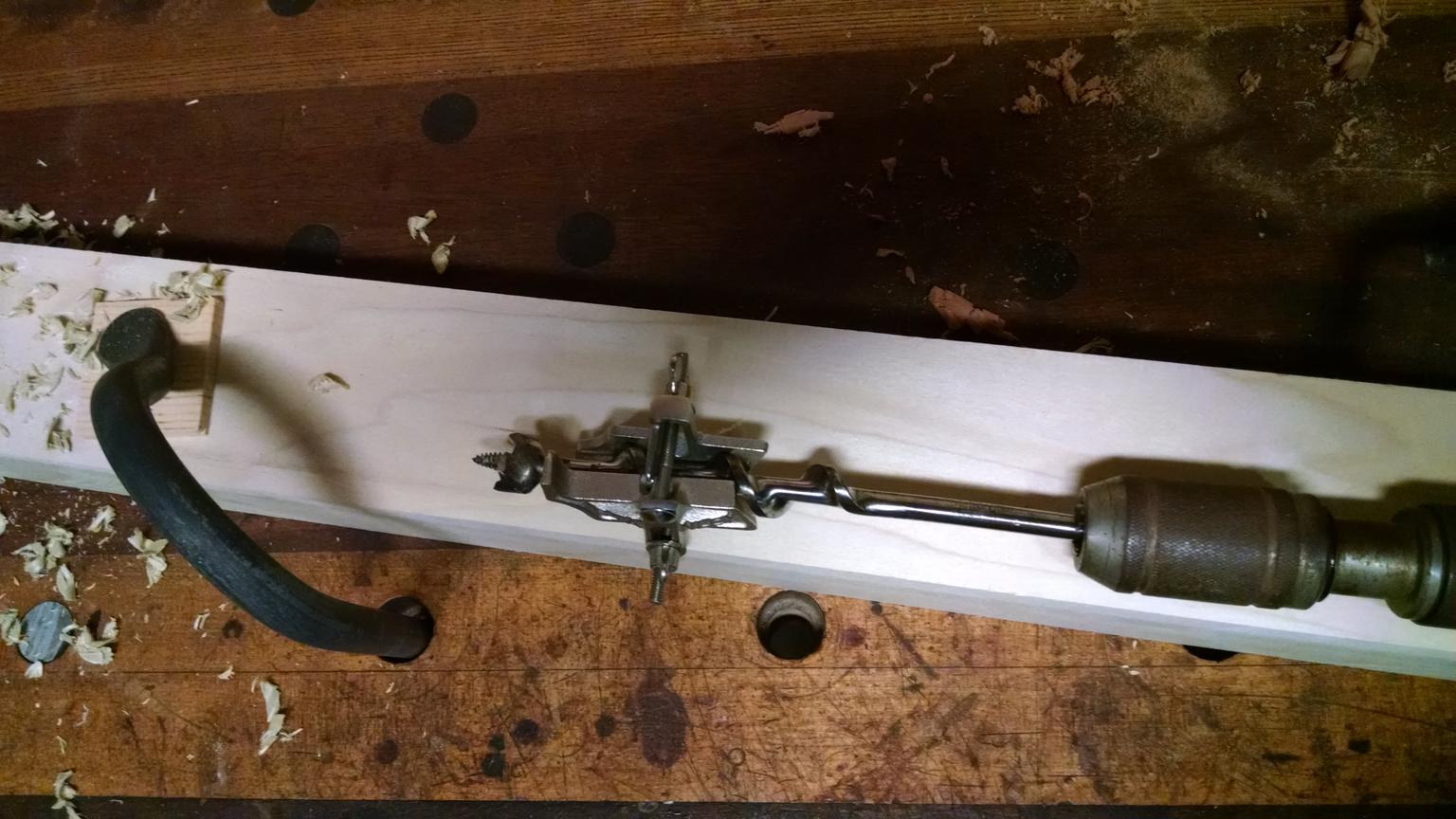

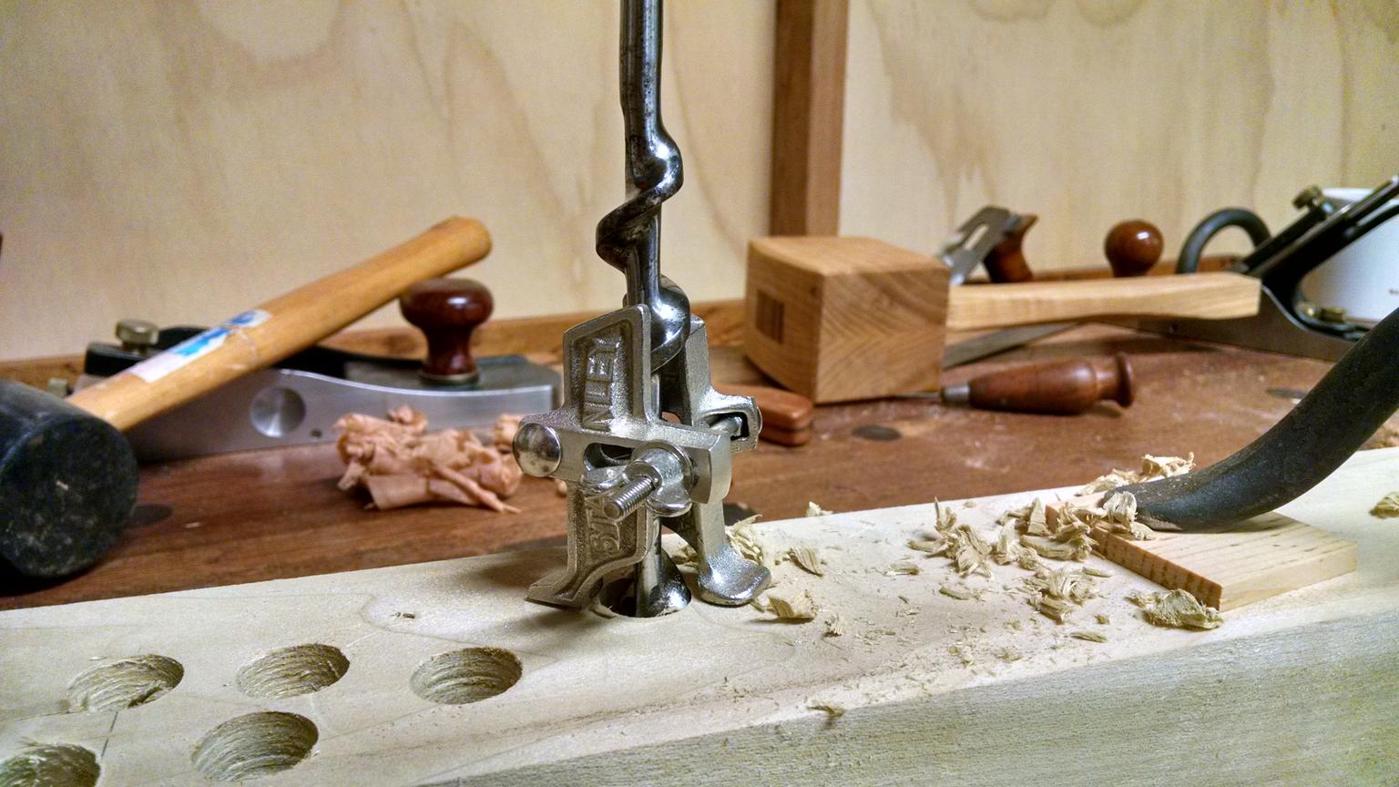

October 13, 20188 yr Author Popular Post comment_162495 Here ya go @Gerald. Got home from work a little while ago, found this in the garage. Tightened it up around my bit, gave it a whirl, and I love it! Report
October 13, 20188 yr comment_162497 Gee and all this time I been using a piece of blue tape, sure been missing out. Can that be set on angles? Herb Report
October 13, 20188 yr Author comment_162498 5 minutes ago, Dadio said: Gee and all this time I been using a piece of blue tape, sure been missing out. Can that be set on angles? Herb No Herb, straight holes only. I guess you could fudge it if you were careful on angles, but you'd have to drill an angled hole first, then set the gauge while the auger is in the hole, and watch the tips hit the surface as you drill, but it is most definitely designed for straight holes. Report
October 13, 20188 yr comment_162502 37 minutes ago, John Morris said: No Herb, straight holes only. I guess you could fudge it if you were careful on angles, but you'd have to drill an angled hole first, then set the gauge while the auger is in the hole, and watch the tips hit the surface as you drill, but it is most definitely designed for straight holes. So when you drill the holes in your chair seats on a compound angle ,how do you do it? Herb Report
October 13, 20188 yr Author Popular Post comment_162503 5 minutes ago, Dadio said: So when you drill the holes in your chair seats on a compound angle ,how do you do it? Herb No depth gauge, I have an angle gauge that I can set my T-bevel too, then set my T-bevel behind my auger and sight the edge of the auger to my T-bevel. But for my shaker chairs Herb, there are no angled holes, all holes are drilled at a 90, they only appear angled because the spindle whether it be leg spindles, or back leg to arm rest spindles, the holes are simply drilled at different locations around the circumference of the spindles, giving the appearance of angles holes. I am going to build Windsors first chance I get, that will require angled holes such as the seat back spindles at the rear chair seat that you are referring too. Fun!!! Report

December 29, 20232 yr comment_326743 Does anyone know if these Stanley auger bit stops work on modern Irwin ship auger bits? And if can they be used with a gas powered drill or can they only be used with a brace? Report
December 29, 20232 yr comment_326765 I think those clamp to the center shaft on the auger; the ship augers I have don't have that center shaft. I'm guessing they wouldn't work though it probably would be too hard to cobble something together that does the same thing. Report
December 29, 20232 yr comment_326793 12 hours ago, Melissa said: Does anyone know if these Stanley auger bit stops work on modern Irwin ship auger bits? And if can they be used with a gas powered drill or can they only be used with a brace? First, welcome to The Patriot Woodworker Melissa. Glad you found us. Hope you share some of your projects with us. We love pictures. Not having one of these stops, I can't answer specifically if it will work on Irwin ship auger bits but I suspect not. That said, I'd have reservations anyway using one with a gas powered drill versus a hand brace simply because of speed and torque of a powered tool. Like @Fred W. Hargis Jrmentioned, you might be able to fabricate something that might work. If you have a machine/ fabrication shop in your area, I'd guess they might see making one as a challenge. Report
December 29, 20232 yr Author Popular Post comment_326813 17 hours ago, Melissa said: Does anyone know if these Stanley auger bit stops work on modern Irwin ship auger bits? And if can they be used with a gas powered drill or can they only be used with a brace? Melissa, I just went out to my shop to take a closer look at the depth stop, it's been awhile since I used it, I would say for sure it's not made for anything powered by gas or electricity, it's purely a hand tool apparatus. As far as it fitting onto a modern Irwin Auger, I couldn't definitely say no, I think you'd have to just find one and get it, and see if it works, and if it doesn't, perhaps you have another use for it if you do other woodworking with standard wood boring bits. Sorry I couldn't be more help, and welcome to our community! Report
January 2, 20242 yr Popular Post comment_327078 for this type of auger i would recommend clamping style locking collars... this will give you enough to lock reasonably around the auger. Report
