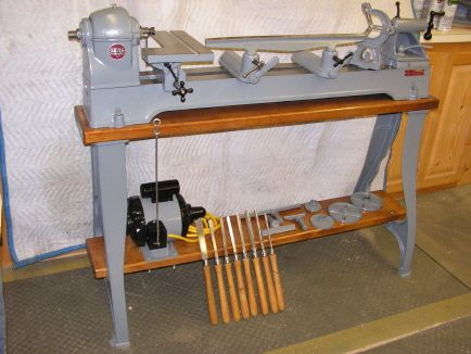

ad a picture
I sure love that look, I hope you get it Don, hopefully @Larry Buskirk will re-appear, this would be right up his alley as far as helping with the restore advice and knowledge base. But too me, looks like a fair price, and a really cool lookin machine.

If you get or make a sanding disc to fit the spindle the lathe becomes a disc sander.  This picture shows it up at the head stock and gives you a better visual on it.  Imagine a sanding disc mounted on the spindle or the grind stone that was mounted on it in the picture for that matter.  He may have used it to sharpen his tools.
Glad you got the lathe Don. I didn't see the pictures but looking at what Steve & Dan posted, get an idea.

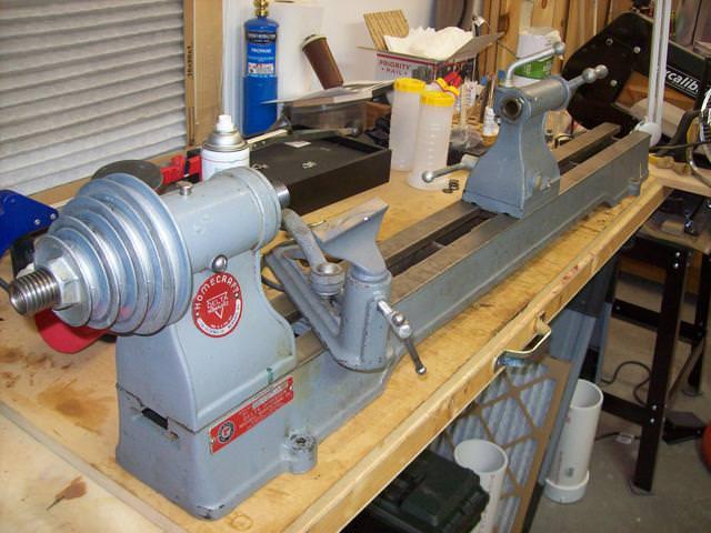

Hey, Dave here is a picture of my lathe. I have been working on setting it up but not full time. It will not be long I hope.
Thanks Don.
Ya' did good...that is one very nice lathe considering it's age. Obviously it had been well cared for and seen limited use during it's lifetime.
Looking forward to seeing your projects.
