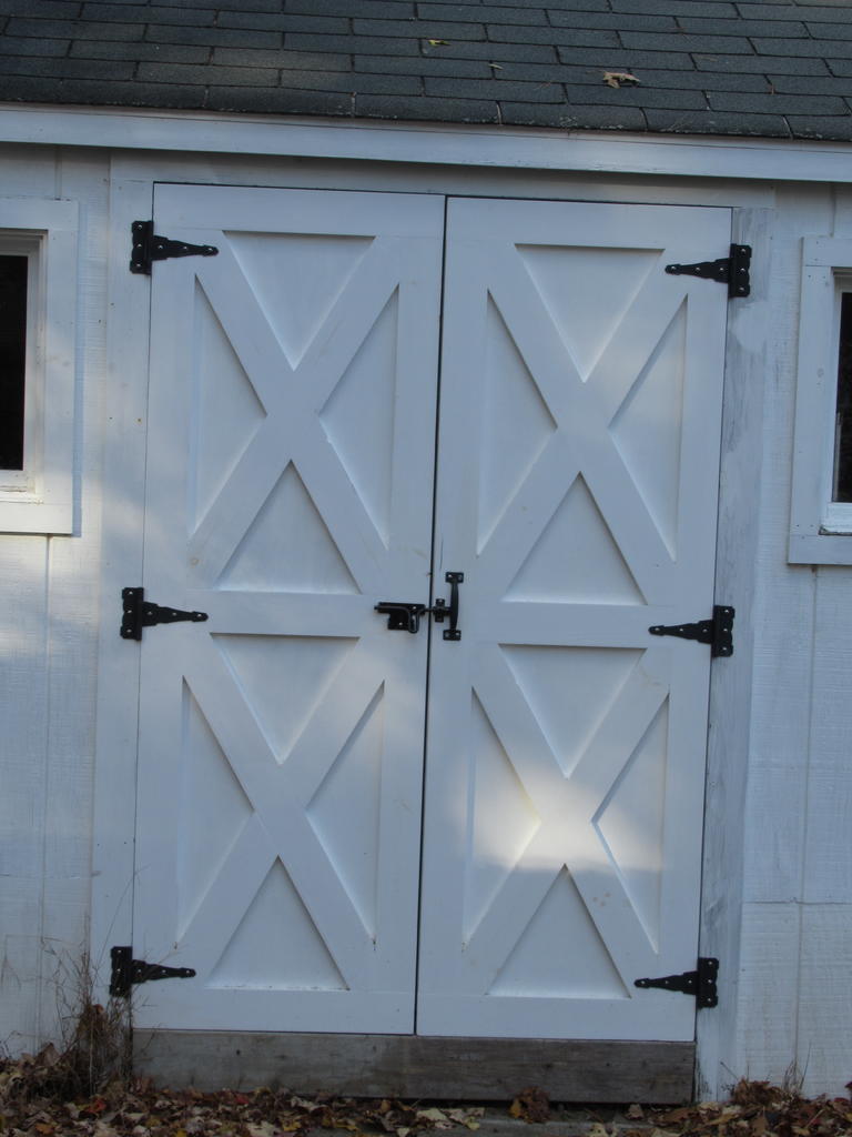

September 18, 20188 yr comment_160238 hingesMy utility building doors need to be replaced and I'm looking for recommendations for what wood to use. The original doors were made of 1/2" ply with pine boards for trim. I'm experiencing some rotting in the ply at the bottom of the doors. Should I use 1/2" pressure treated ply or something else. Also having some issues with the pine trim where the door hinges attach. some of the hinges constantly work loose where they attach to the doors. OK on the building side of the hinges. I'm planning to use 1 1/4" screws to attach the trim to the ply. Here's a photo of the existing doors. Report

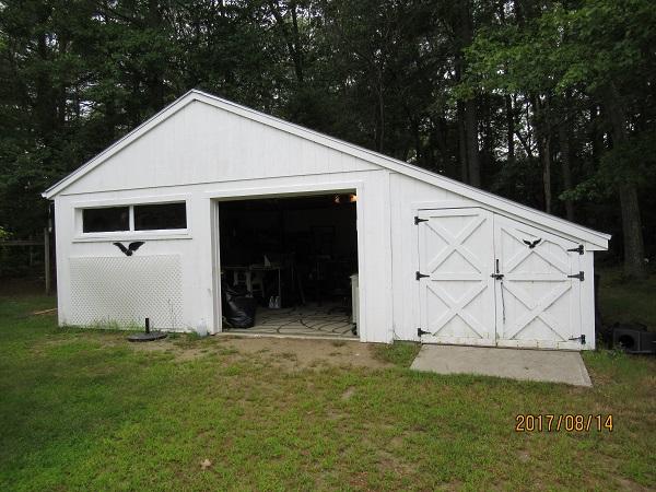

September 20, 20188 yr Author comment_160431 It's a small 8' x 12' utility building, used for storing yard hand tools, fertilizers, bird seed, etc, and to store deck furniture during the winter months. Here's a photo of my shop and storage area for my tractor, snow blower,pressure washer, chipper shredder etc Report

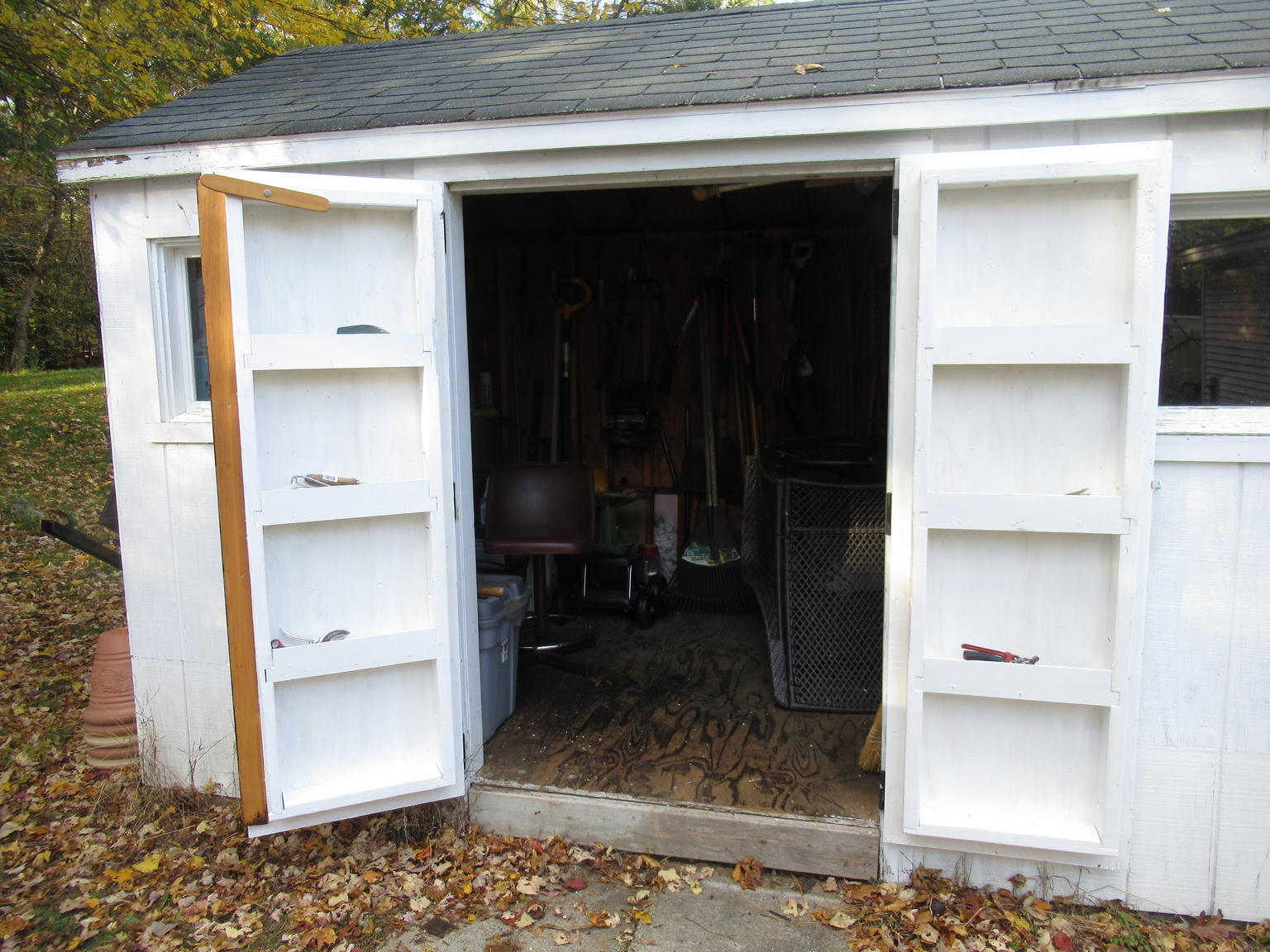

October 26, 20188 yr Author Popular Post comment_164129 The new doors are built and installed. I added a few shelves to store small garden tools, hose nozzles,washers and attachment fittings. Report
