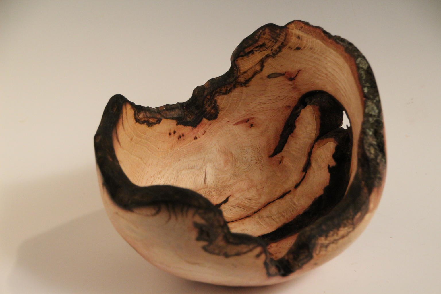

August 29, 20188 yr Popular Post comment_158263 This is a piece I picked up when I cut some limbs for a neighbor. I left this a lot thicker than I usually do but in turning there were two long bark inclusions across the tenon. I turned to finish and when it dried there was in some areas a rippled effect that live oak gets when turned this way, but much more pronounced. I left one side high and one of the club members suggested I should cut the high side down. So I carved it down and burned the edges to match the natural edge. Started to finish with Mahoney's Walnut Oil and did not like the look so added about 10 coats of thinned Tung Oil. Unfortunately I could not buff it , just too many little edges. Report
August 29, 20188 yr comment_158264 Looks fantastic! I would have never guessed about the burned edges, you blended it perfectly! Report
August 29, 20188 yr comment_158266 That's one sweet bowl. Love the grain of that live oak. Great job matching the live edges. Report
August 29, 20188 yr comment_158274 Wonderfully turned. Glad to see you stopped before it exploded like some of us do. Looks great. Dan Report
