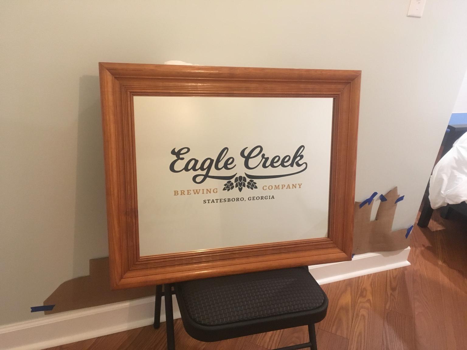

July 16, 20188 yr comment_154286 Thanks Keith. Using the earlier info that you posted I went after the old picture frame yesterday. I was quite (happily) surprised at how well it cleaned up. A few minor dings and scratches really kinda sorta disappeared. I plan to do a second coat of wax today and then mount the mirror and call it done. Will post up a pic after that. Report
July 17, 20188 yr comment_154366 A big thanks to @kmealy for posting this info and these articles up! A few days ago I completed a mirror for a friend. The mirror and frame I think must have come from a yard sale several years ago because it has been in the garage coated with dust and debris for a long time. Anyhow, I was ready to simply toss the frame and make one from pallet material when Keith posted this up. So, I decided to give it a go. I gave it a good scrubbing with soap & water and applied two coats of wax. Not the same as a newly made frame, better than a pallet based frame that I was going to do. Unfortunately, I did not take any "before" pics. I think it will be A-OK hanging in a relatively dark room!!! Report
July 17, 20188 yr Author comment_154374 Looks good to me. If anyone complains, it's "patina" and you pay extra for that. Report
