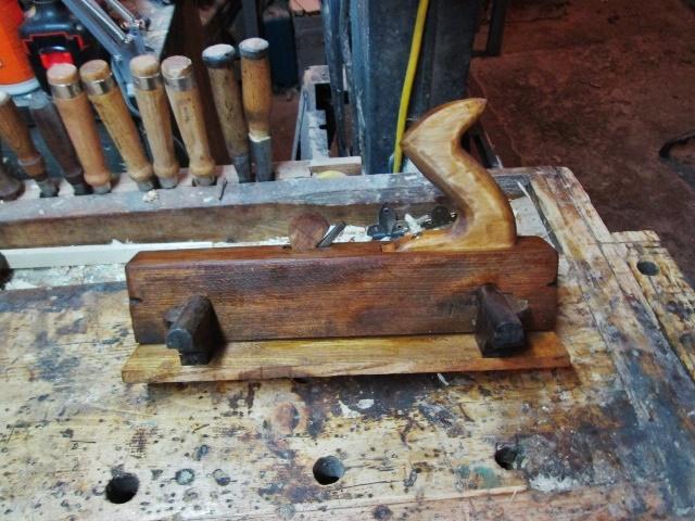

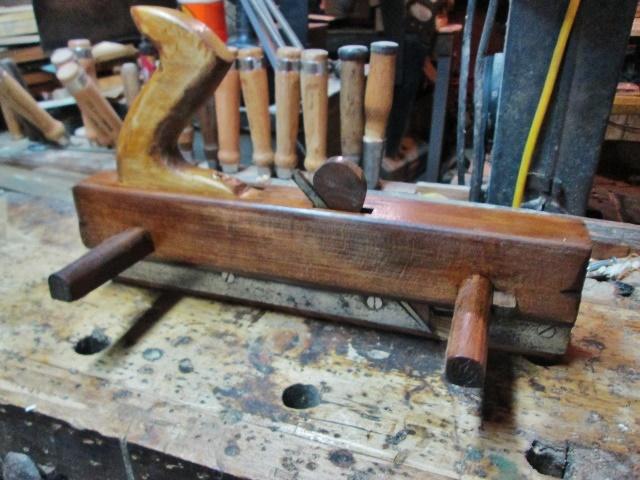

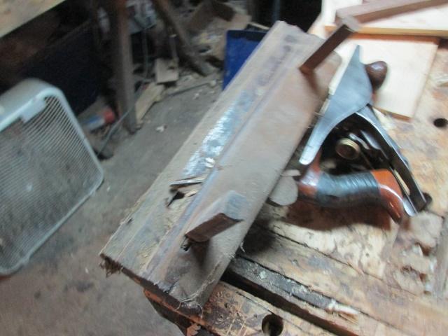

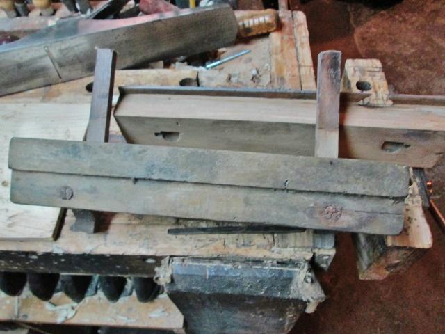

April 19, 20188 yr Popular Post comment_147001 As part of the Dungeon Clean-up this year....the old plough plane was rehabbed back to life.....found broken, and discarded....new parts were made. New, better wedges were made. Cutter sharpened up. New, Maple handle was made. Skate was cleaned of rust. A new fence, made out of Ash to replace the broken Beech one. New wedges are Walnut. There is a screw to help secure the handle in place, as the old dovetail socket was worn away. Glued the handle in place, then added the #10 screw. Two other #10 screws to attach the fence to it's arms. Had to repair one arm...old screw had split the "boss" where it attaches to the arm. Wards #78 plane to make the rebate. Wedge to hold the cutter was beveled to allow the cutter to reach full depth of cut. It also deflecks the shavings out the right side of the plane. As there is no place for the shavings to go on this side.. far cry from what was dug out of the "trash"... Even the sole of the plane needed worked on....was worn crooked... As found.....iron plane is a Stanley #4. Plough plane does look a bit better, now.... Report

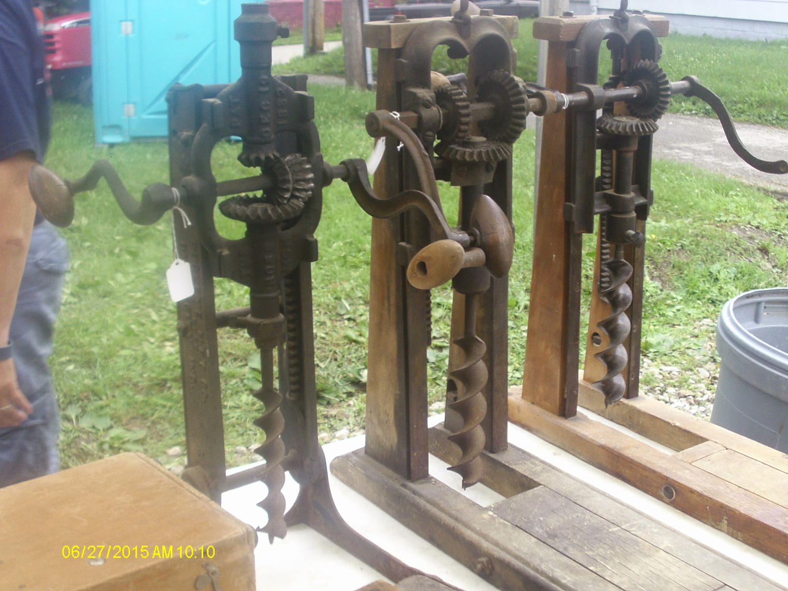

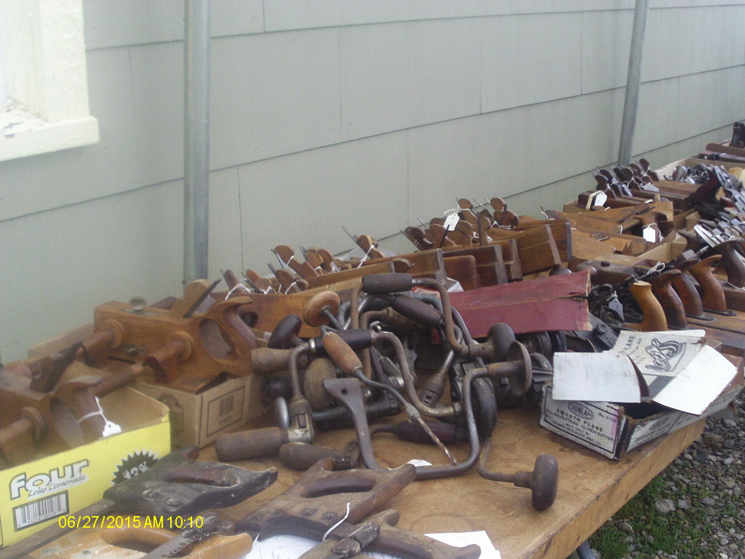

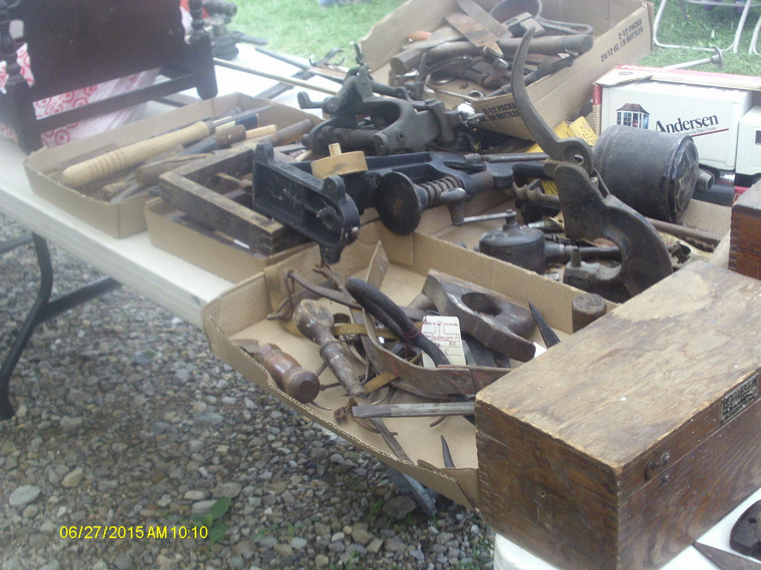

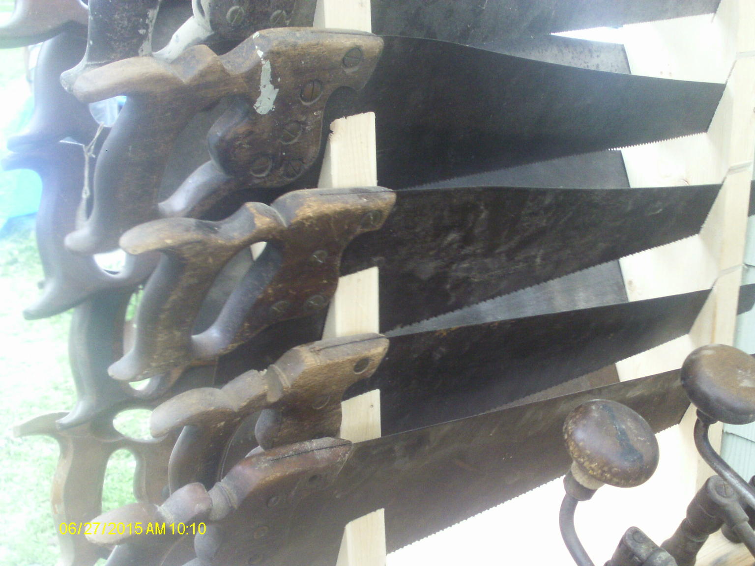

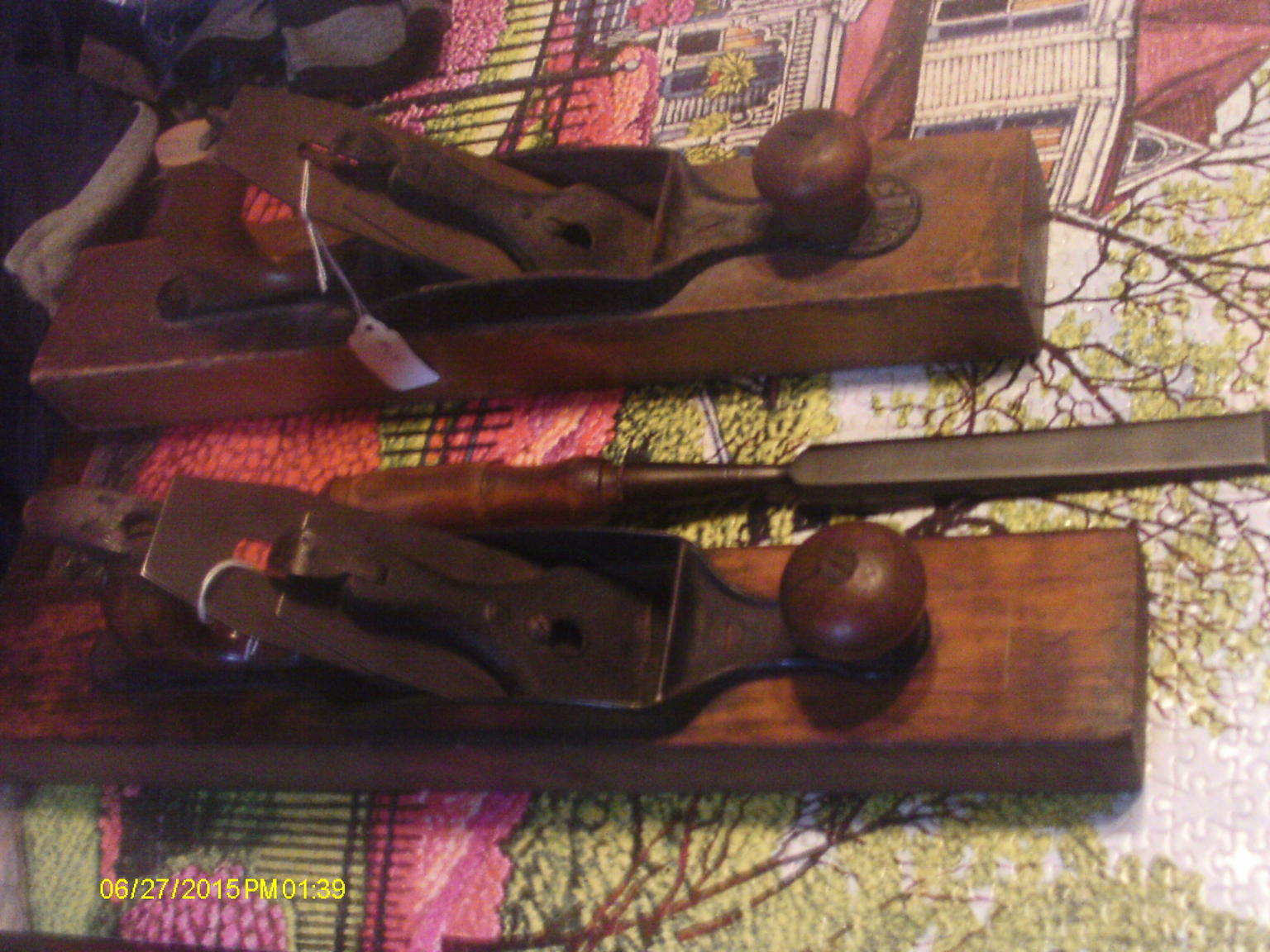

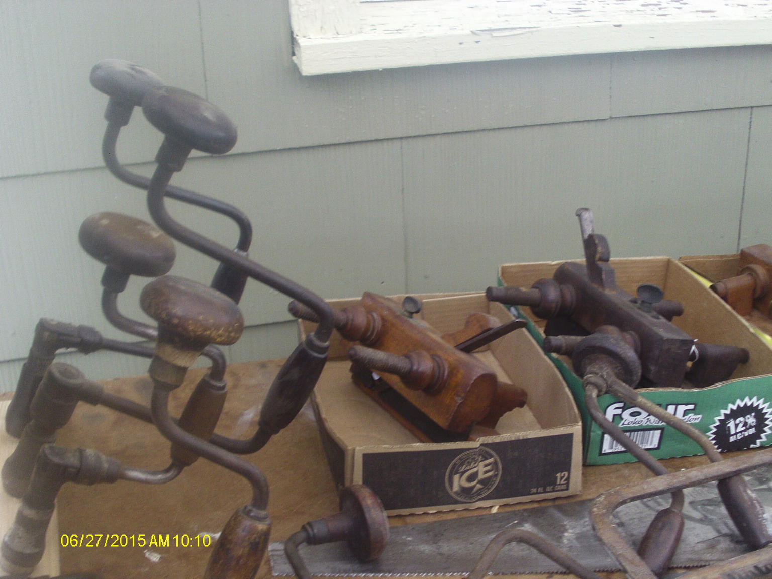

April 20, 20188 yr Author comment_147056 Was at an auction a few years ago.... The only thing I could afford out of this pile... A Stanley #28 and #29...$5.......there was two rows of tables... And.. These went for about $35...each... Double sided saw til...sold as a set, or by the piece..never found out....Detail on the fancy planes... Mainly Moving Filister style of planes...Would have been very easy to spend a $100 or three that day...Only had $10 in my pocket..Bummer. Report

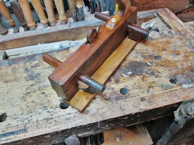

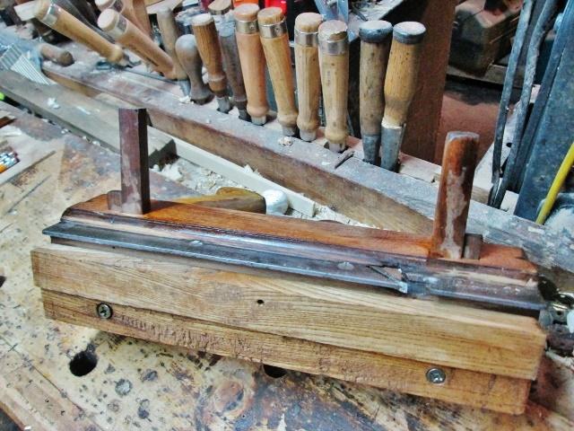

October 27, 20188 yr Author Popular Post comment_164174 Ok...a little more info on this old plane. It also was getting used, today, BTW.. There is a bunch of letters stamped into the nose of the plane.. CIN. O. (Cincinnati OH?) ROSEBOOM ( G. F> Roseboom was a plane maker in Cinci, back about 1840 to 1850s....from the way the screws looked, the OEM ones, this plane would be about 1844...) Plane needs a lot of candle wax, to slide smoothly....Left hand goes over the top of the plane, thumb on the fence side....and it doesn't like going against the grain...and will tell you instantly when you do. Somewhere out there, there is a "match" for this plane....that makes the "tongue" to match up with the groove. Plane cost me $16 when I bought it. Report
