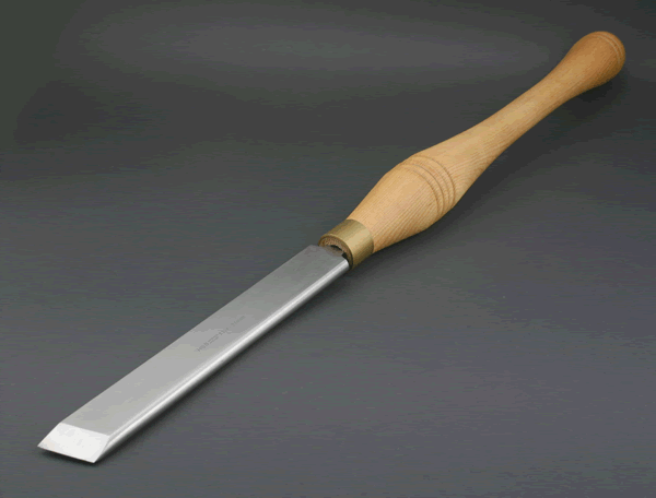

April 12, 20188 yr comment_146420 I watched the video on proper use of the skew chisel (lew posted) and noticed how he had his sharpened with a slight curve, rather than a straight edge. I haven't see the curve before and it looks like a better way. I don't use the skew much, when I first started I ruined things, didn't know how to properly use it. Is your skew edge curved? Report
April 12, 20188 yr comment_146428 When I first started turning I had a set of Craftsman wood turning tools and taught myself to turn wood using these tools. I have since bought many more tools of different brands but still these Craftsman tools are my most used tools because they are so familiar to me. I feel that all the tools are good and there are many variations to each tool but the best tool is the one you are most familiar with. If you buy a new tool you will hate it when you first use it but truth is that practice makes perfect. You can learn to love any tool as long as you take the time to familiarize yourself to it. My favorite skew is one that is straight across the end. Report
April 12, 20188 yr comment_146444 I use a skew pretty much daily and I prefer a straight angle. Actually, I shouldn't say that because I've never used the curved type. It just seemed to me it would make the tool more difficult to sharpen so I never tried it. There is a production turner from England I watch on youtube and FB. He's the best I've ever seen and his preferred grind is nearly straight across. I agree with Dan, it's largely a matter of personal preference and what you get used to. Steve Report
April 12, 20188 yr comment_146453 I guess I’m the odd man out. I really had a lot of trouble learning to use the skew. I reground mine to the rounded style and ended up with fewer catches. Report
April 12, 20188 yr comment_146458 I like Lew reground my fav skew a Thompson 3/4 to the ellipse and it works better and I like it much better. Sharpening is easy just set the table on grinder to correct angle , place the shew on table and hold in place with the thumb and rotate. Look at about 8 min mark in this video. Report
April 12, 20188 yr Author comment_146497 6 hours ago, lew said: I guess I’m the odd man out. I really had a lot of trouble learning to use the skew. I reground mine to the rounded style and ended up with fewer catches. Me too Lew, I may round one and retry Report
April 12, 20188 yr comment_146498 I have no problem with the rounded grind, in fact I may like it if I gave it a chance. I don't tend to offer advice but I can tell you this without doubt. Whether you use a straight angled grind, or if you use a grind with a curve on it. The ONLY way to get comfortable with a skew is to use it, and use it when it matters. Lots of turners will will say they use a skew but when they get down to the nitty gritty they'll rack the skew and pick up a gouge. They will NEVER be adept with a skew doing that. Use the skew, make some firewood, and keep using it until you're not scared of it. Steve Report

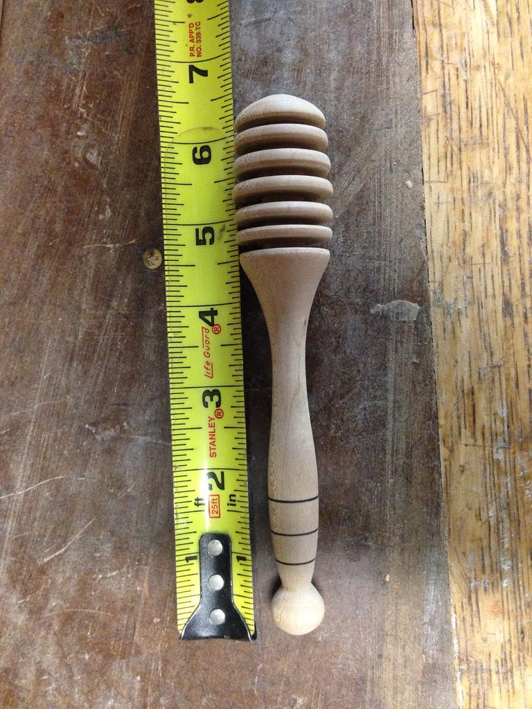

April 14, 20188 yr comment_146603 Steve your video inspired me to do my own honey dipper with the skew except used thin parting tool for slots. A fun project. Report

April 14, 20188 yr comment_146629 11 hours ago, Gerald said: Steve your video inspired me to do my own honey dipper with the skew except used thin parting tool for slots. A fun project. Gerald, just want to make perfectly clear. I shared that video but it wasn't of me. I like using a skew but that guy is a magician with one. Steve Report
