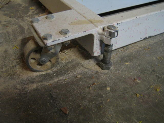

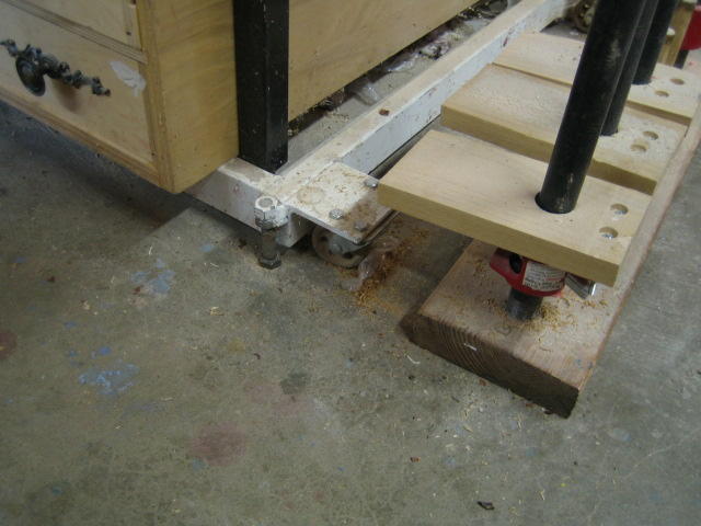

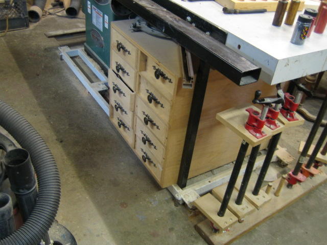

March 26, 20188 yr Popular Post comment_144803 Thought I would post this over here in the "SHOPS" section where I could "tag" it if someone else was looking for ideas. As I have mentioned in previous posts, I have been working on a Table Saw Storage unit for under the extension table and an outfeed table. I have combined the two so I can store the outfeed table out of the way when not needed. I can also use this as an assembly table. I used 2 motorcycle lifts to raise the cabinet off of the base to level it with the table saw. Since my floor is somewhat uneven, I went with 2 lifts so I could adjust for a slight slope (if needed) and for more stability. Here is the base with the two lifts and casters attached (not many PIP photos) Under the extension table in "storage" Showing 3 of the 6 drawers (sorry it is blurry) Showing the blade storage in the back In position as the outfeed table View of the lifts under the cabinet The entire cabinet is made out of MDF (scraps I had) and the base is from a failed project a few years ago. Projects like this help me use up some of the scraps that I have accumulating around the shop. Thanks for looking Report

March 26, 20188 yr Author comment_144824 @schnewj - I thought about the automobile scissor jacks but they were taller than these jacks when collapsed (at least the ones I found). I was since the goal was for this to also fit under the extension table and storage, I wanted something that would allow me the most height for the cabinet. I could have used shorter casters, but I have found the shorter ones do not go over cords and such as easily. As for stability, they are heavy and they are very stable. The most trouble I had with this project was getting the cabinet attached to the stands. There was not a lot of room inside the stands, even when raised to full height. Report

March 26, 20188 yr comment_144833 I want to commend you on your design....... but I went a completely different route and it seems like I saved lots and lots of extra things and time. I first built a long mobil base to handle the saw and the extension then welded some bolts there close to the swivel wheels when I wanted to make it permanent, then added a cabinet with 30 inch long drawers so I could use each half of the long drawers from each side of the tablesaw extension.. And probably the best thing I did was leave room on top of the drawers to store the long Incra Miter Guage.. Now my question, why go to the trouble of having to buy two jacks??? I read you post but am still puzzled. Report
March 26, 20188 yr Author comment_144841 @Smallpatch - I went with 2 jacks so I could "level" each side of the cabinet top when I use it as an outfeed table. My shop floor is not very even and I have noticed on my old saw and table that in one place in the shop all was good, if I move the saw and table, then the table was not "level" with the table saw table. Edited March 26, 20188 yr by Chips N Dust Report
