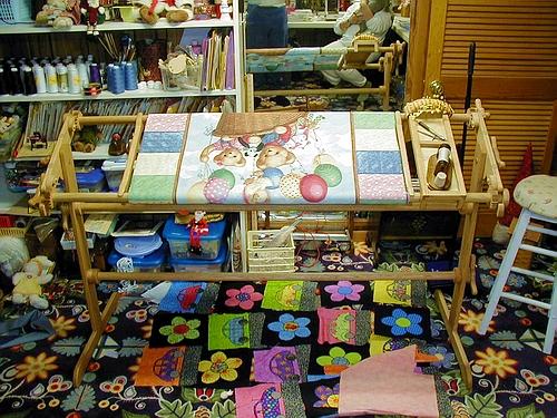

March 2, 20188 yr comment_142072 Many years ago my wife wanted a small quilt rack. I looked at some and created my own. I threaded the Oak at every connection and put big spinner type handles for easy tightening. It worked really well. I put spreaders on each side of the quilt and made a tools holder too. Threading wasn't too difficult, do it carefully and slowly Report

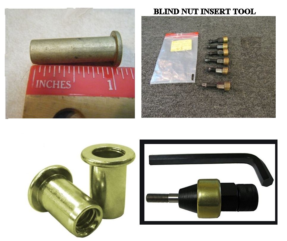

October 20, 20197 yr comment_205855 I use a threaded brass insert that takes a swelling tool. I drill the hole and then take a mill cutter and make the hole wider only down deep inside. Then I drop in one of the inserts and use the swelling tool to expand it. Most of the one I use is 1/4-20. Edited October 20, 20197 yr by Kevin Beitz Report
October 20, 20197 yr comment_205866 50 minutes ago, Kevin Beitz said: use a threaded brass insert that takes a swelling tool. I drill the hole and then take a mill cutter and make the hole wider only down deep inside. Then I drop in one of the inserts and use the swelling tool to expand it. Most of the one I use is 1/4-20. Any chance you have some pictures, sounds interesting. Never heard of a swelling tool, but maybe have seen but didn't know what it was. Report
October 20, 20197 yr comment_205877 Search rivnuts they are a threaded insert that work similar to pop rivets. Report
