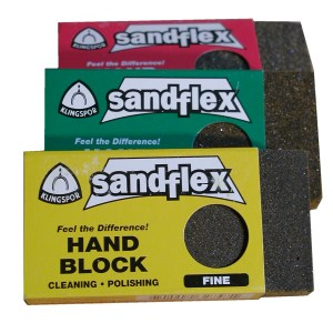

Larry, I've tried several approaches and still trying to figure the best method. For extremely rusty ones, I have used a 6" brass wheel on my bench grinder. What I've learned is it often lightly rounds over the square edges....for some not such a big deal; others I'd prefer to keep it as pristine as possible but restore the scale. I've also used both steel and brass rotary brushes in my Dremels to get the worst scale off then used Course, Medium, Fine rust "erasers" similar to those in this picture.
Again you have to be careful to prevent a slight round over of the edges. I've also used steel wool and kerosene, wet or dry emery and sandpaper with WD-40 and/or 3-n-1 oil.Also just soaking in a pan of white vinegar.

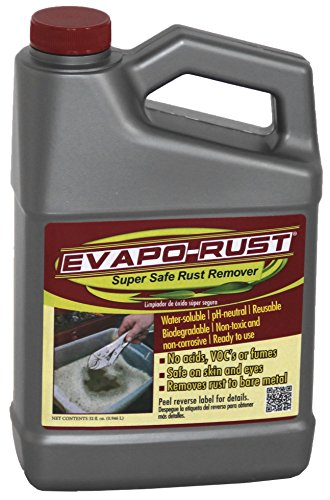

Last summer I picked up a gallon of Evap-O-Rust to try on some other projects. I had a combo square I'd picked up that was really rusty so threw it in a container to see what would happen. It cleaned every bit of rust (obviously leaving some pitting), but the scale shined like it had been polished. The down side it left sort of a "fish eye" for lack of better description finish on the scale. Even going back and sanding with a fine Rust Eraser, I could not remove it, but at least took some of the sheen off. I'd experienced the same effect on some steel items, yet not others so the jury is still out on when/where to use that product. Love it though for plane bodies and knives.
I'll try to post a different thread this weekend for the others I've "rescued." For larger squares essentially the same approaches. I have an old framing square I think I'll try the Evap-O-Rust on this year; soak some rags in it, wrap around the body, then wrap with plastic wrap. I have a set of cast iron table saw wings I may try the same approach on.

Honestly, the results from plain white vinegar usually work well. The Evap-O-Rust fully removes all traces of rust and if you just wipe off the solution versus rinse off, a protective film (invisible) remains on the item which will prevents any flash rust from developing for 2-3 weeks.
