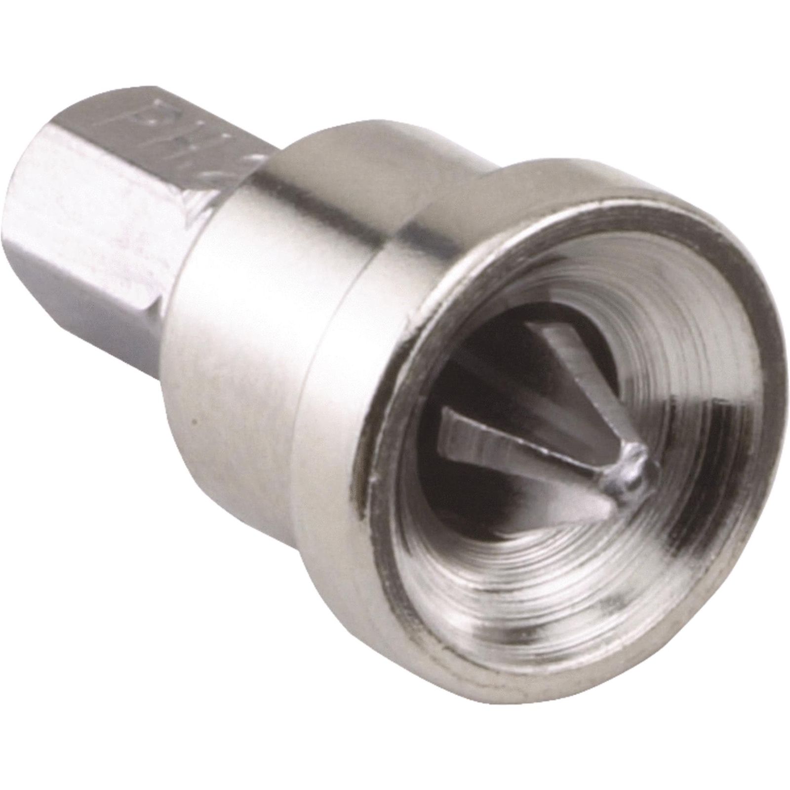

September 11, 20179 yr comment_124133 I plan to install 1/4" sheet rock over a wall of wood paneling. About 7 panels of sheet rock. Is there an attachment available to use with my drill driver to drive and set the screws to the proper depth? If so, what is the attachment called ? With 1/4" sheetrock I'm concerned about driving the screws too deep.I'm guessing that thin sheets will be a bit fragile. I know this will require a bit of framing modifications around windows and the entrance door. This will be a better aesthetic choice than painting the paneling. Edited November 19, 20179 yr by Ron Dudelston Added tags Report
September 11, 20179 yr comment_124136 It's called a dimpler, you can get them anywhere, from Ebay to Amazon, to your local big box or hardware. Steve Report
September 11, 20179 yr comment_124140 4 minutes ago, Steve Krumanaker said: It's called a dimpler, you can get them anywhere, from Ebay to Amazon, to your local big box or hardware. Steve sets too deep for ¼'' rock... Report
September 11, 20179 yr comment_124144 to be safe use adhesive w/ the DW... I'm sure you want the DW to be flat... ¼'' doesn't do that well... The best of the good stuff... Loctite® PL® 100 Drywall Construction Adhesive OSI is some you can't go wrong w/.. Edited September 11, 20179 yr by Stick486 Report
September 11, 20179 yr comment_124147 A few years back, my family room had paneling. I removed the paneling and replaced it with 1/2" dry wall and used the dimpler. I was glad I removed the paneling and went with the 1/2" dry wall. I did have to trim out the doors ways and baseboards due to the thickness differences. Removing the paneling is very easy and I think working with 1/2" drywall would be easier than 1/4". I used 8', 10', and 12. The longer lengths help reduce the number of butt joints. Danl Report
September 11, 20179 yr Author comment_124154 Thanks Steve and Stick for the quick responses. I wondered about glueing. Thanks for the tip Stick. Danl, I had considered removing the paneling, but the panels are apparently glued to the studs. Report
September 11, 20179 yr comment_124163 @It Was Al B.... do you see the difference in posted samples of Dimplers... Dan's is depth stopped only... the Bosch has automatic clutch release to prevent drywall tear-out, magnetic, depth settable, tips can be replaced... Report

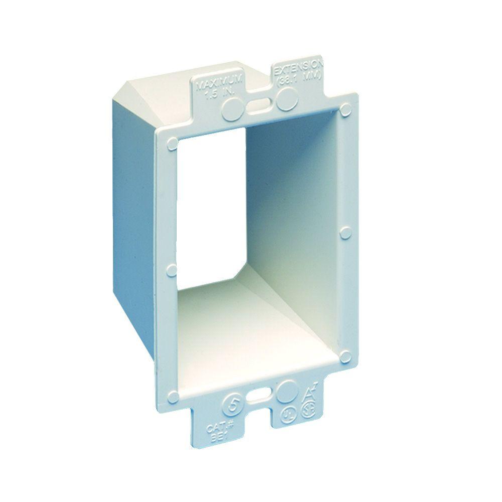

September 14, 20179 yr Author comment_124515 9 hours ago, Stick486 said: you relize that you need to hit the studs when you put up your rock.... Definitely! Couldn't find the Bosch dimpler at Lowes, but I did find a Maxfit ready load set by Dewalt at HD. That should serve my needs. I started what demolition that is necessary today . A bit more than I realized with the smoke alarm, electrical outlets and switches, wall phone. I'm going to need about a dozen electrical box extenders, and with the change in wall appearance, it will require all new outlets , switches and cover plates . Edited September 14, 20179 yr by It Was Al B Report
September 14, 20179 yr comment_124532 1 hour ago, It Was Al B said: it will require all new outlets have you considered hanging your rock vertically to save on labor/finishing and eliminating butts... devices - use American made Bryant BR15's.. you will not regret it... in stock at Lowes... their USB charging outlets are about bullet proof... well made and they have rock solid side clamps... you should be able to do away w/ the pig tails... use sleeves for your extensions... Report
