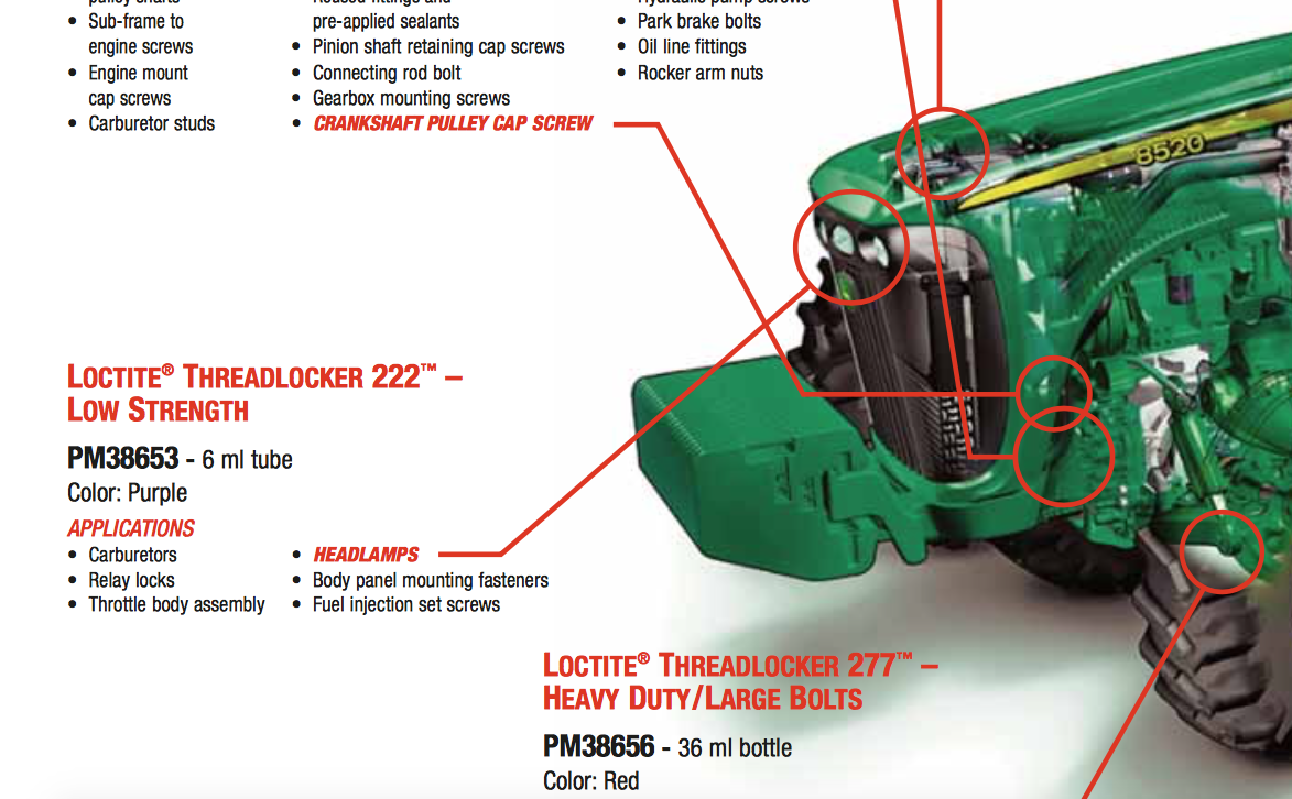

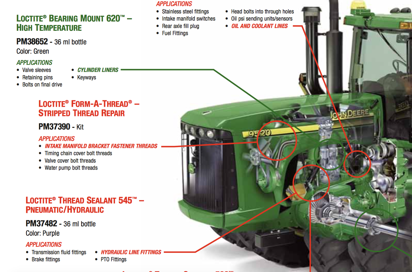

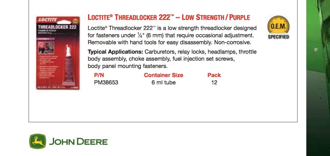

August 29, 20179 yr comment_122565 31 minutes ago, clhyer said: Never heard of Loctite green Dave. Will have to look it up. Cal Loctite Bearing Mount 620 is Green in color as is Threadlocker 290. There may be others but these two I'm familiar with and have used extensively in both my Ag & Manufacturing career. One thing I should have pointed out, all of these sealants have a shelf life (usually about 2 years). After the expiration life, the properties are less stable and may not work as stated. In Ron's application, he's OK, but in heavy equipment and engine manufacturing, the expiration date on these products was highly scrutinized and audited continually for conformance. John Deere published this conversion chart a few years back converting their part numbers to Loctite's ID. A very useful chart, but a fairly large PDF file. http://www.loctite.ph/php/content_data/LT4041_AAM_Deere_Brochure.pdf Edited August 29, 20179 yr by Grandpadave52 Report

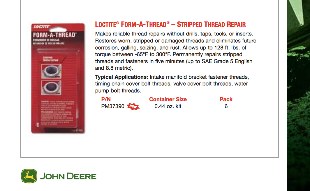

August 29, 20179 yr comment_122616 Ron, @Grandpadave52 provided a great reference tool. After spending a few minutes in the catalog I came across a couple possibilities that seem "made for you". Personally, I would try the stripped thread repair. If you don't have a John Deere dealer nearby you might be able to order it from an auto supply. Cal Report
August 29, 20179 yr comment_122629 In searching for the Loctite thread repair kit to buy, found that it's available thru Amazon. While rooting around there, I ran across this Loctite product for firearm repair. Looks like it might be just the ticket for those smaller screws. Report
