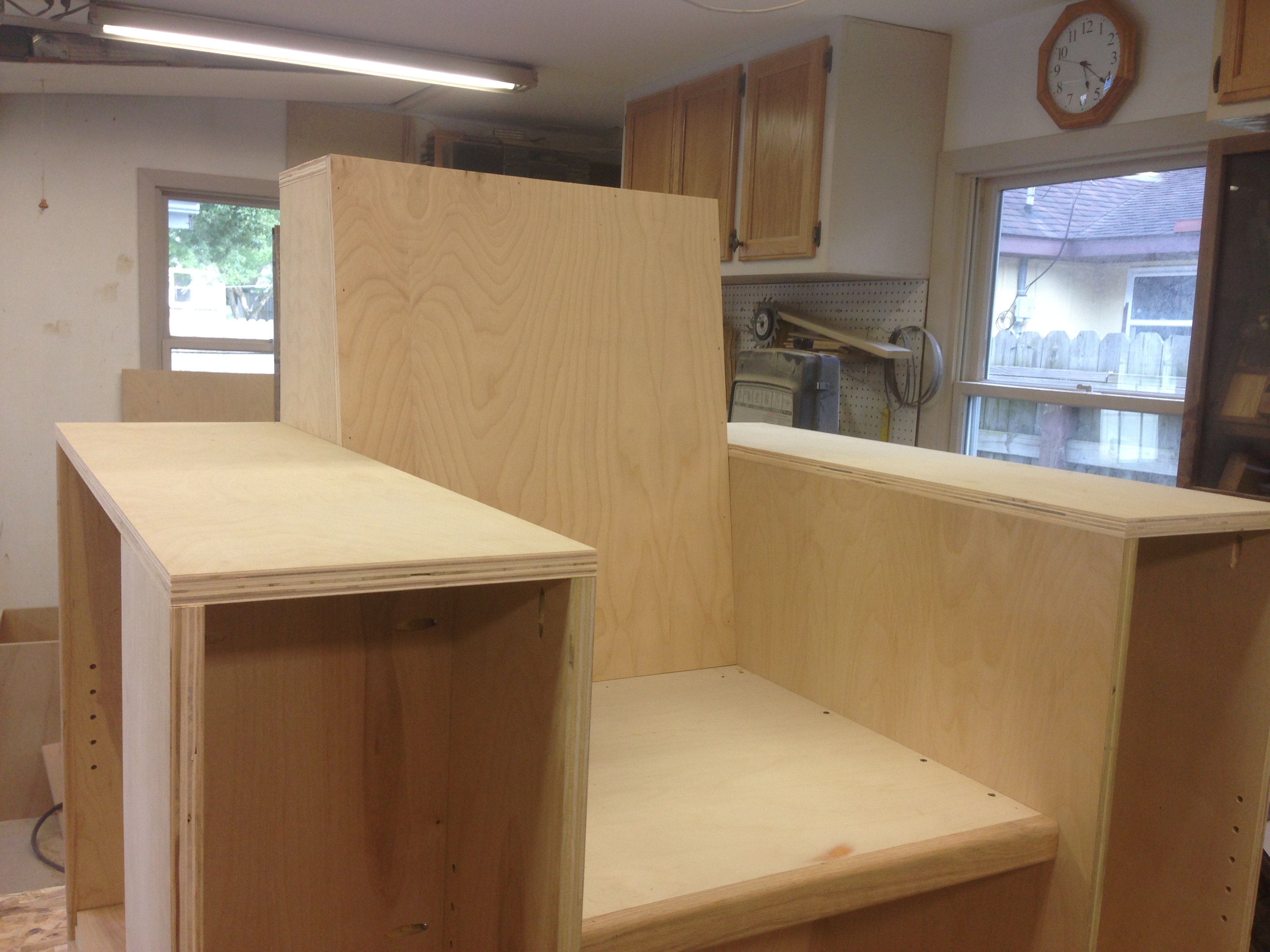

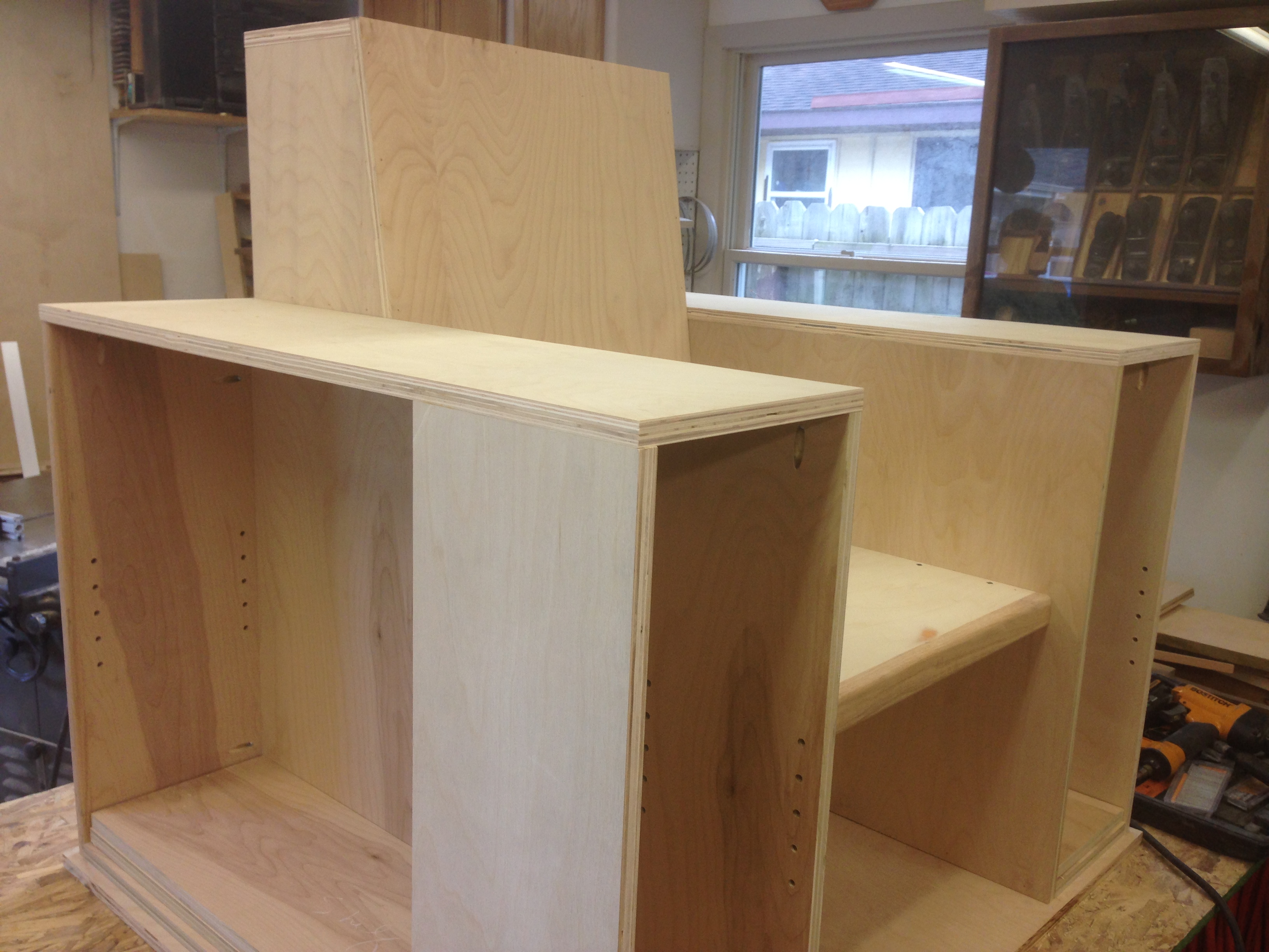

This is the basic design (sans seat).  Single shelf on the front (each side) and a single shelf on each side and a shelf/storage space underneath.  On top of the side shelves will the arms.  They will also be made from baltic birch and trimmed out with oak.  For those inquiring minds, the computer in the background is tuned to Spotify.

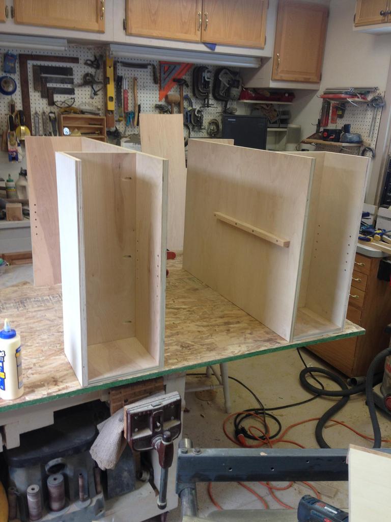

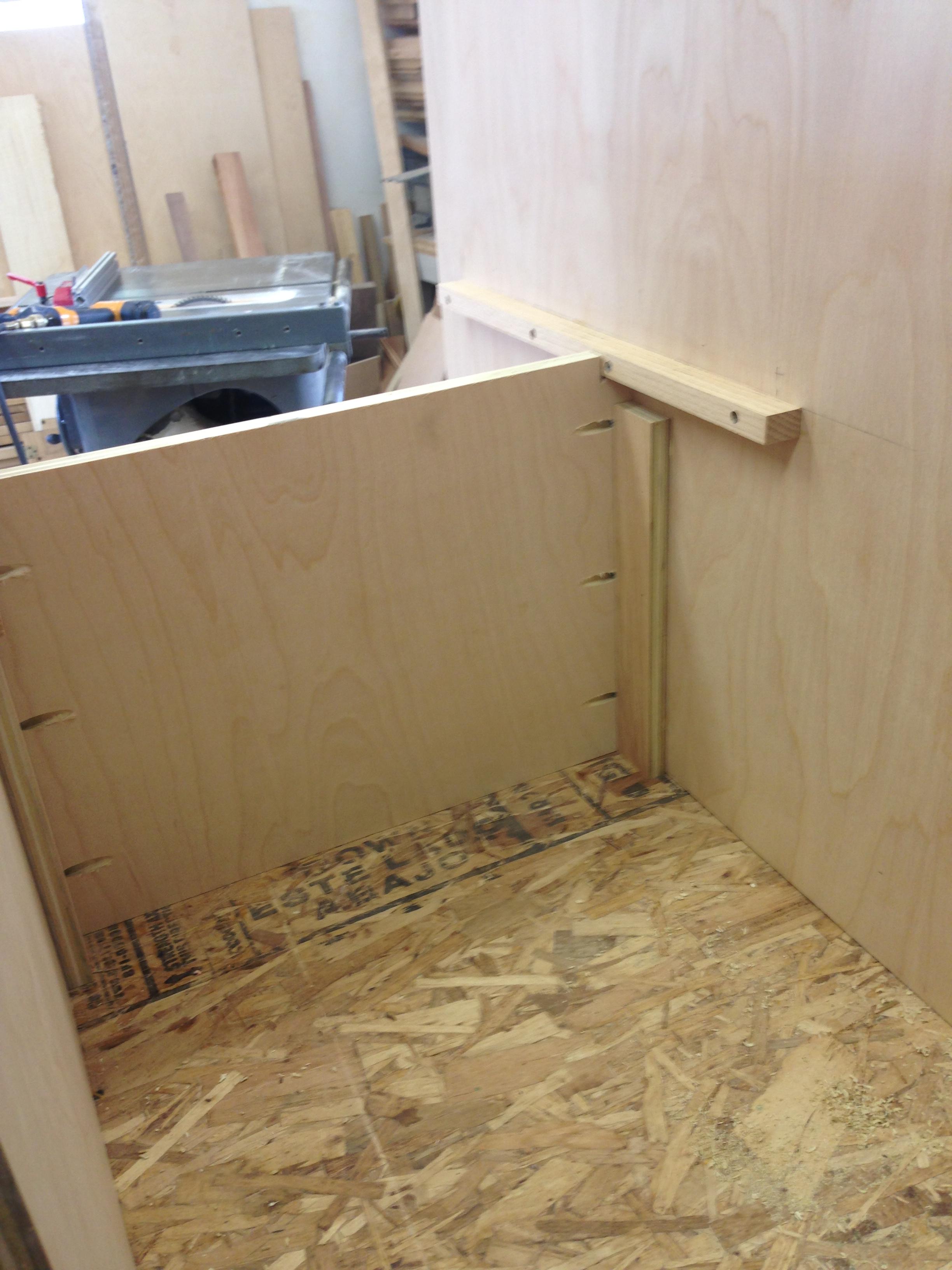

This is the back side of the chair where I added a vertical kick/seat support.  The space on the front under the seat is 14" deep and may be used as a shelf or a storage space.  I toyed with the idea of a making this vertical support slide into the side book space making a hidden stash but it sounded too much like work.  I'm already wishing I had done it.  From the back, there will be a drawer for extra storage.

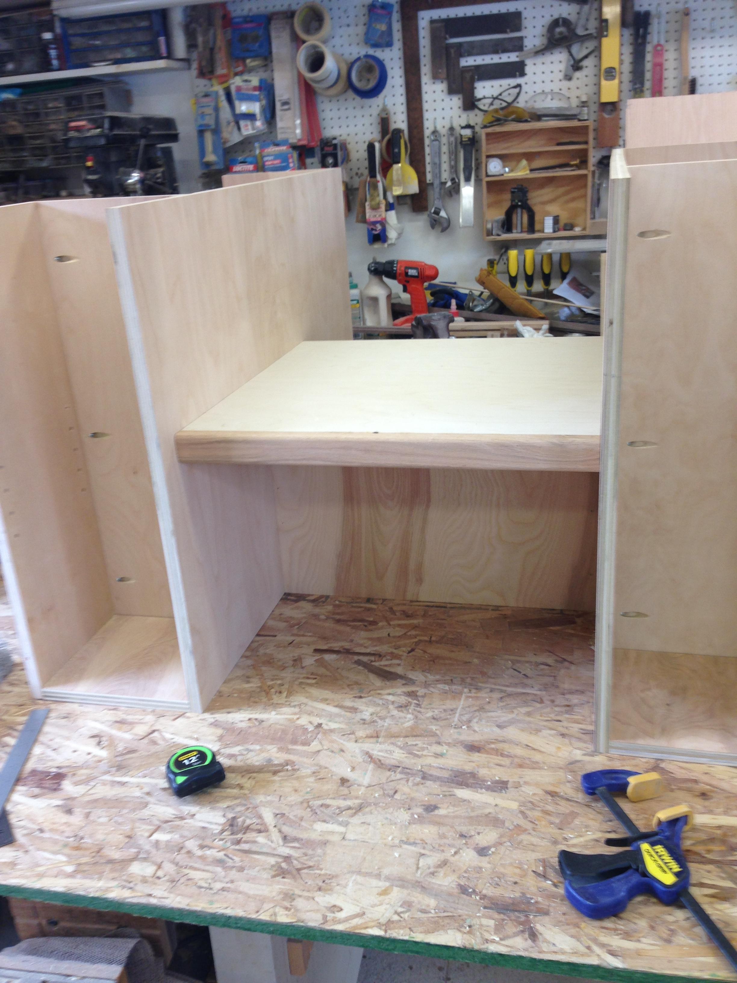

Here is the chair with the seat laid in place.  The seat in 18" off the floor and there will be a 3" cushion made for the chair.  The arms are 26" from the floor to the top of the arms. Looks like next up is the creation of the chair back.  The back will hold a book case accessible from the rear and will tilt at a 10 degree angle.  Tomorrow, I'll get more plywood to secure the lower seat section.

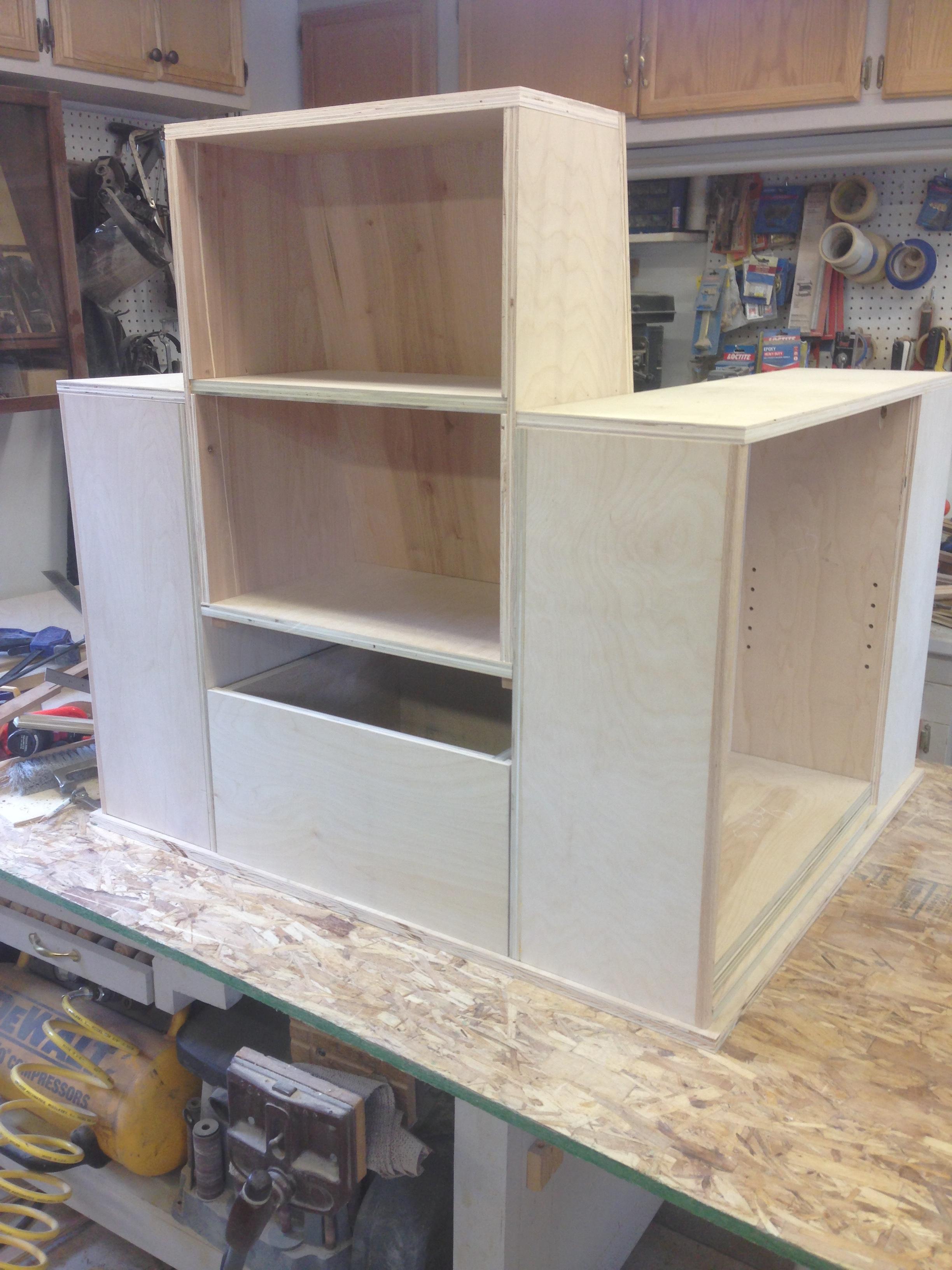

Here we are on Thursday and the bulk of the build is completed.  Next up is trimming the beast out with veneer on all of the exposed edges of the plywood and adding a 1/2" deep oak edge on the arms.  I also have to add a short face about the drawer on the rear to make the thing a bit more pleasing to the eye.  I had to pick this up to move it and it is flat heavy.
3 minutes ago, lew said:
Will the back/bottom storage be on drawer slides?
Yes sir.  I have a pair of heavy 16" slides that it will travel on.  BTW, I'm still regreting not adding a secret compartment somewhere.
