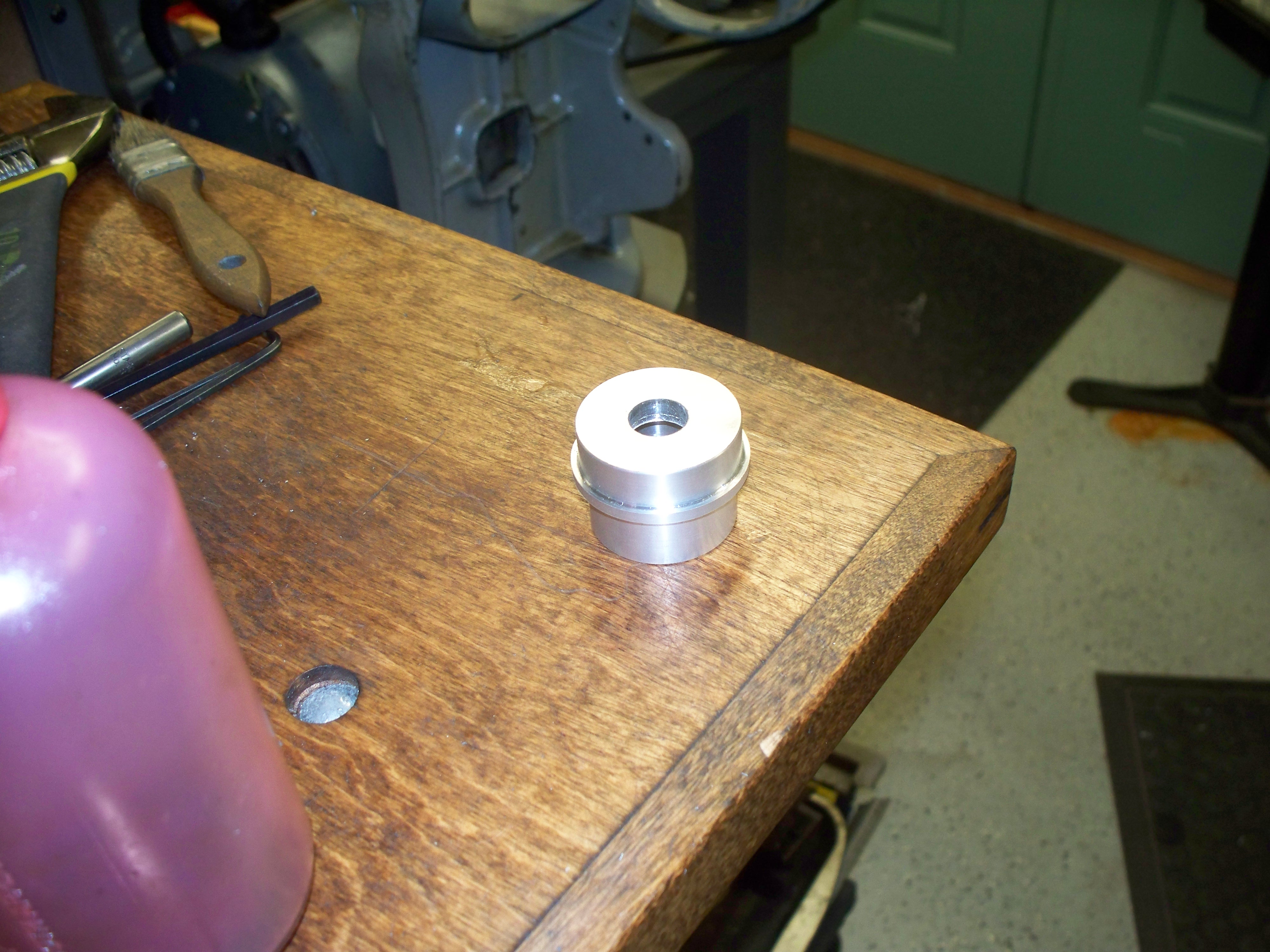

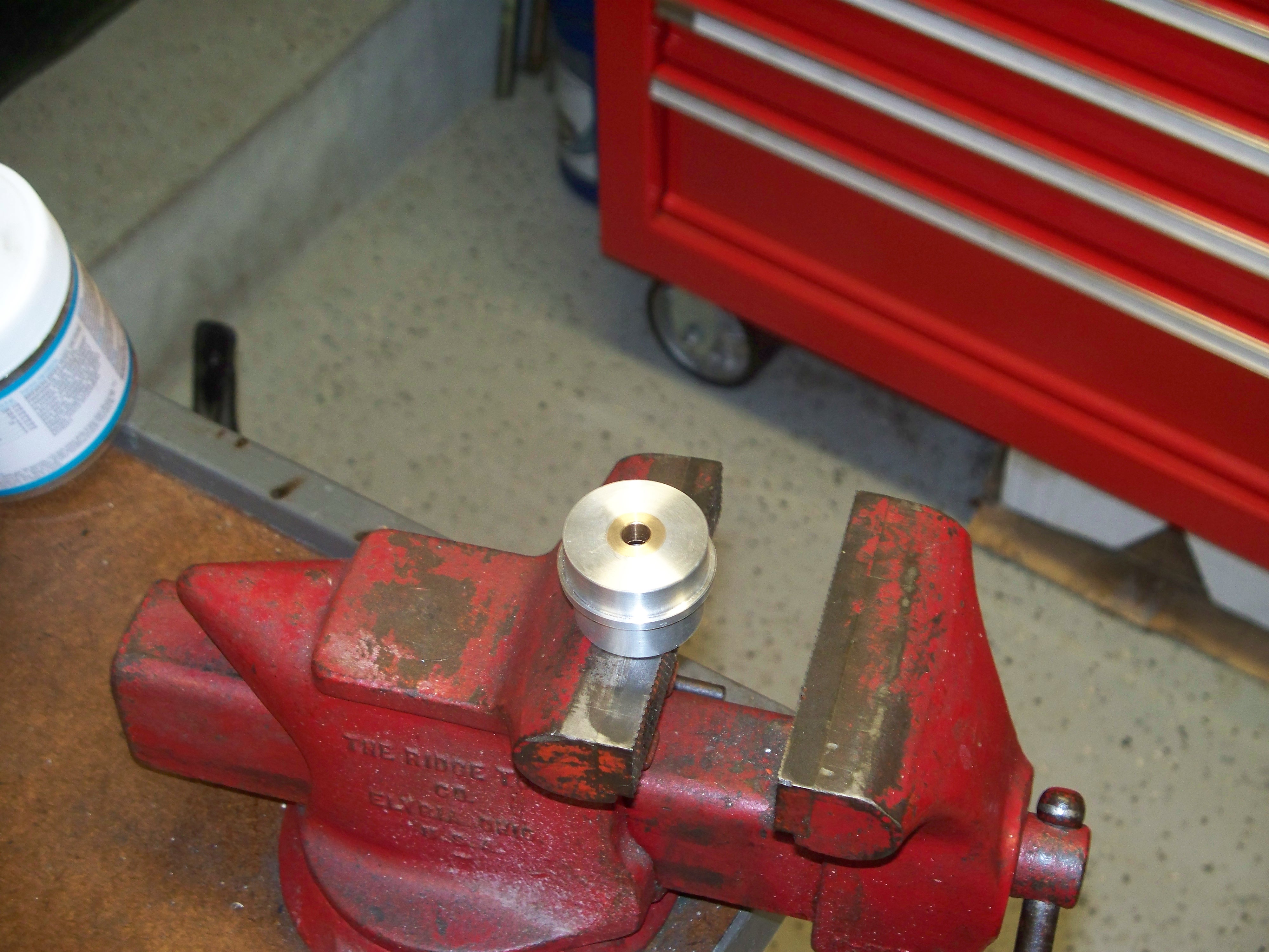

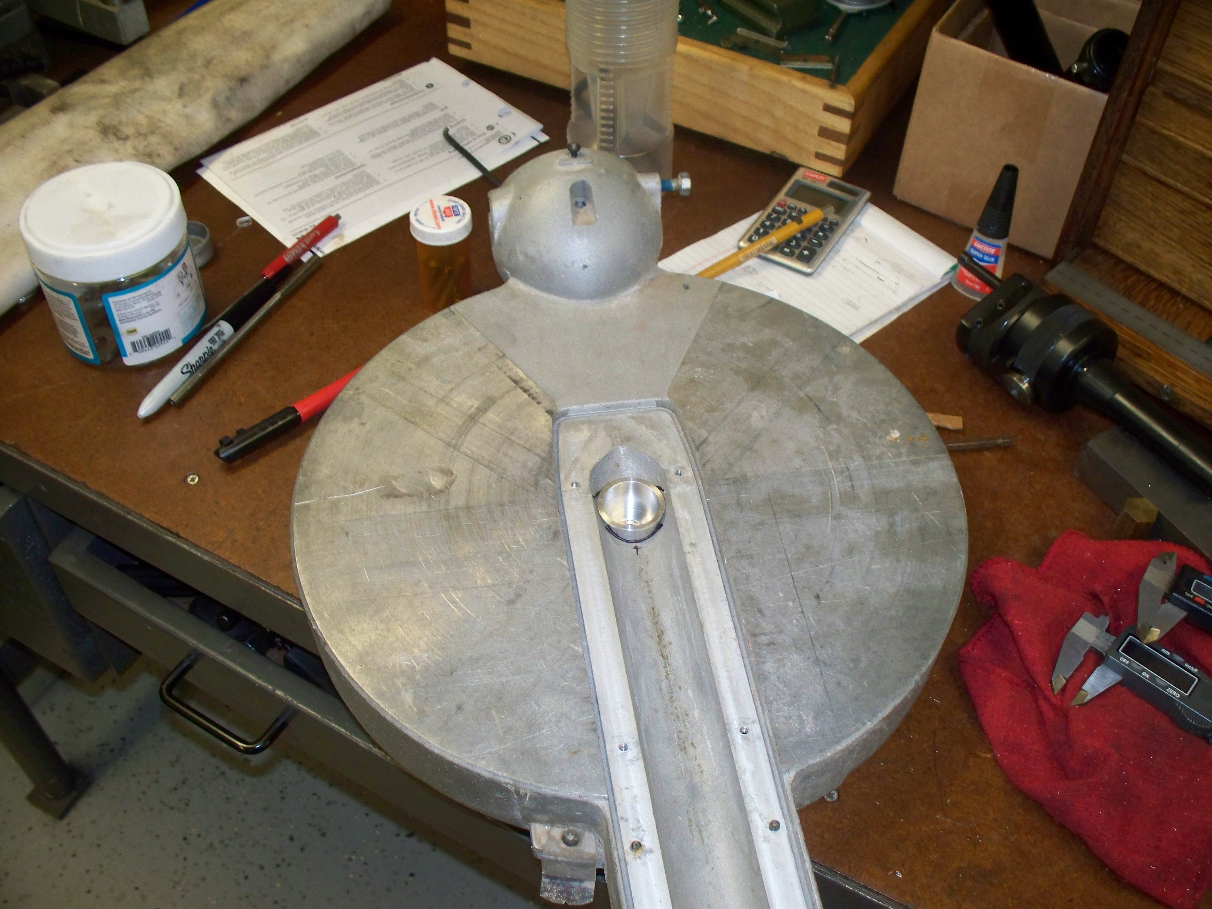

So I did not get much time in the machine shop today.  I have some other projects that are higher priority.  Anyway, I spent a an hour finishing up the bore on the part that takes the place of the original cast aluminum.  The bore is deep enough to keep the bolt and nut recessed so the saw blade does not come in contact with them.  So here are the pictures.  You will notice that I left a small shoulder to act as a stop at the table.  I am hoping to be able to TIG well the new part in place on the other side of the base. That would make the pivot very solid.   If I get a chance I will work on making the bronze bushing for the over size hole and reduce it to 3/8 inch to match the bolt.  I am also thinking of installing a bushing on the base for the bolt hole.  The hole is a bit oversize and is not really centered.  That will  need to be done in the mill.

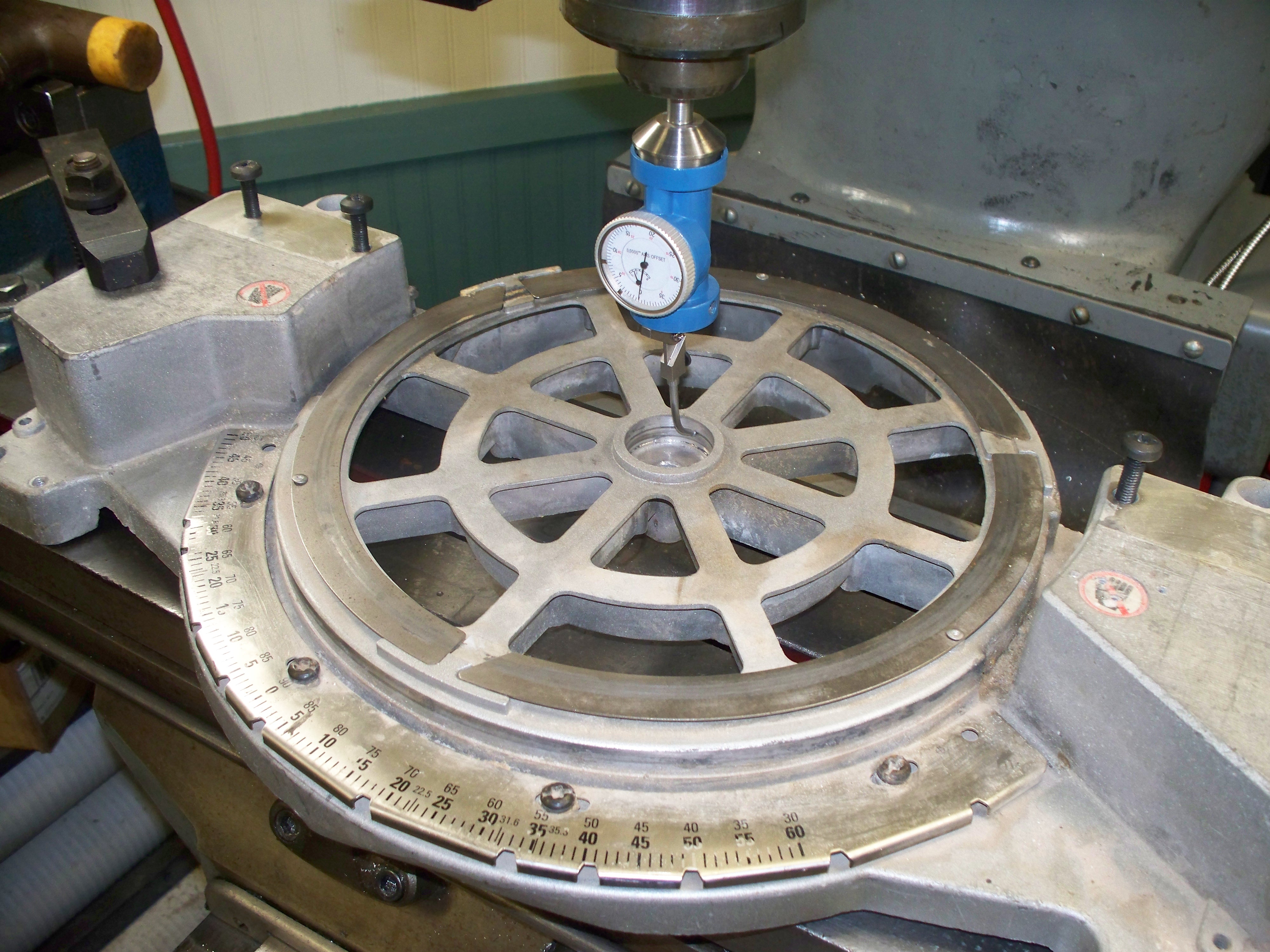

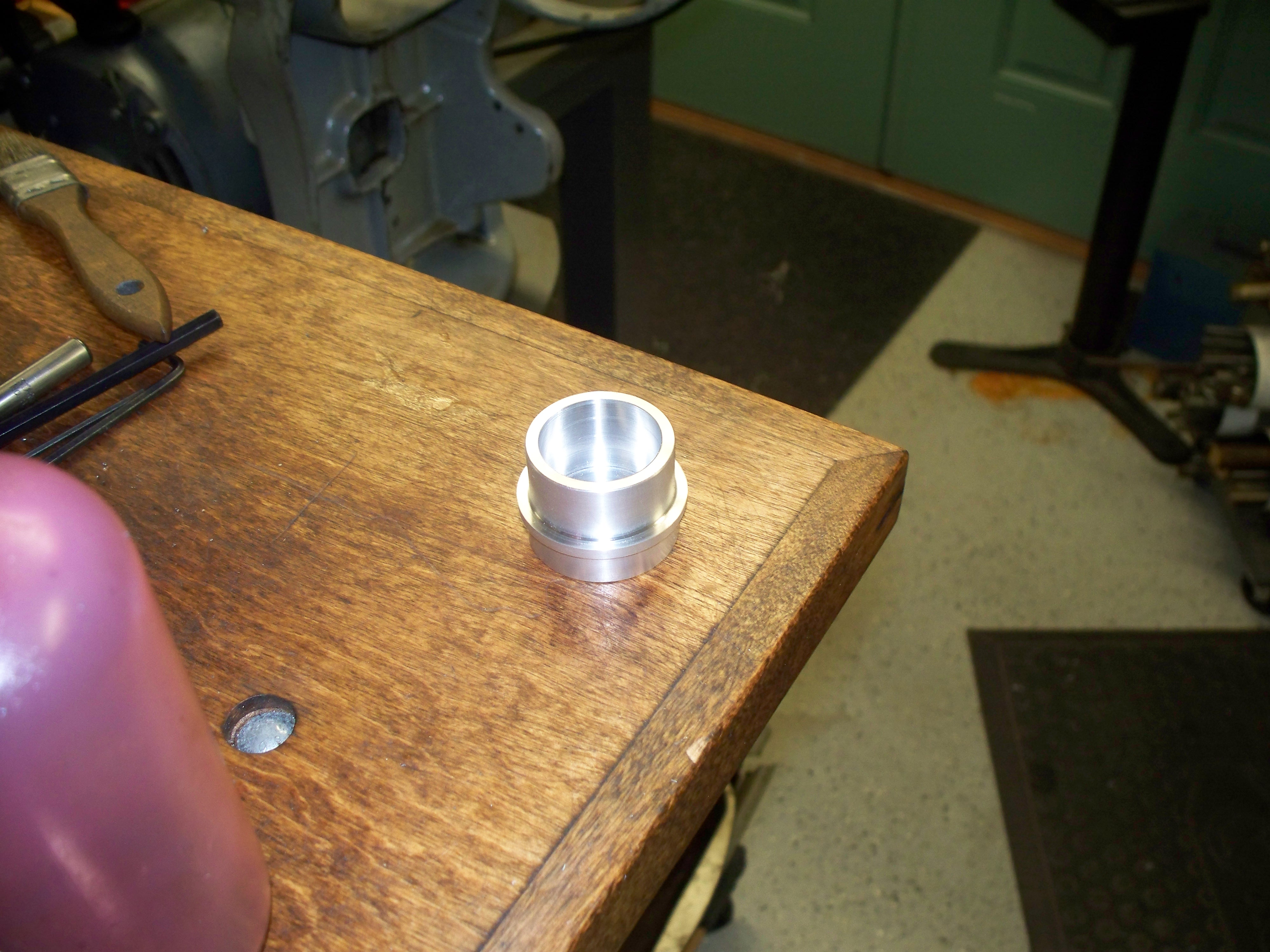

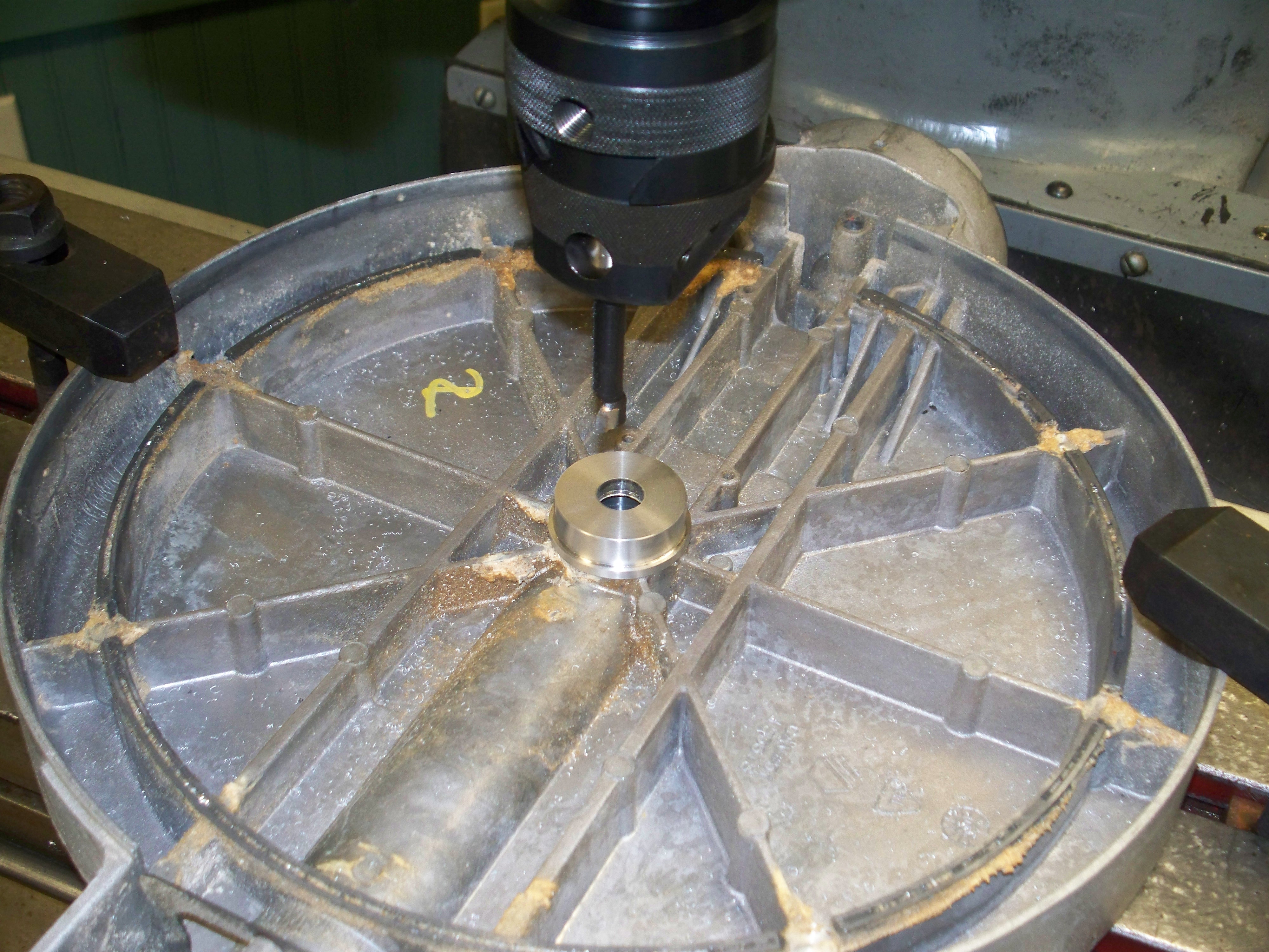

So today I made the bushing and got it bored.  I also started on the base setting it up an boring it over size so I can make a bushing and get get it fit.  So here are a few more pictures.  Picture 1 shows the new part with the bushing installed.  Picture 2 shows the  turntable right side up and the new part extending upward.  Now you may notice the black mark lines in the picture this is some of the material I will need to remove.  Picture 3 show the base set up in the mill with a center finder set up.  The center finder's increments are in .0005 (or 5 ten thousands) of an inch.  I was able to get it within 2 tenths (.0002)  The center finder was bouncing, but this should certainly be accurate enough for this job.  .000_1147.thumb.JPG.4fb7d62b0dd93768c2133d8348ed0430.JPG000_1150.thumb.JPG.183201e084df622687bc9afd4c4a514a.JPG000_1148.thumb.JPG.4812c5df74146764d90e078ffd899599.JPG
I'm gonna' guess it was no where near that close when new Paul...I suspect if you dropped one of the leading zeros 002.-.005 was more like it.

No pictures today, but I did get the bronze bushing made up and installed.  I did a dry fit and everything seem to be good.  I still new to remove some material from the top of the new piece and then I can Lock tite it in place.  At that point I can buy some replacement 12 AWG cord and plug and I should be good (I hope). I'll try top take more pictures tomorrow.

Oh, I did a little more on the aluminum replacement part tonight. I was able to cut a cove on the mill the remove some of the excess material.  I also pressed it in place and used some Lock Tite to solidify the fit.  I still did not get any more pictures of the project.

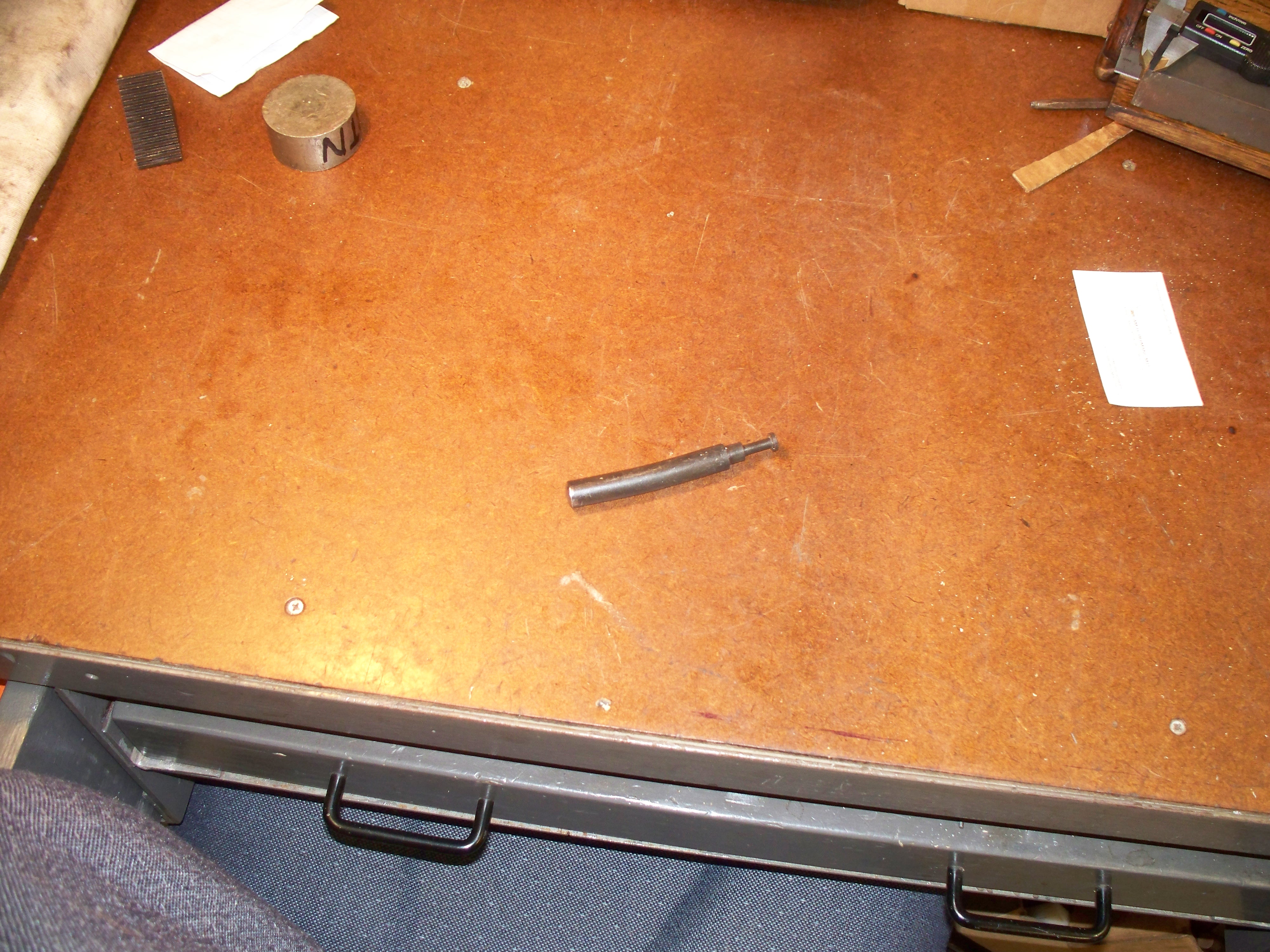

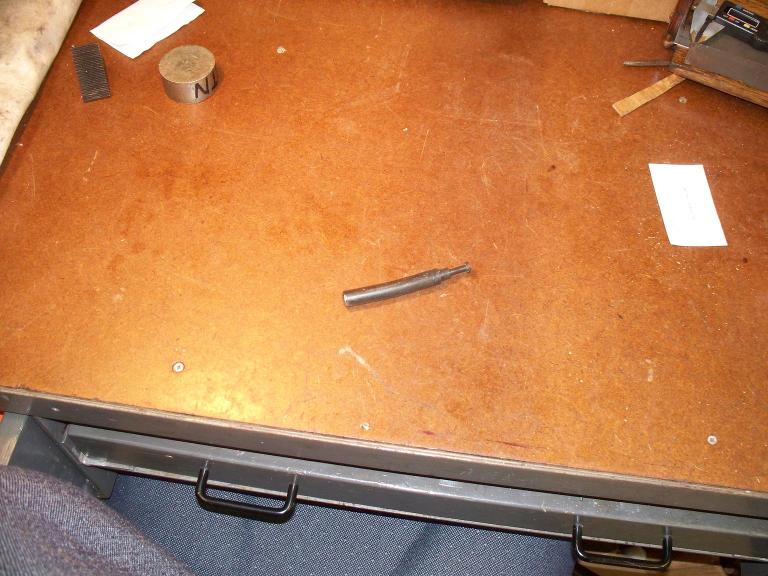

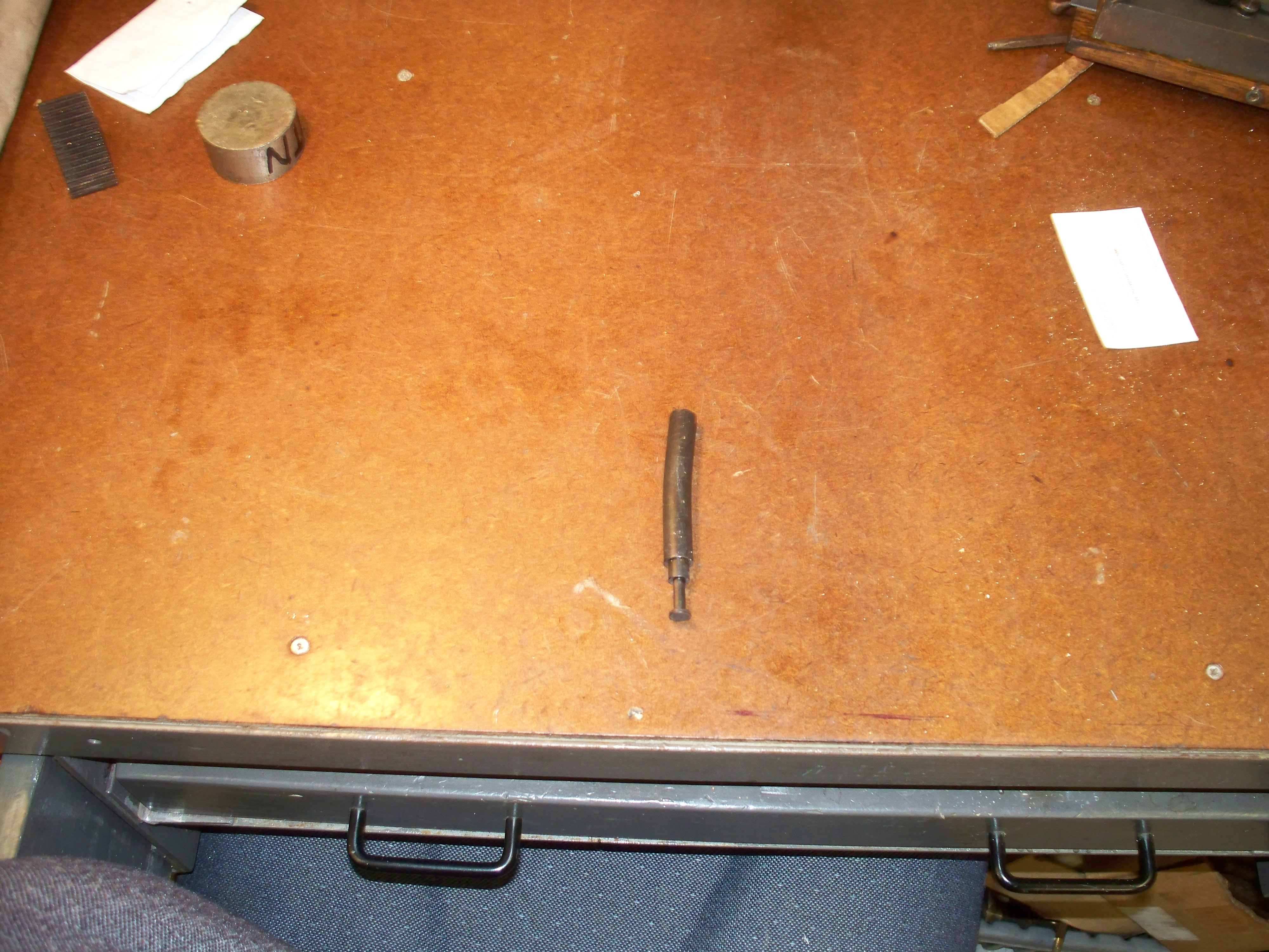

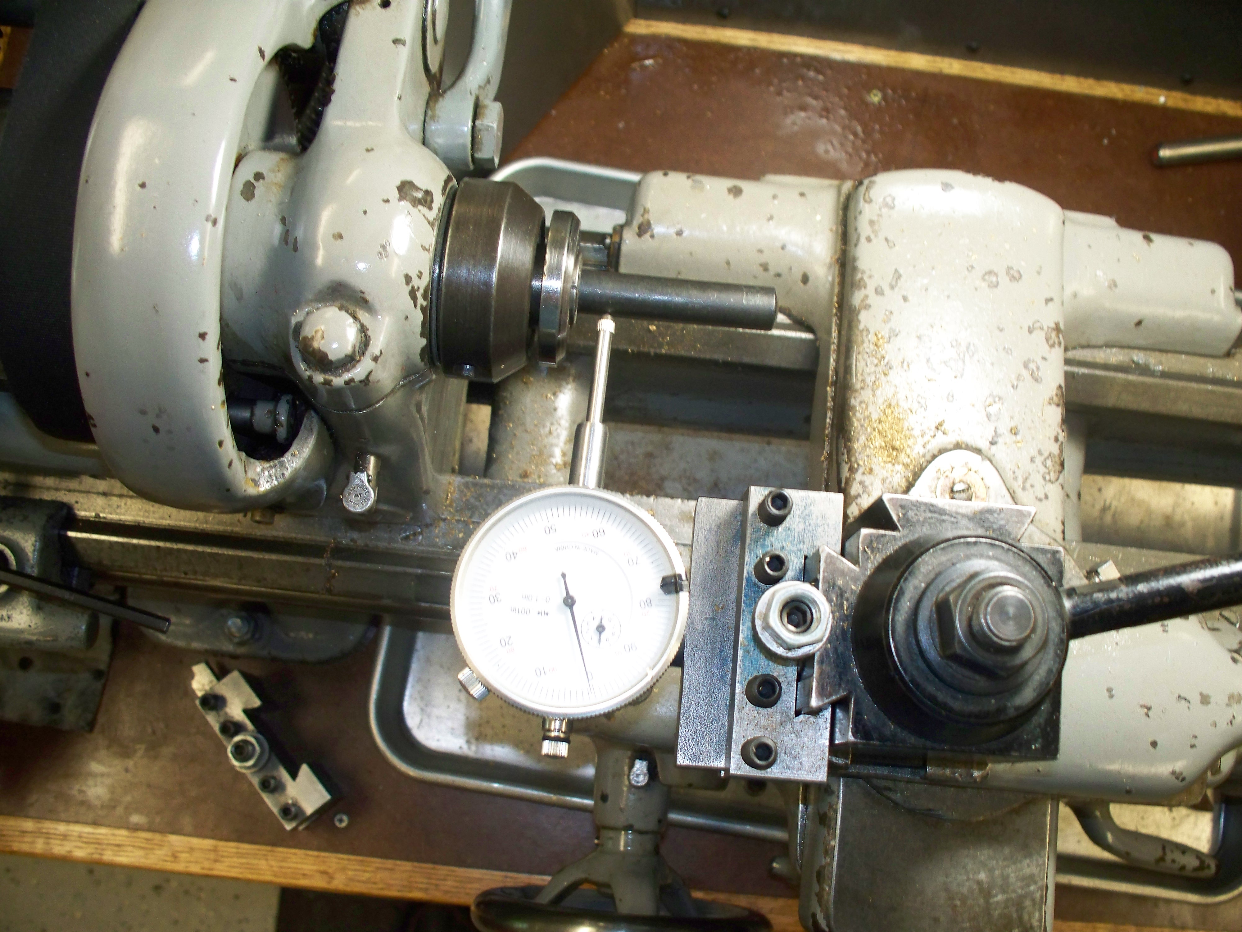

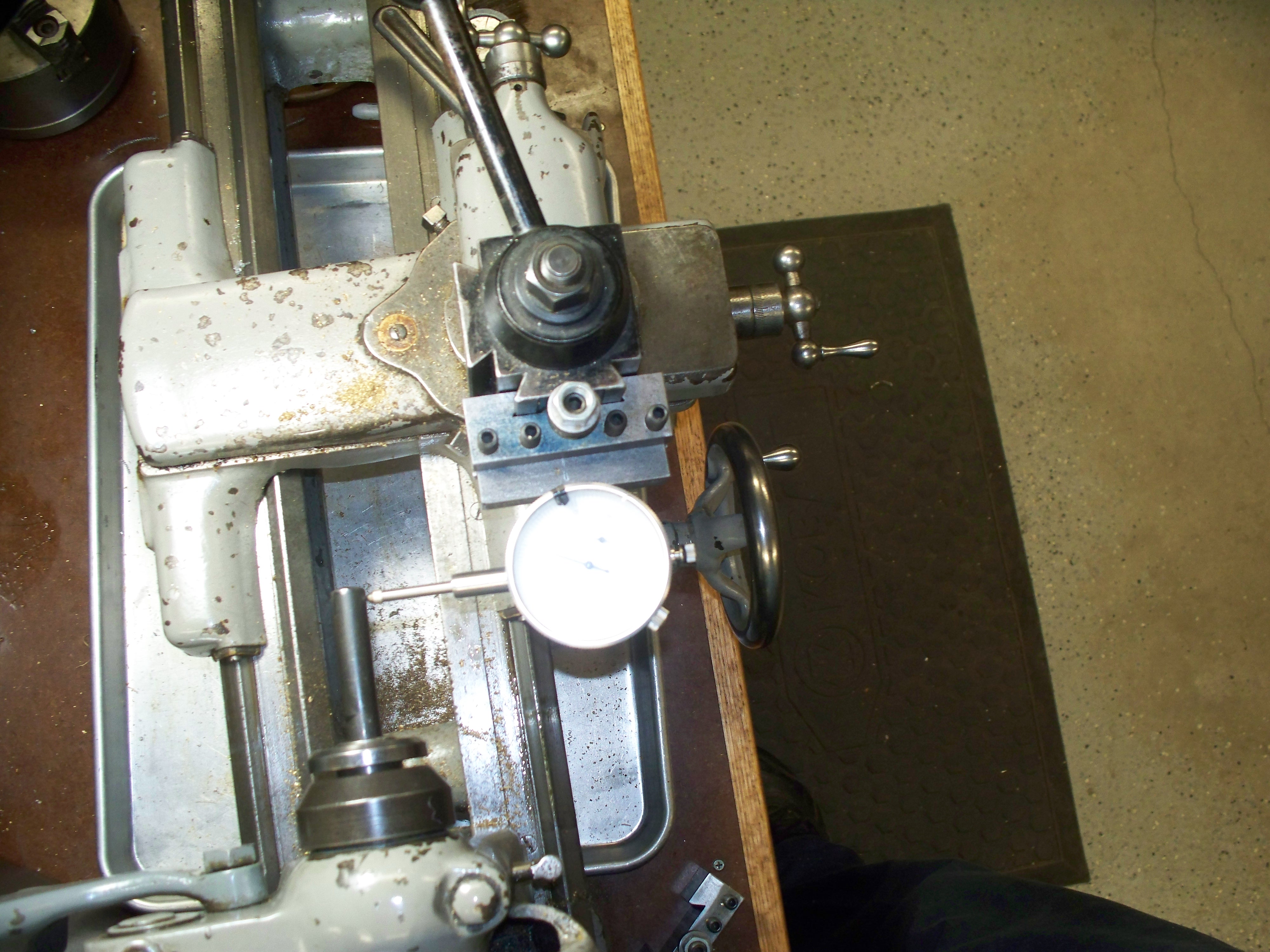

OK, I'm back.  I finished up on the bushing and dry fitted the table to the base and it really worked out well.  I have no play what so ever.  So I started to reassemble the saw. Unfortunately, I found that I had another issue that needed to be addressed and that was the vertical and bevel alignment pin.  It look to be a 1/2 inch in diameter and about 3 inches long  t)hat had  a bend in it . The bend was out at about .250 ( I for got to measure when I first started.  I had to decide if I wanted to turn a new one or try to straighten the old one.  I opted to try to straighten.  Well after 3 tries using my 12 ton hydraulic press and couple of Vee blocks I was able to get it within .010.  I think this will be OK, but if necessary I guess I can always turn a new one.  I meant to take pictures of the saw reassembled, but forgot so I'll see if I can get one the next time out.  Anyway, I did get a couple of pictures of the pin.  I never took one when it was finished but you get the idea.  BTW, the saw does work well.
Noticed that you can not read the dial indicator because of the lighting, but I believe the reading at the end (picture 3) was about .075.  An that was after the first press try.  The fist dial picture shows where the bend started.
Paul
