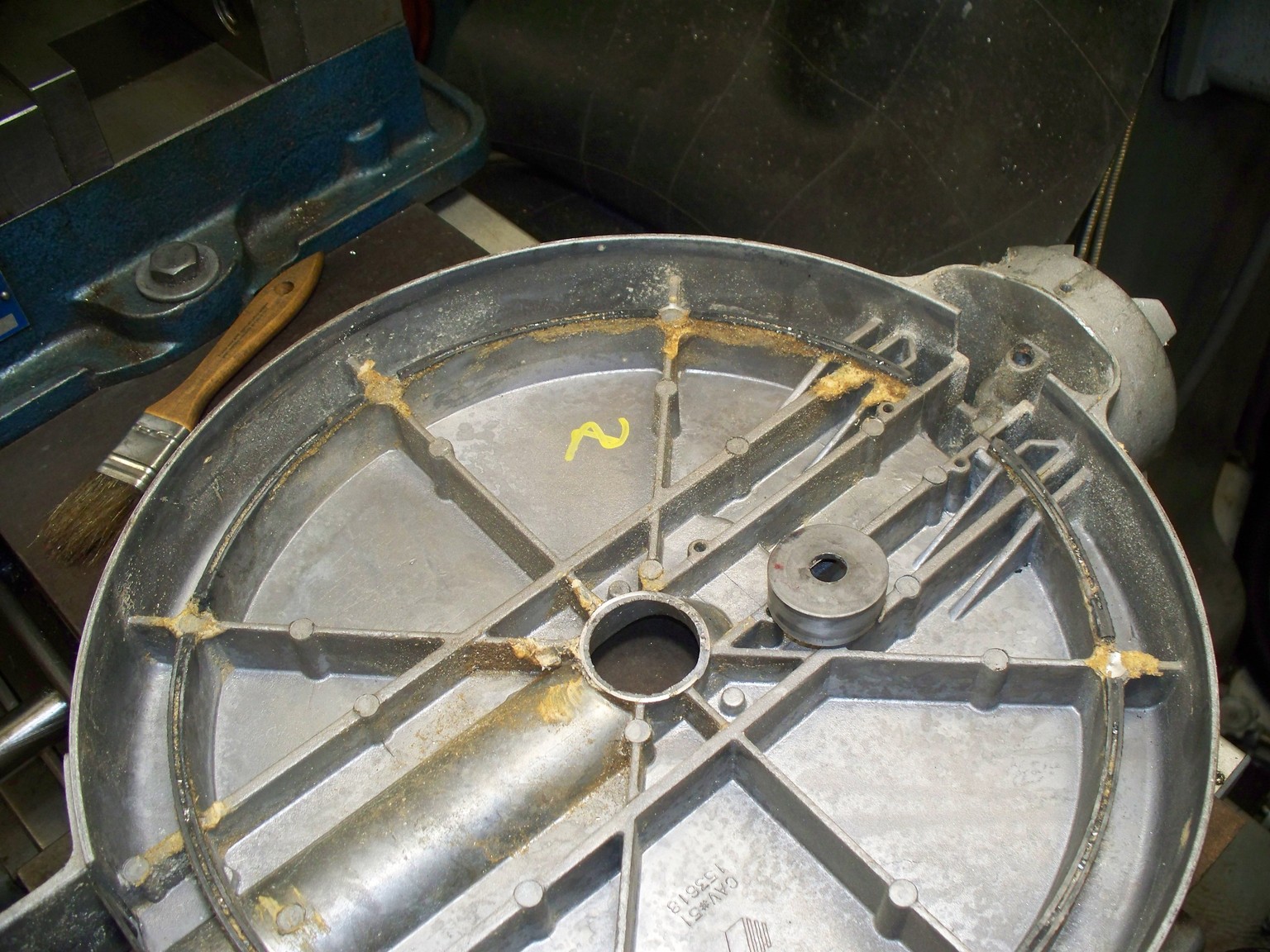

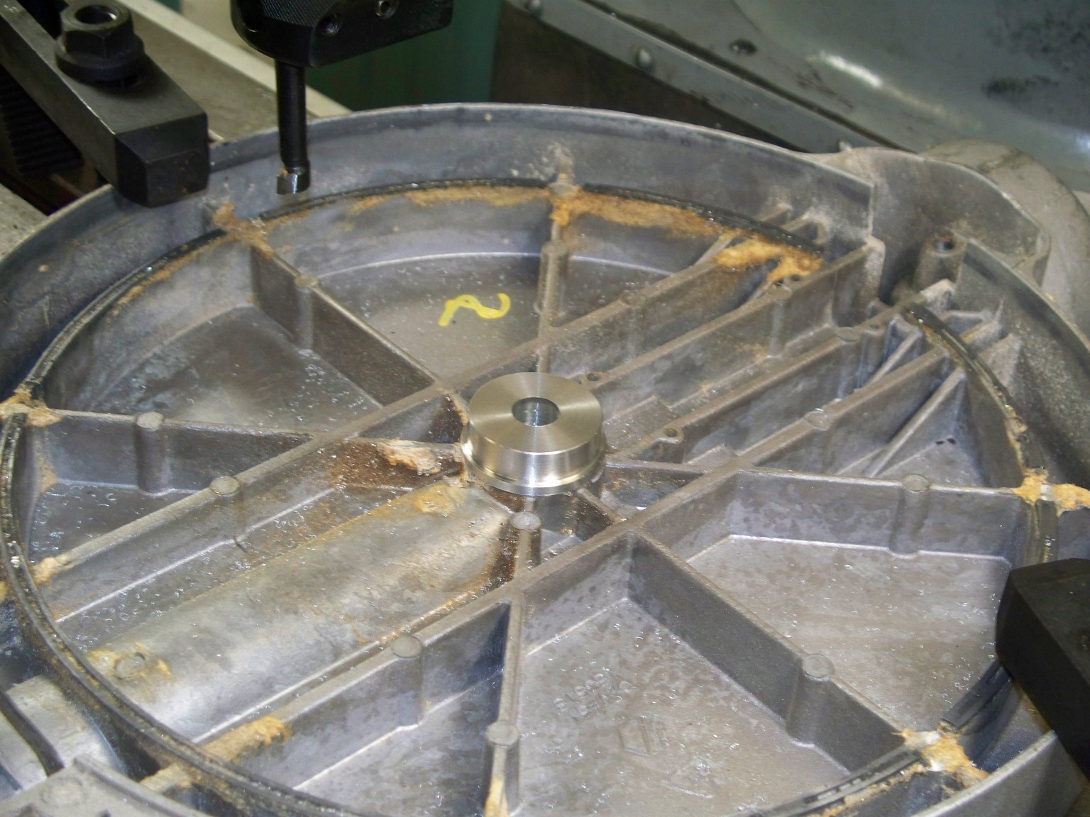

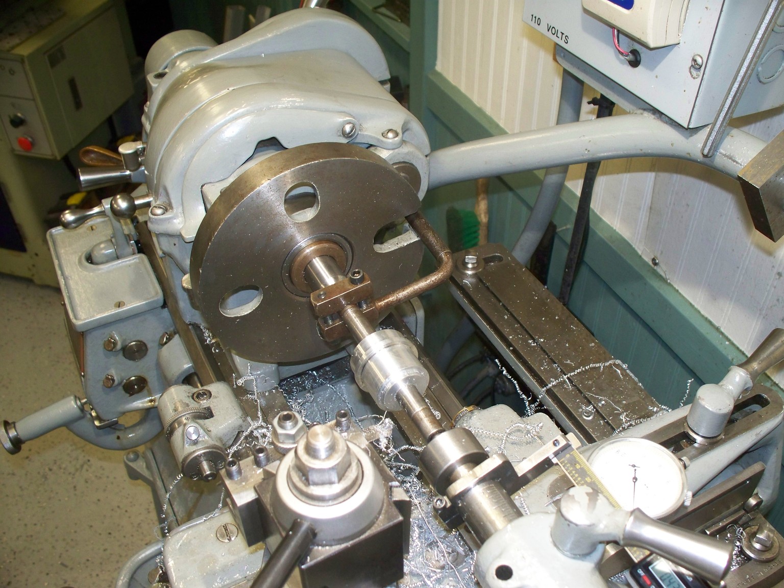

Thanks guys for the support.  OK, so after calming down with some sleep I decide the first thing to so was to jump the wiring to make sure the motor worked.  Well it was A - OK.  I expect that the cord was cut so now one would use the saw in the state it was.  So after that I finished disassembling the saw.  As you can see by the three pictures just  what I am going to need to do.   At this writing I am finished doing the boring of the rough aluminum casting.  I wanted to make sure I have a clean and straight surface.
Picture 1 is how it is supposed to be, and, #2 is how it is # 3 is the material I intend on using for the repair.  I'll take more pictures as I proceed.

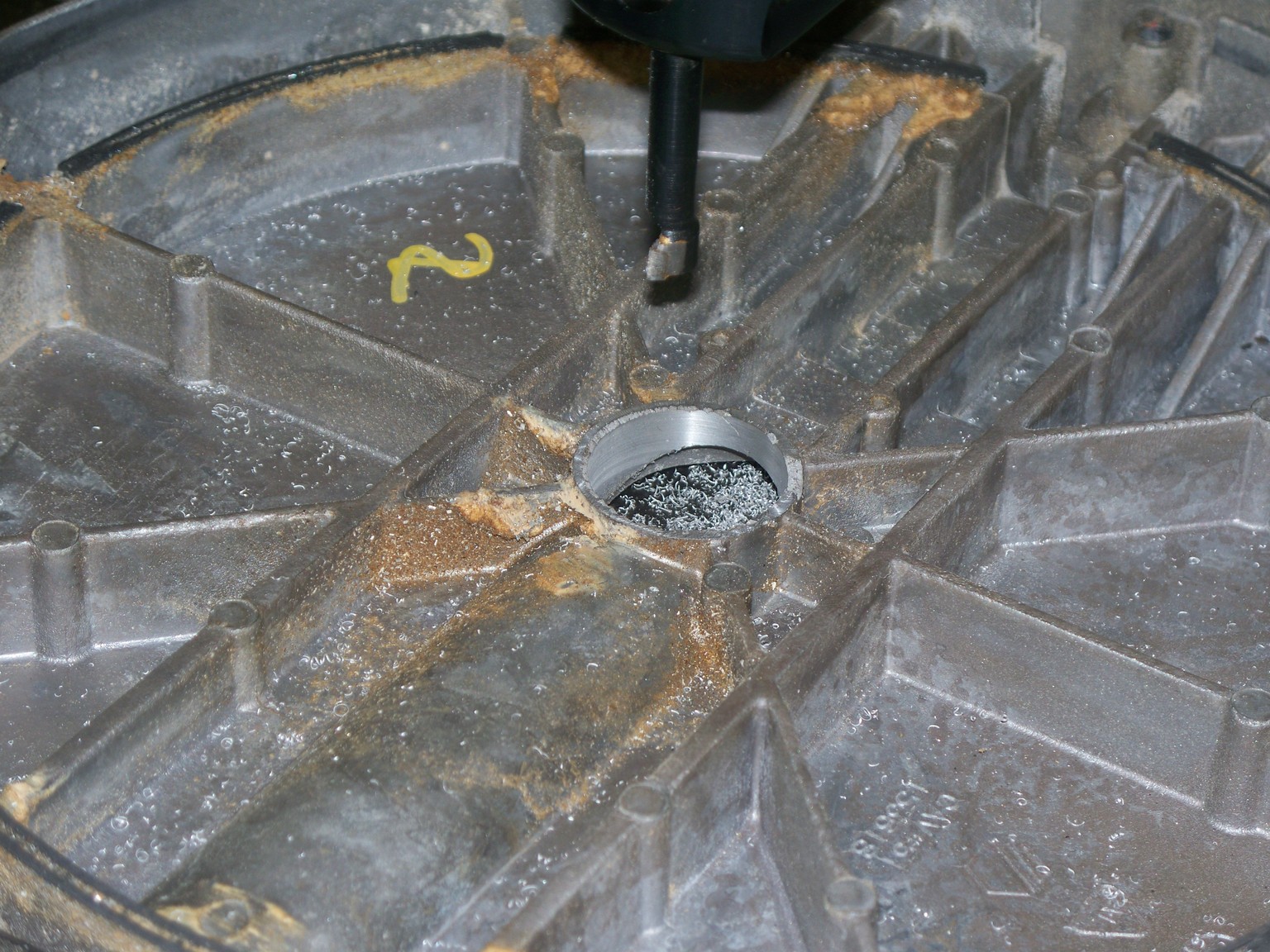

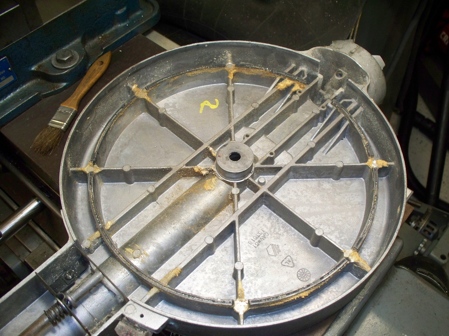

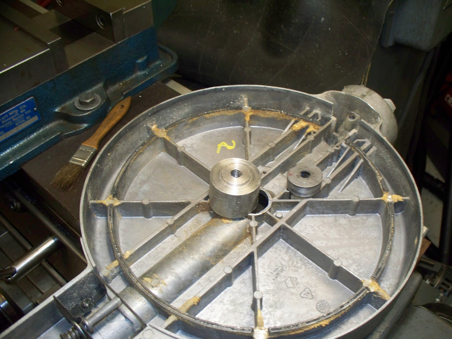

 The weather is a bit unsettling right now we have high humidity and it has rained off and on. So I did work on the saw this afternoon. I also took some more pictures. Now I realize that this is not a machining site, but since the work is on tools I thought you folks would not mind.  I am at the point that I need to do some boring so I can recess the the nut and bolt.  Maybe I can do that tomorrow.  Anyway her are a few additional pictures.  As you can see in picture 2 the new part fits.  I noticed a very slight crack in the housing when I was boring the table so I did not do too tight a fit with the part.  Maybe the new part can be TIG welded.
