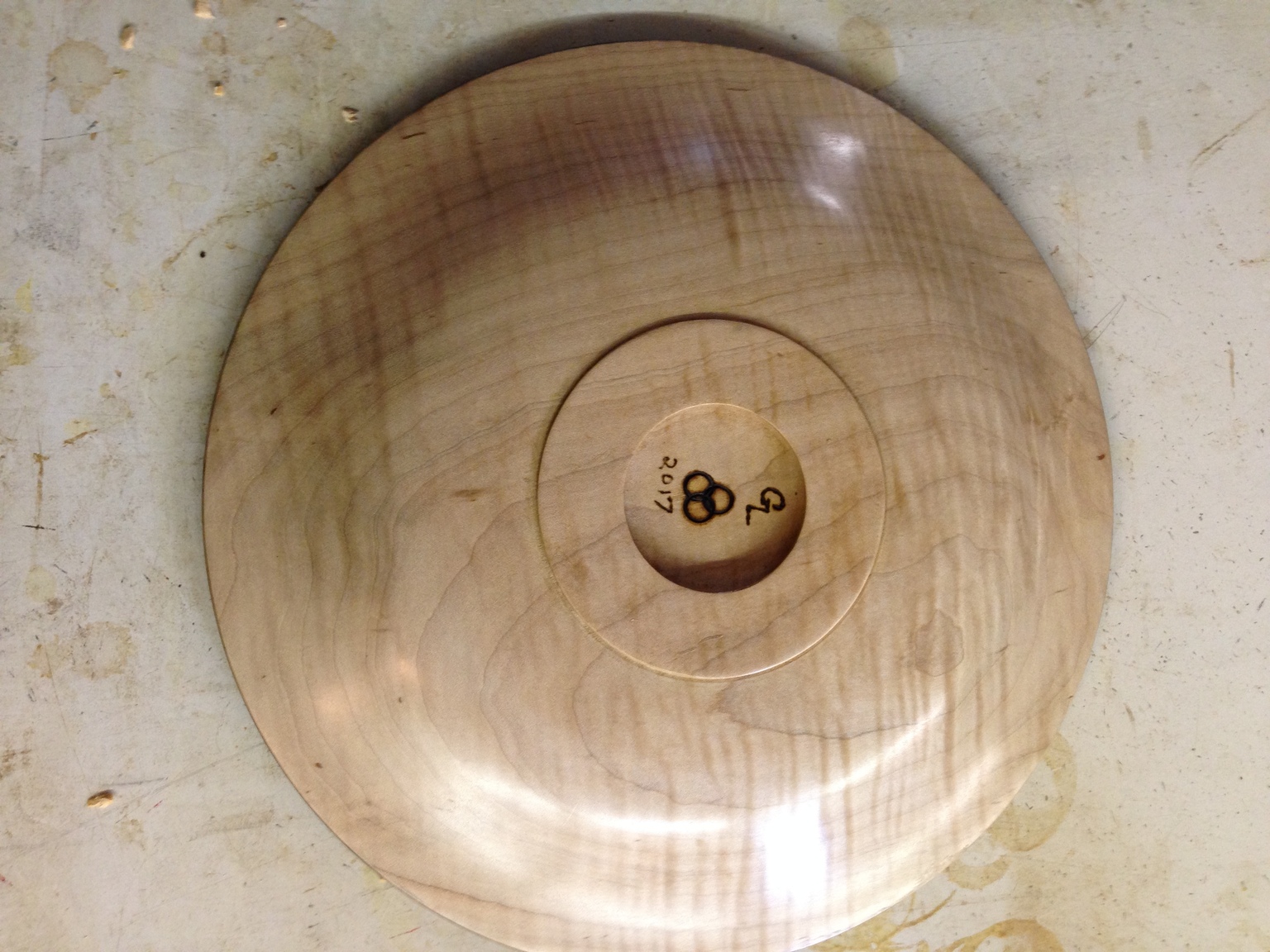

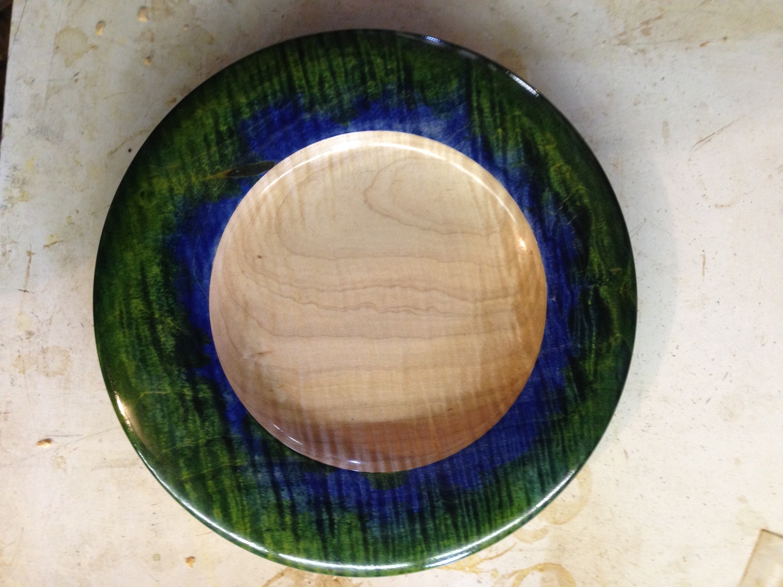

Clewes did not make it so we had our own turning two weeks ago. Finically got thru with the finish work.
Dyed with yellow and royal blue in Chestnut stains alcohol base. Back is shellac sealed and then Watco. Rubbed out with Mcguiar's rubbing cod and polishing cod. Then Renaissance wax. IMG_1165.thumb.JPG.20ece1f91700400ccba43aee5894dd7b.JPGIMG_1166.thumb.JPG.d31d335c37723638f60140080b6573ca.JPG

Regarding the finishing - how do you dye just the top and end up with a line?  If that question makes sense to you.
Cal
That's beautiful Gerald.  I know yellow and blue make green.  How did you retain some of the blue?
3 hours ago, clhyer said:
That is simply awesome!  I tried a couple other superlatives, but they were already used...
Cal
The dye is applied before hollowing the bowl part.
I just bought the 3 basic colors so I could combine colors. They do make a green but I only combine to get the green, so only used yellow and royal blue. the process is to apply a base color (royal blue) then sand most off . I left the inner ring in blue and it also stays in the curl. Then apply secondary color or colors. After the green I did apply some yellow to highlight. The dye is applied by blotting on with a paper towel. If you do not like the result then sand off and start over.
This is the video. The cloring starts about 45:00.
