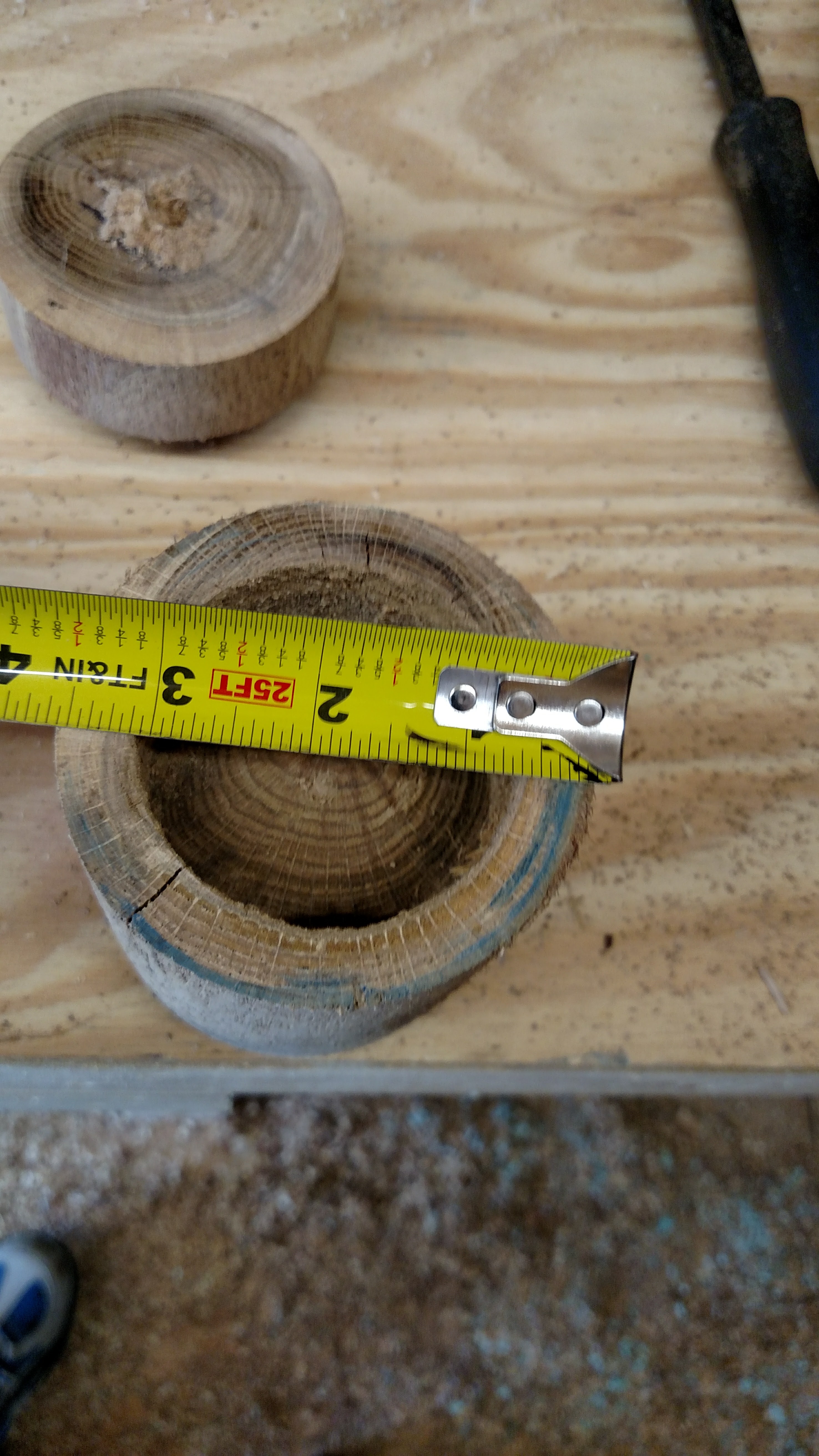

I hope this will be enough info.

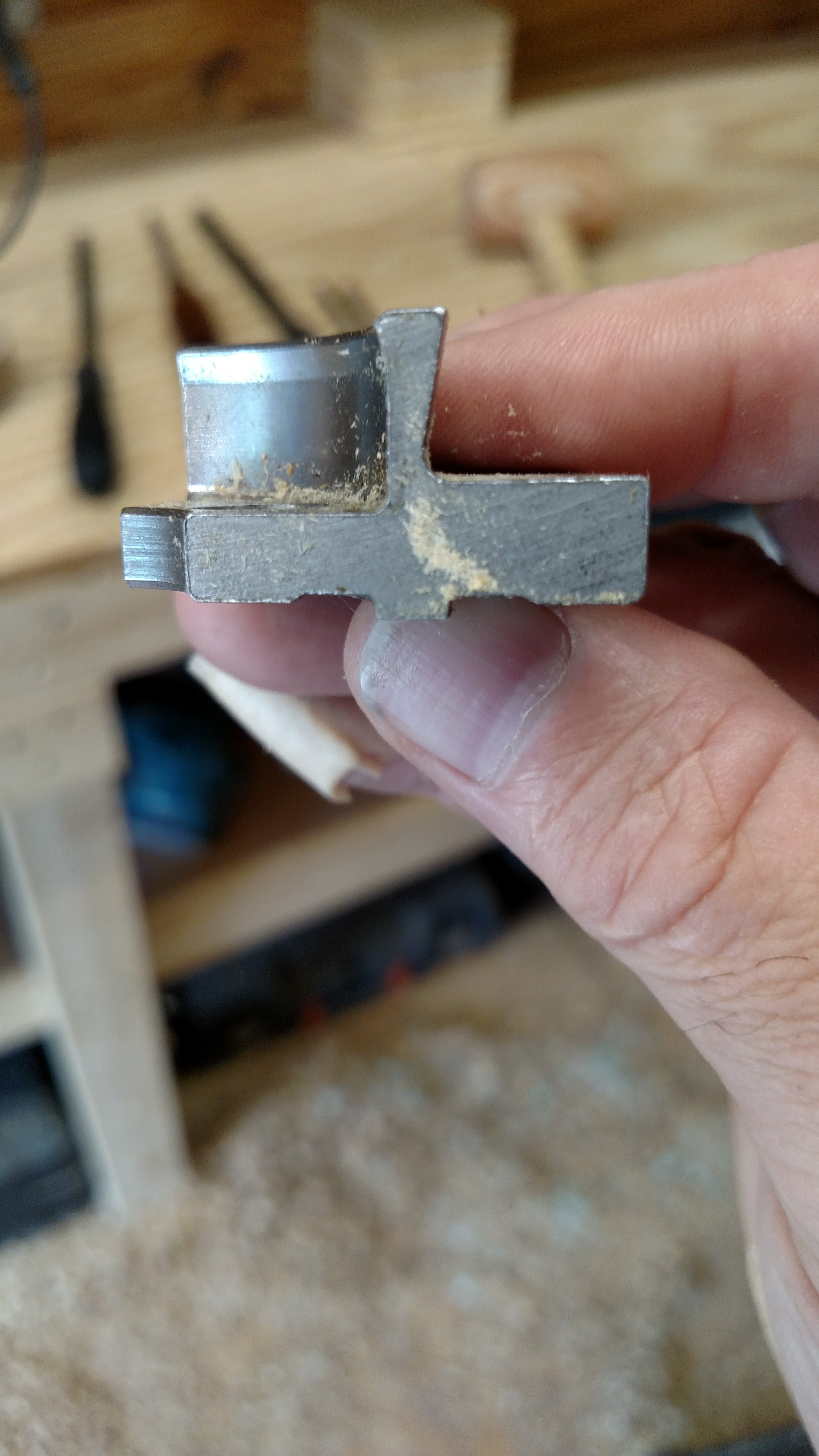

1, This is my original chuck jaw. 1/4" deep.

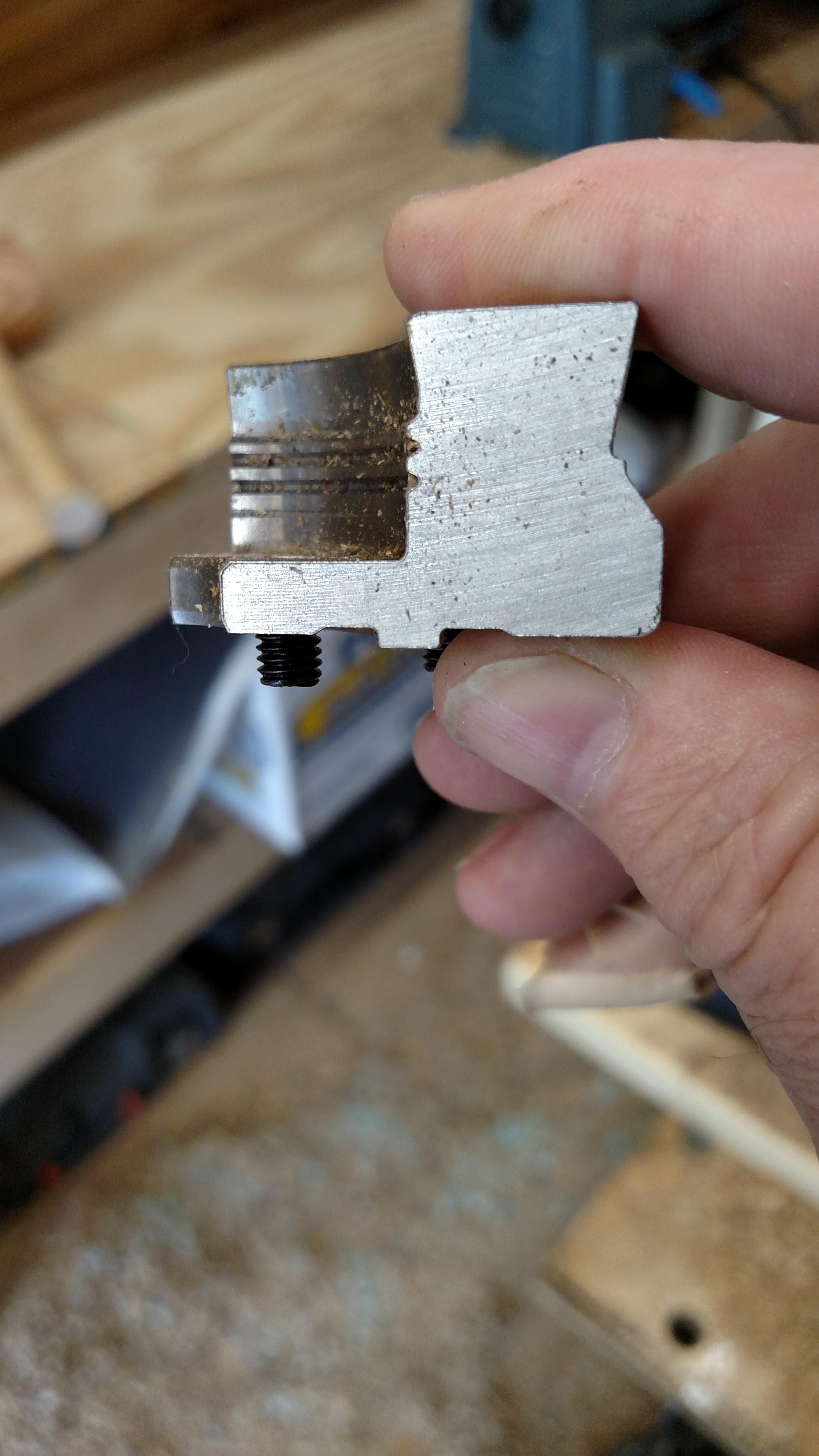

2, This is the new jaw. 1/2" deep.

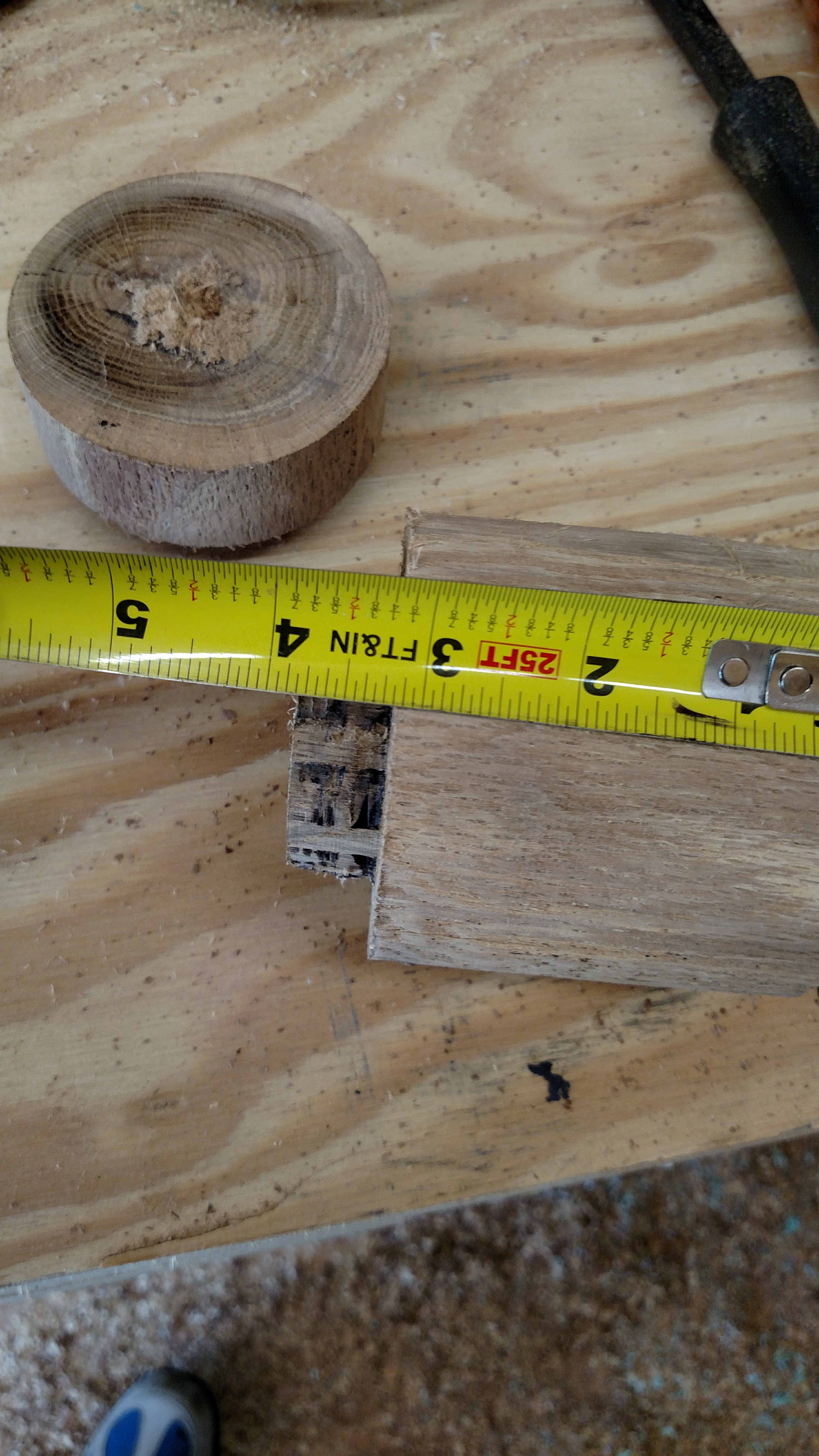

3 & 4, this is the wood I am trying to turn.

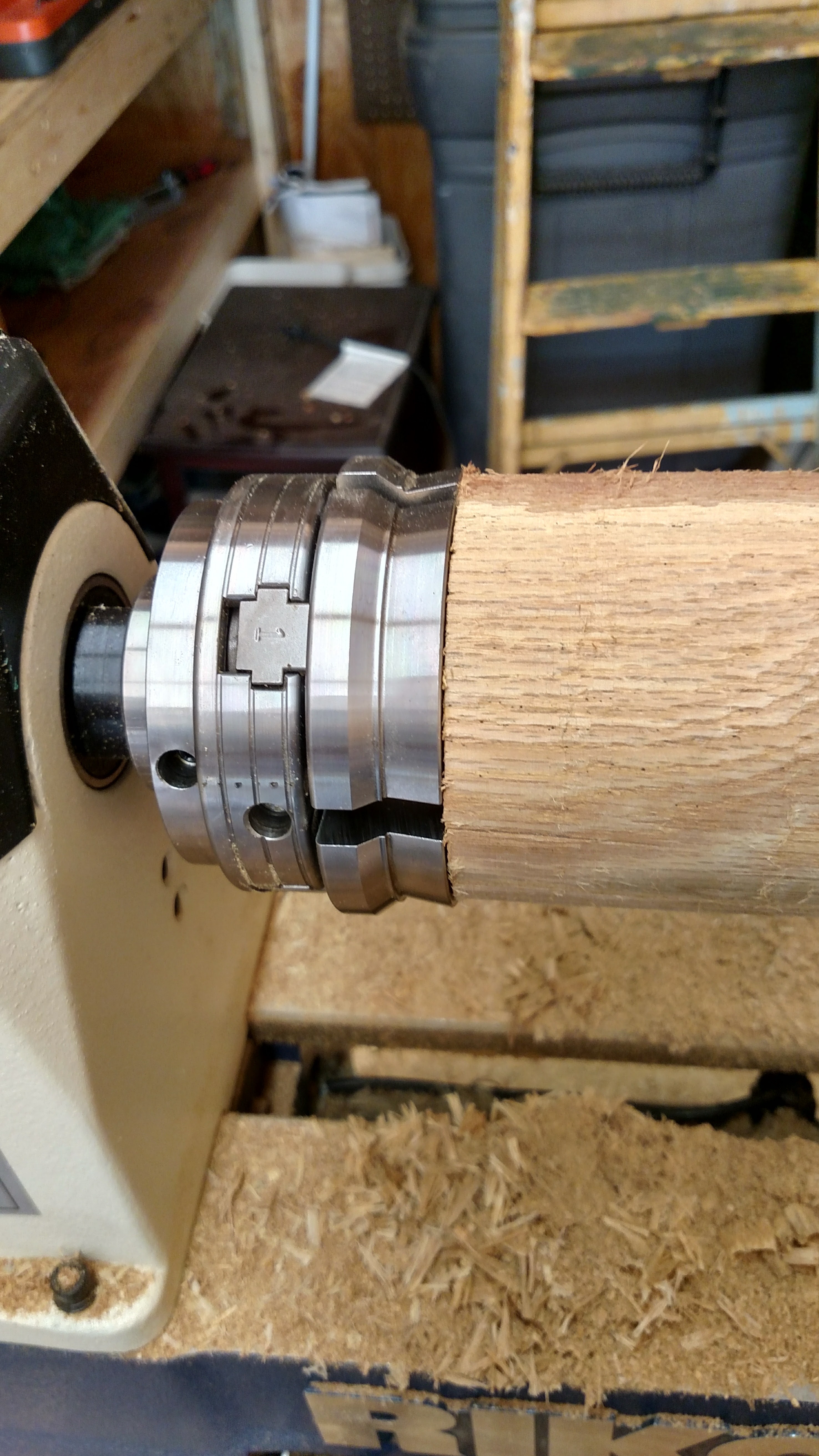

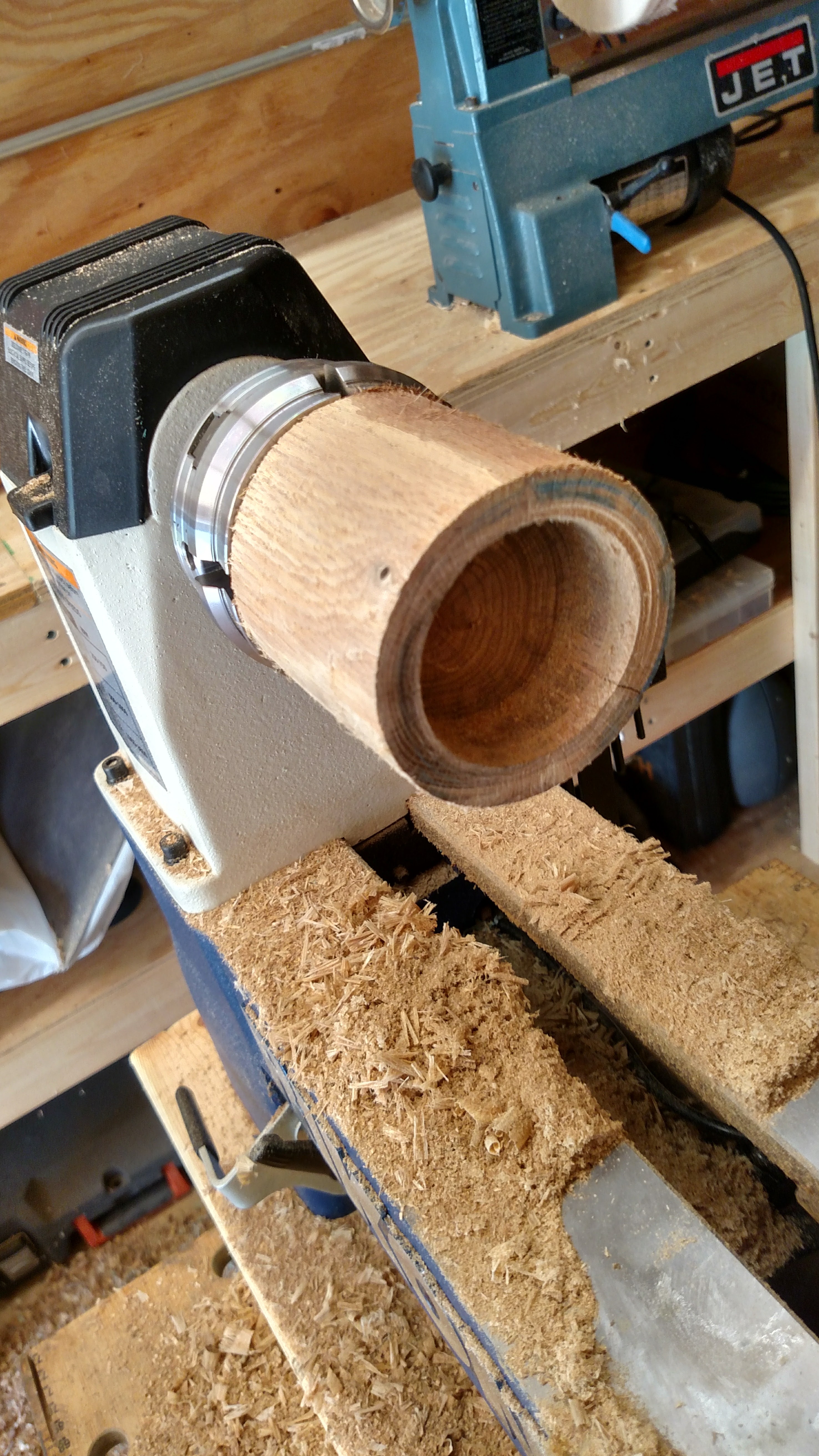

5$6, here is the wood in the chuck.
Sorry I left a few things out. I have tried using a bowl gouge, spindle gouge, square carbide tool and round carbide tool. I am turning around 1650 rpm. Nothing seems to work.
End grain can be tough/hard but still turnable. When I turn something like this, I do what Gerald mentioned and use a forstner bit to remove the bulk of the material. With a large hole drilled to the depth of the hollowed portion, the forces used to finish the opening will be primarily directed toward the headstock/chuck down the side of the opening. This should help prevent the piece from coming loose.
My choice of turning tool for this would be primarily the round carbide cutter . Then the square carbide cutter to sharpen up the side wall/bottom transition.
As for the speed, I usually go pretty slow- but that's a personal choice.
In you picture of the jaws in contact with the wood it looks like is a small gap between the jaws and the wood? May just be the angle of the picture. That surface must be clean and contact the face of the jaws squarely. I can't think of anything else that might be happening.

It must be the angle. I had a small gap between the jaws and wood to begin with and then trimmed it down a bit so it would set tight to the jaws.

On a turning this size the spindle gouge works very well after drilling . May be in the video but with the spindle gouge flute up or to a 10 o'clock position you can hollow the inside. This method is used by a lot of European turners. By the way the jaw depth is measured inside the jaw and I have never seen a nova jaw less than 1/2 inch.

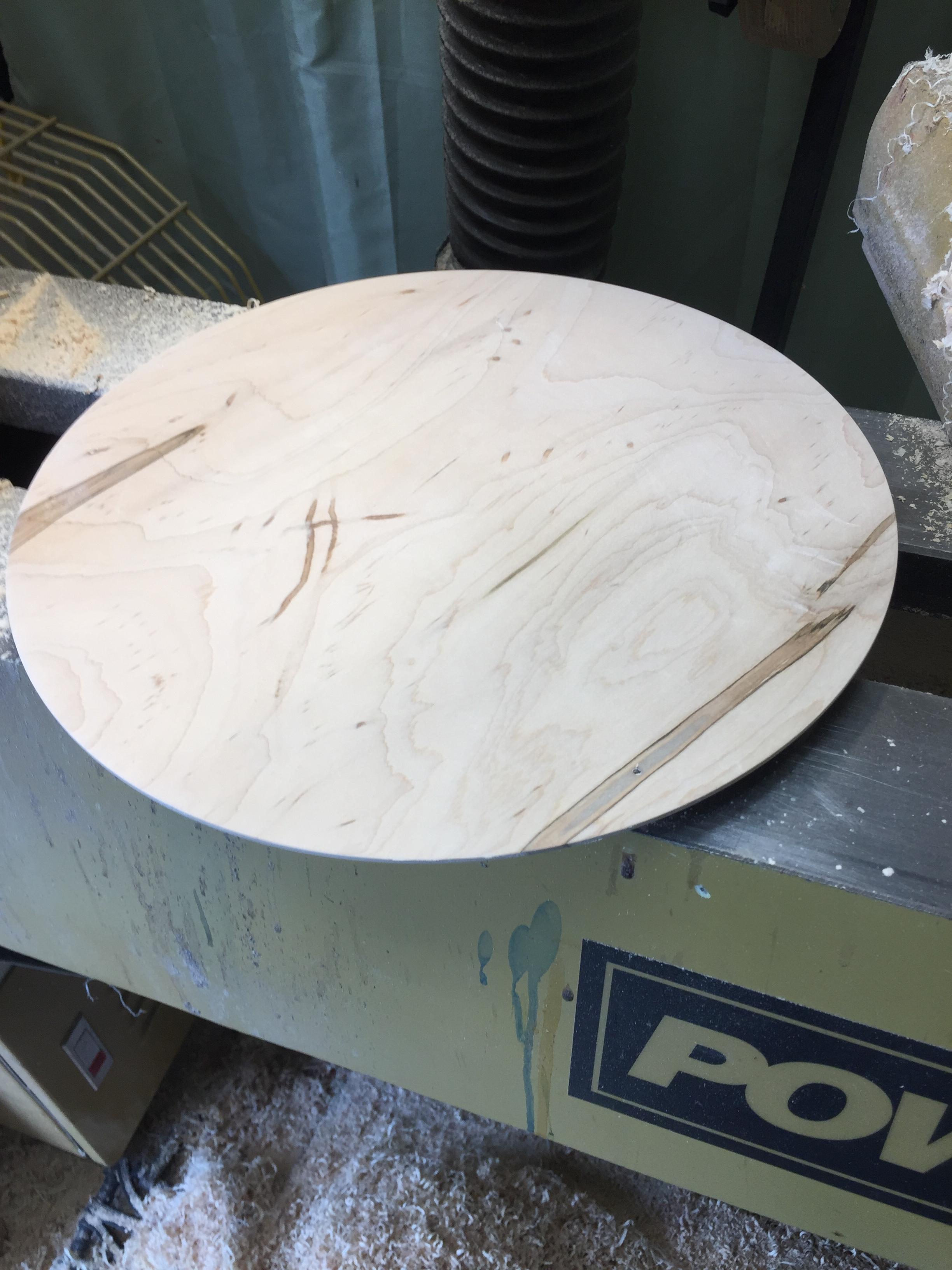

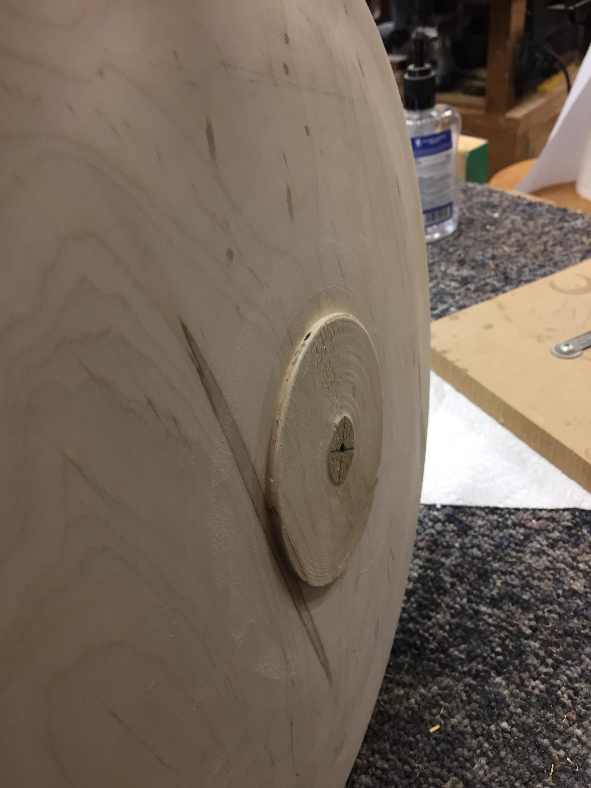

Something I just thought of. I do believe that there is something about your tenon the chuck doesn't like. I don't know what exactly but I do know the length of the tenon is not your issue. The strength comes from a good bearing surface where the jaws meet the wood, that is critical. A tenon doesn't have to be very long at all for this to work. As an example here is another plate I just took off the lathe. It is soft maple about 12" diameter. I only had 4/4 stock to start with so I didn't have much room for a tenon. The tenon on this piece is just over 1/8" long. The jaws need only just enough to clamp on. I did keep tailstock support for as long as possible but also relied on the chuck only a good bit.
Stevetenon.thumb.JPG.1fd3596820e920f4db16710c49dddace.JPGtenon2.thumb.JPG.bd026809703d52ef4b7cce967318b18d.JPG
I drilled out the center with a 1 inch forstner bit. I slowed down the lathe from 1600 rpm to around 850 rpm. It made a world of difference. No problems now. I guess I will cut slow and speed up to sand.
