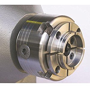

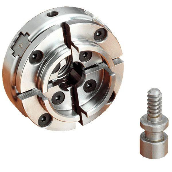

1 hour ago, HandyDan said:
What kind of jaws did it come with?  Some are straight jaws and some are dovetail jaws and it matters how you cut the tenons for them.
The jaws have a full dovetail on the outside. On the inside they come up straight half way and just a small dovetail toward the top. I will try to get a picture. Sounds like I might need better jaws.
The jaws on my chuck are like these.

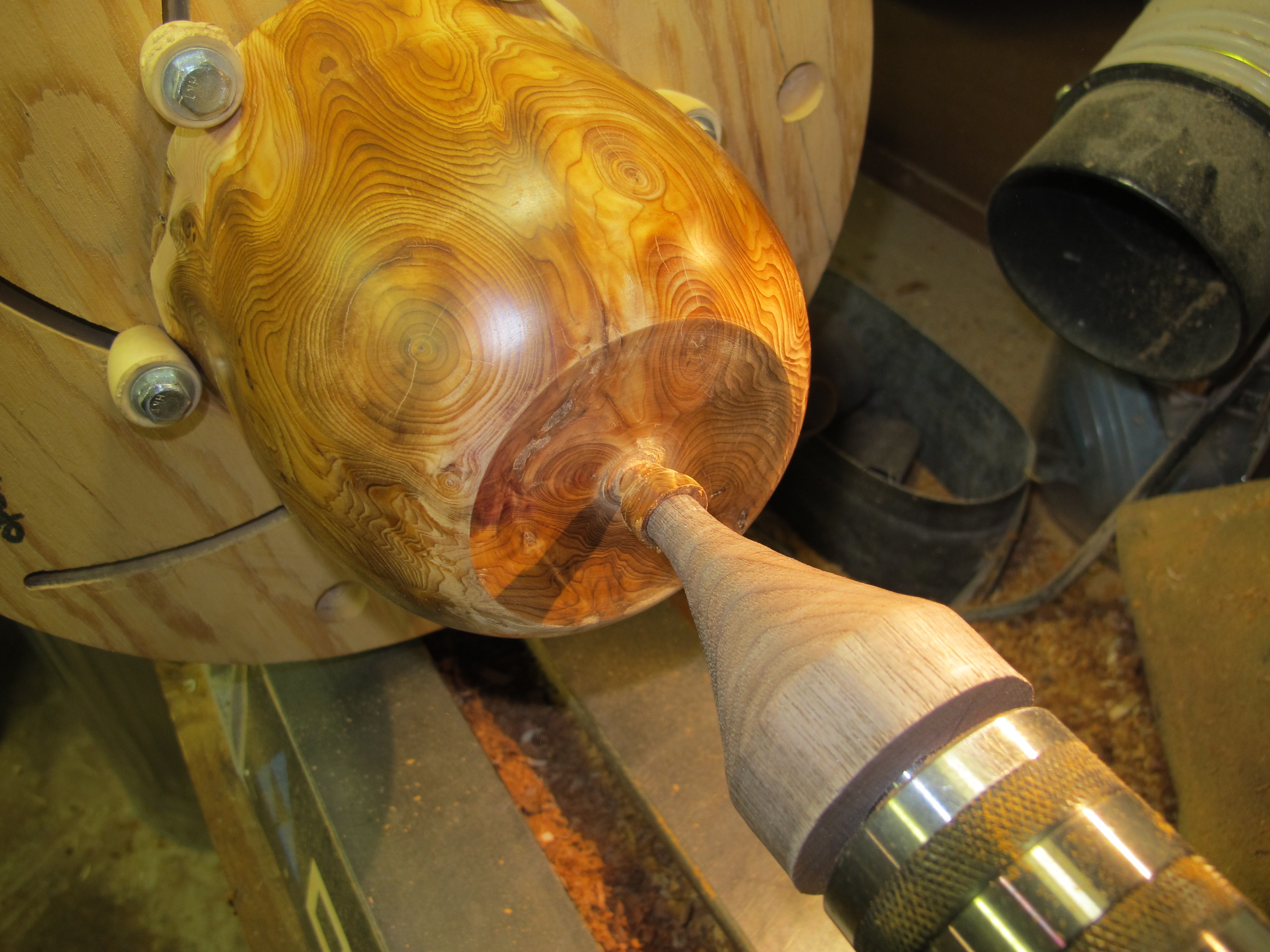

Don't forget the tailstock! If you are worried about the point of the tailstock damaging the turning, you can make a "cover" for it- this one is for a live center-
It is just a piece of hardwood drilled to fit snuggly over the live center. It applies pressure to the turning but the point doesn't damage the wood.
