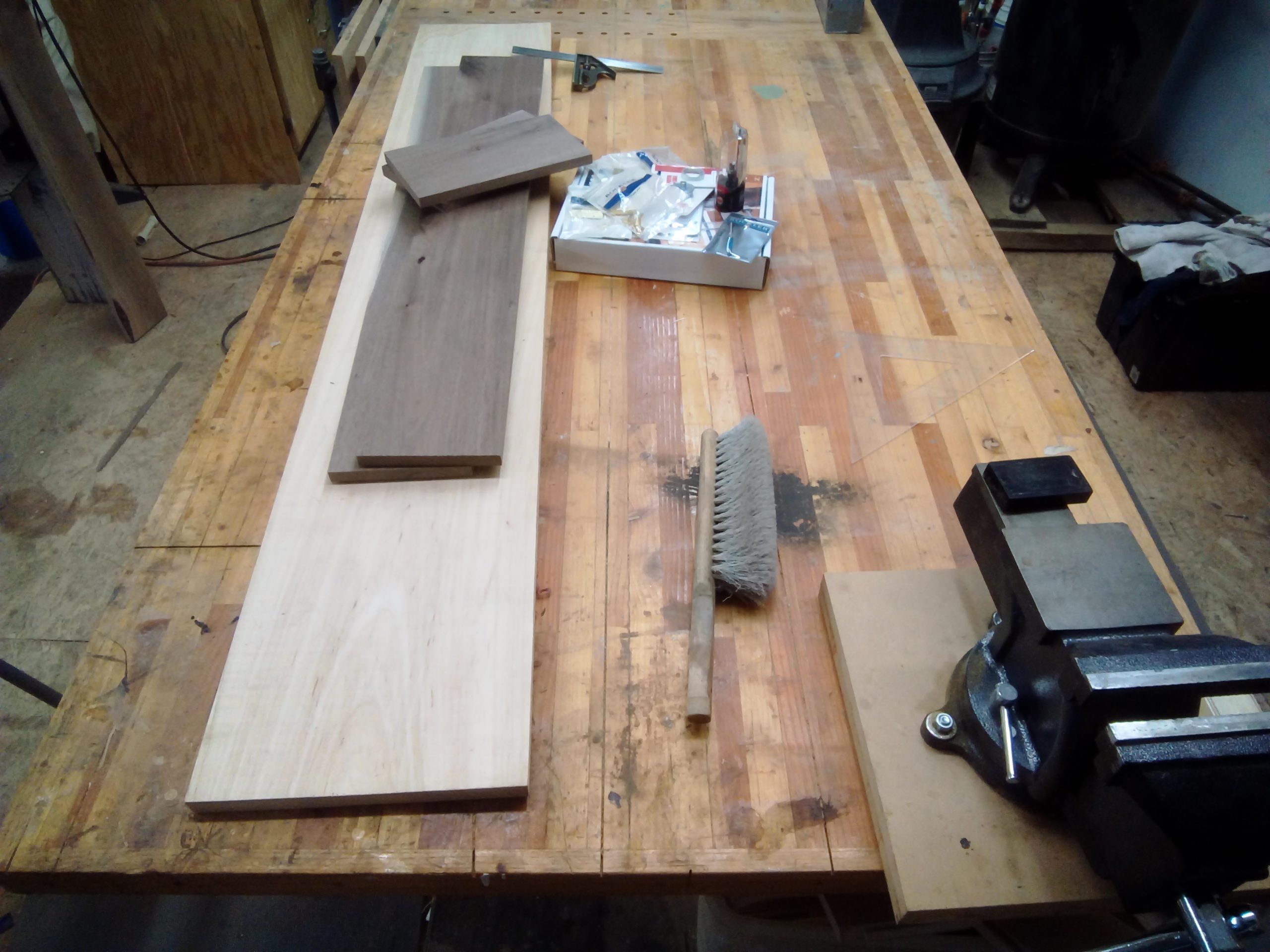

April 8, 20179 yr Author Popular Post comment_105583 For Kelly. Four pieces of 5/8" walnut cut to size for the sides and ends. One unsullied piece of maple, which will be the raised panel and dove tail keys. The pile of stuff to the right is the hardware and toys to help with installation. Tomorrow, we'll get some dadoing and mortising done. I'm not slow, just careful. Besides, the early bird may get the worm but, the second mouse gets the cheese. Report

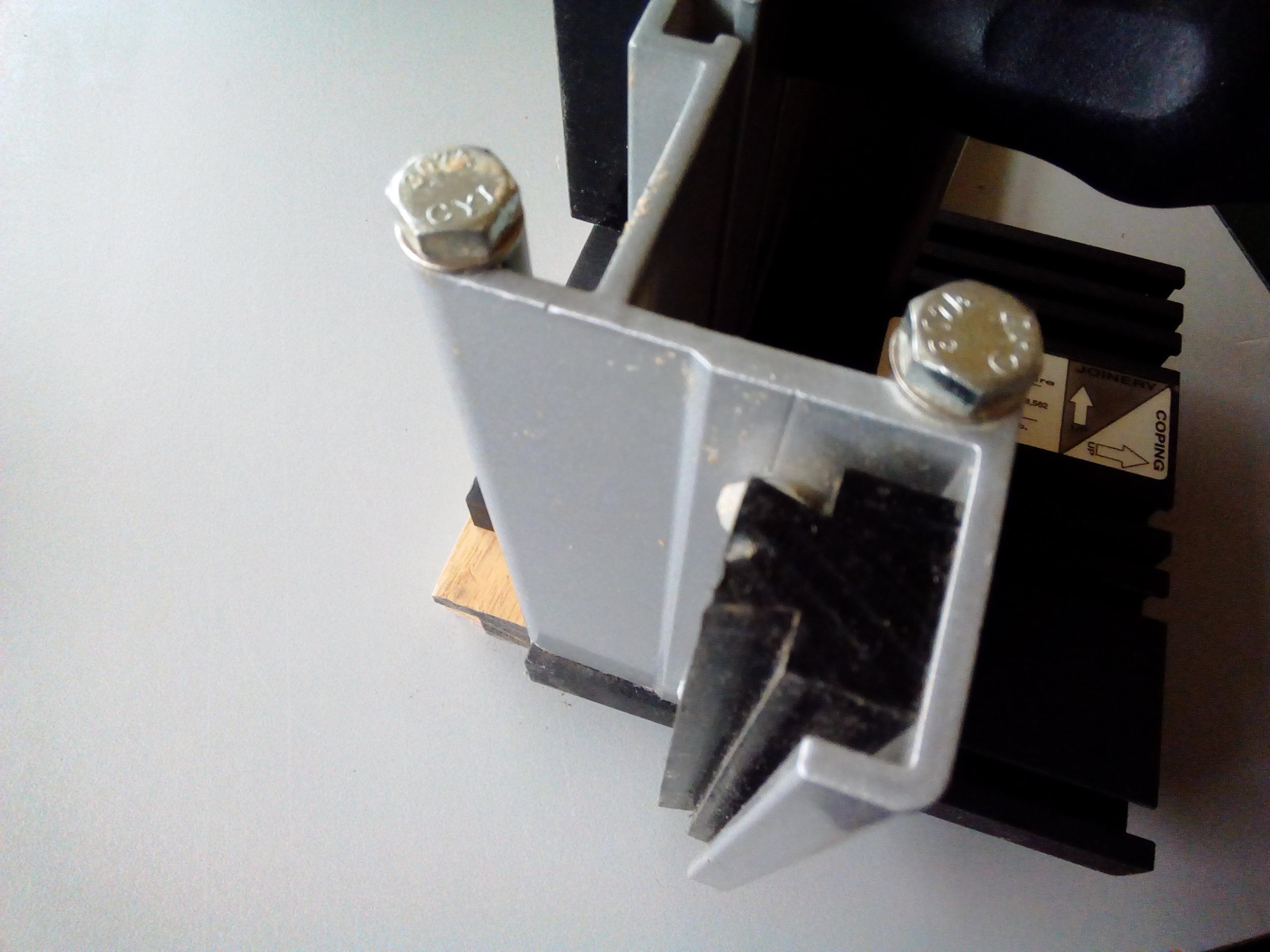

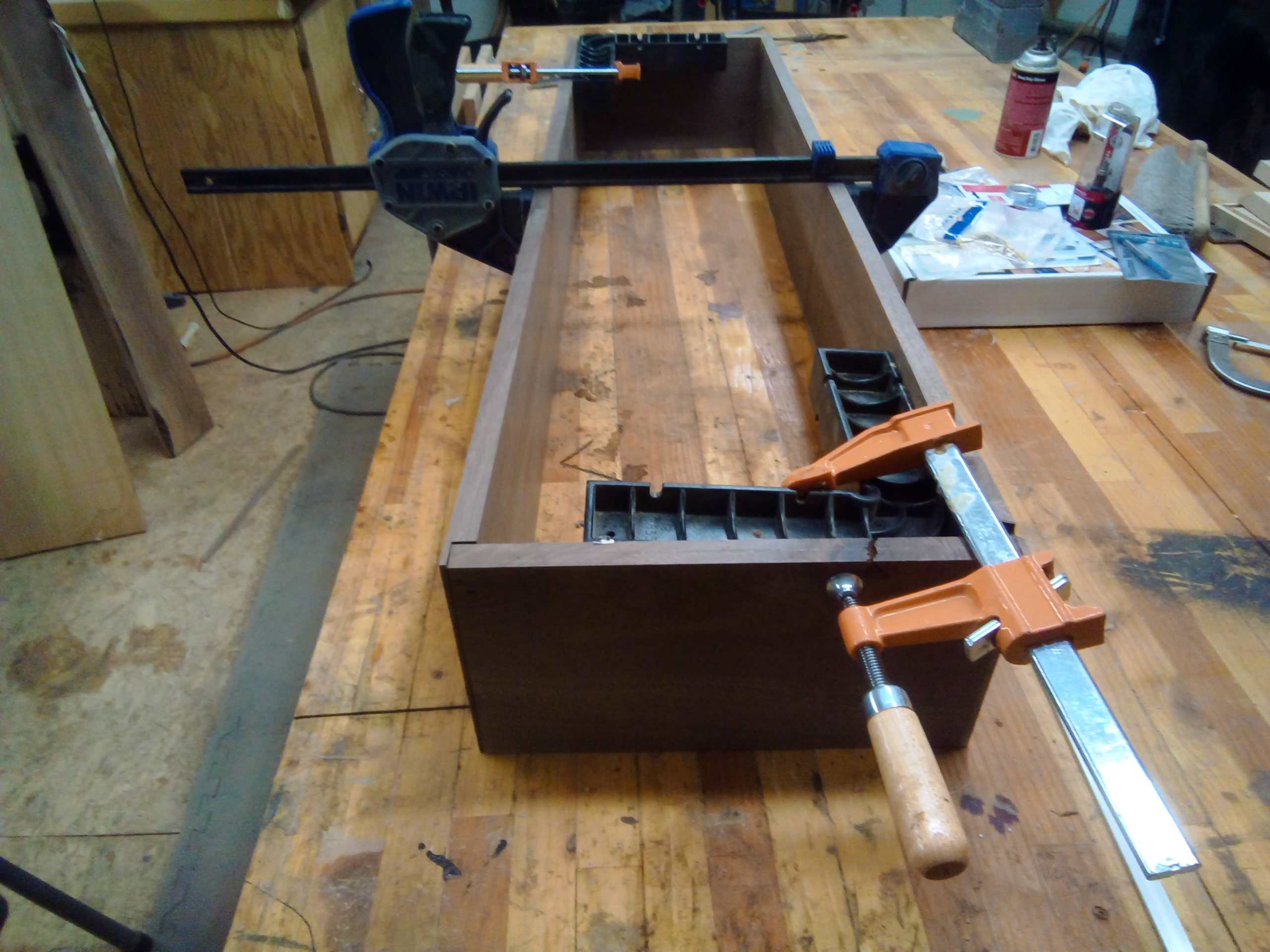

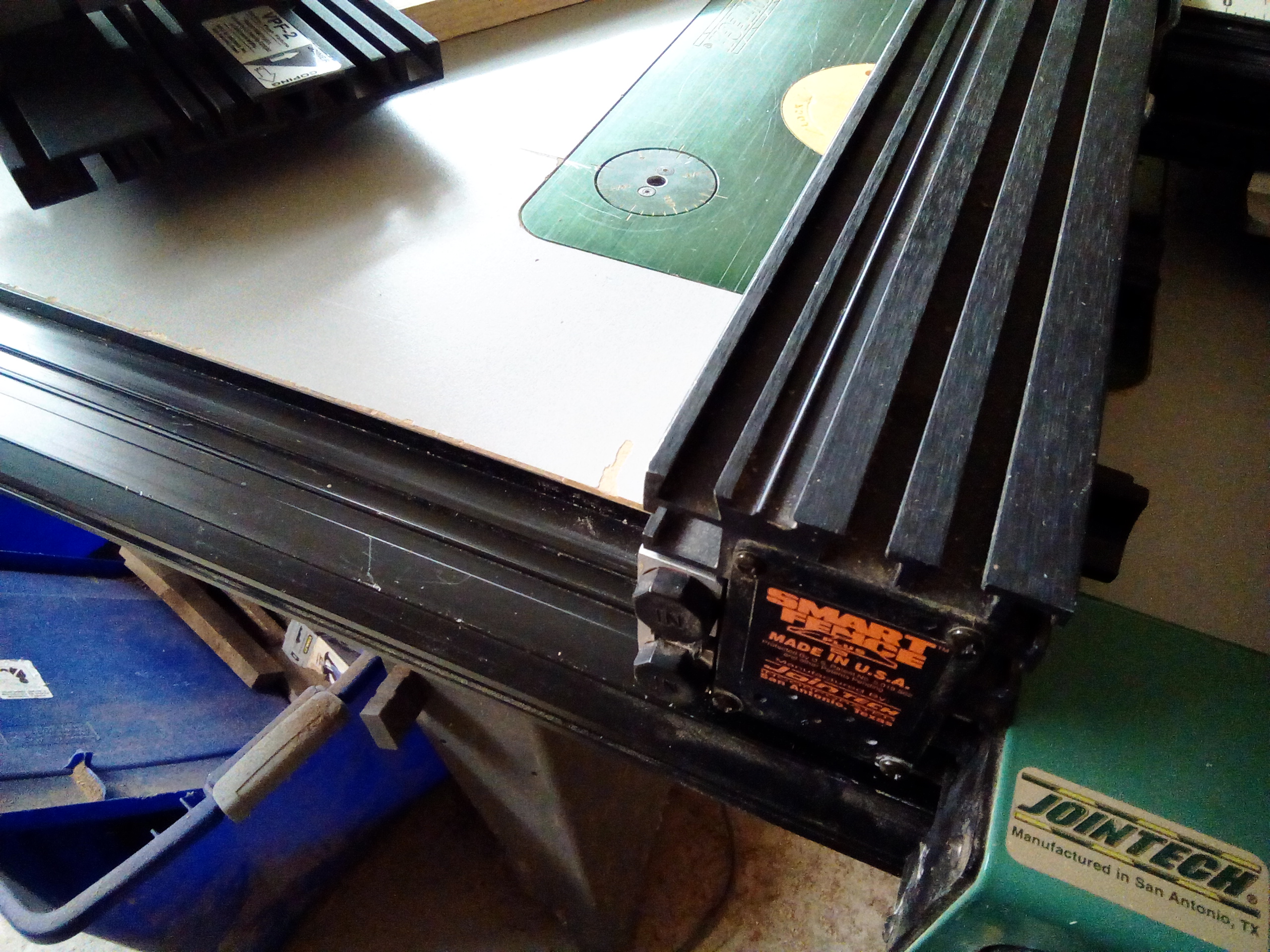

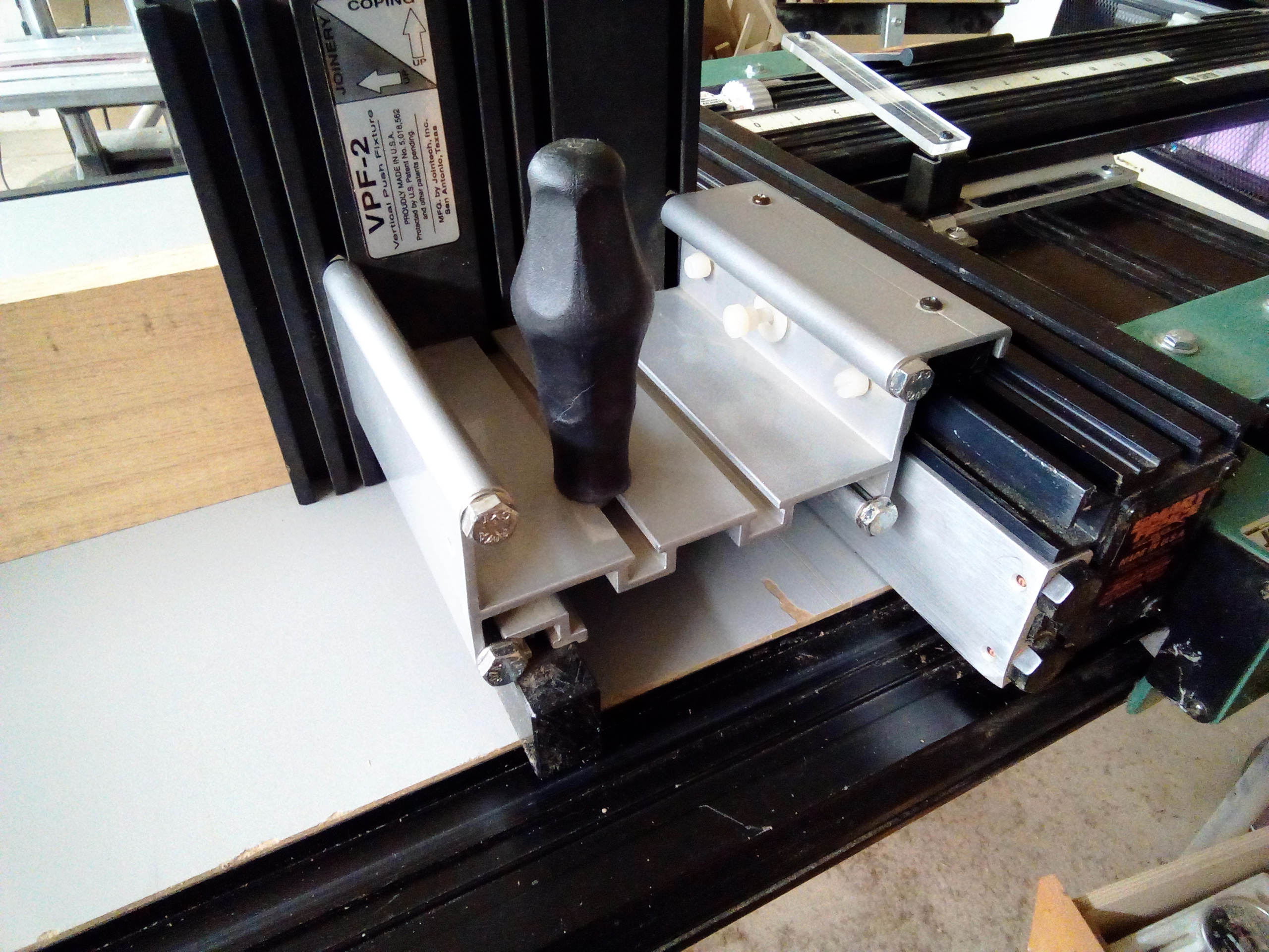

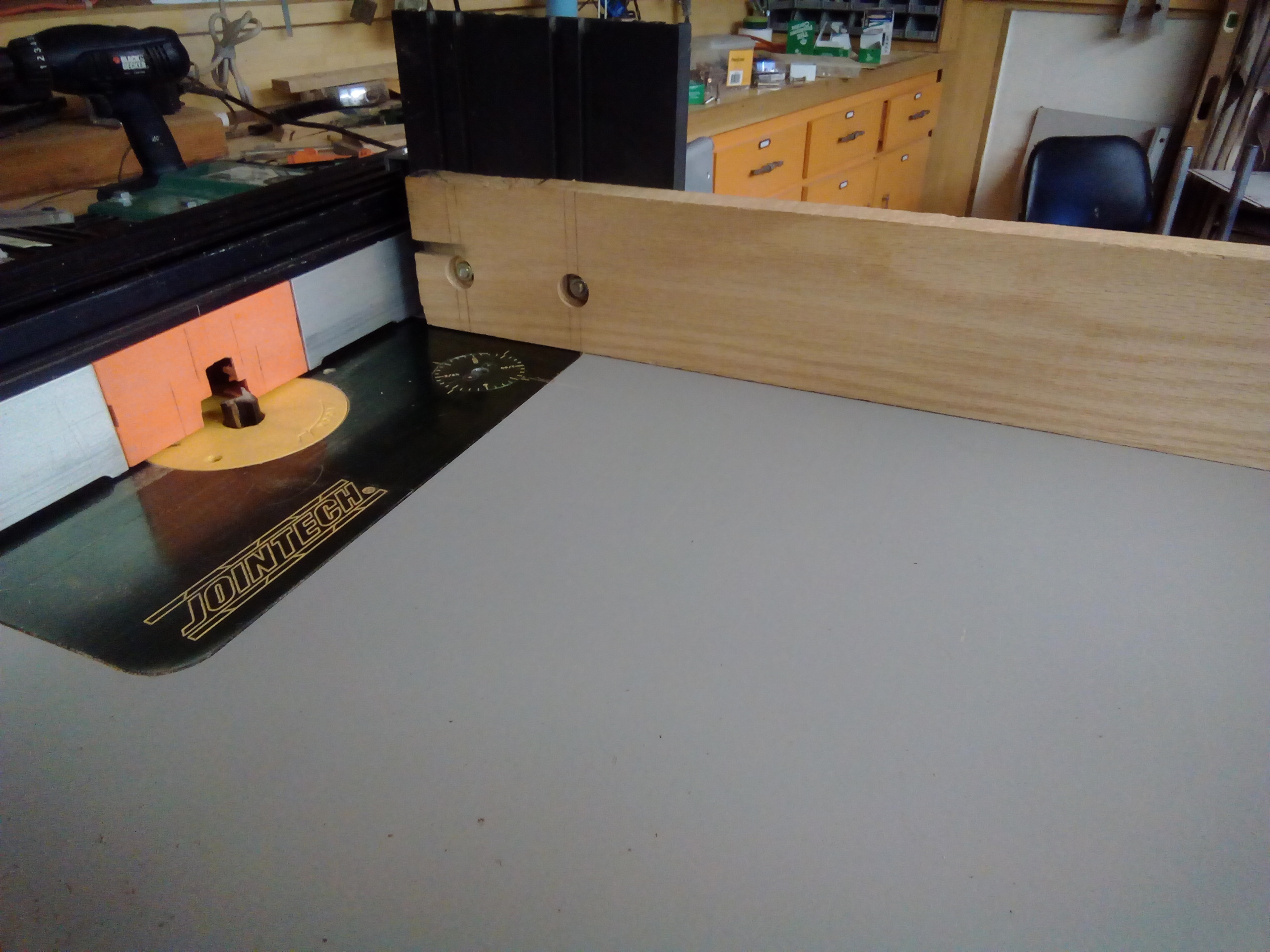

April 10, 20179 yr Author Popular Post comment_105870 As mentioned in John's Monday morning thread, here is the dove tail on that pusher thingamajig. The dove tail slides in the left most slot on the fence. Here it is installed, from the operator side. Here, we see the extension installed to handle longer stock. Pay no never mind to that slot on the end. Just a piece of oak scrap. The results of the rabbeting in a dry fit. Not too bad. After a bit of tinkering, the next step is dadoes for the bottom panel. Edited April 10, 20179 yr by Gene Howe Report
