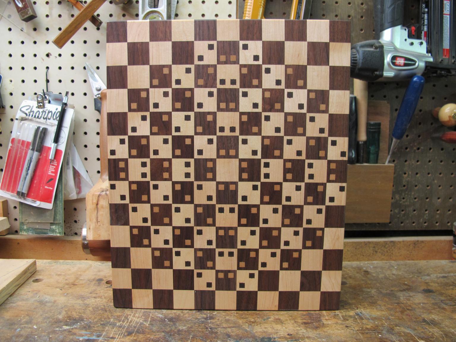

Lately I am hand cutting mortises, they are exposed mortises, I had a Shop  Fox years ago that I got rid of, but it could not produce clean perfect mortises. (No offense Lew) but if you see Lew's checker board, you can see the little side divets that the mortising chisel made.

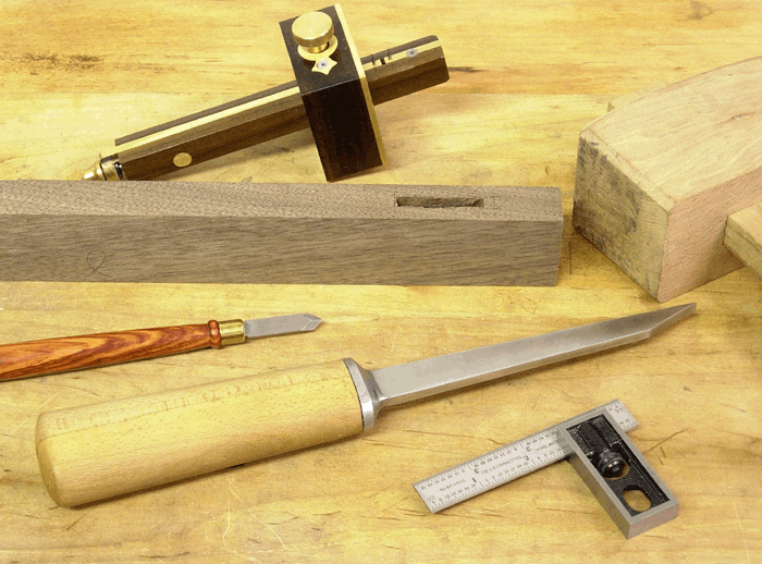

I think I finally found the correct chisel for me Steve. I purchased the Narex 3 piece set awhile back, and while they seemed alright, I just wasn't getting the solid registration that I expected from great chisels. I bit the bullet and purchased this 1/4" English (Pig Sticker) chisel made by Ray Iles. My gosh what a difference! It's hard to explain, but my what a difference.
Source:https://www.toolsforworkingwood.com/store/dept/TBMC/item/MS-MORT.XX
