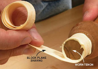

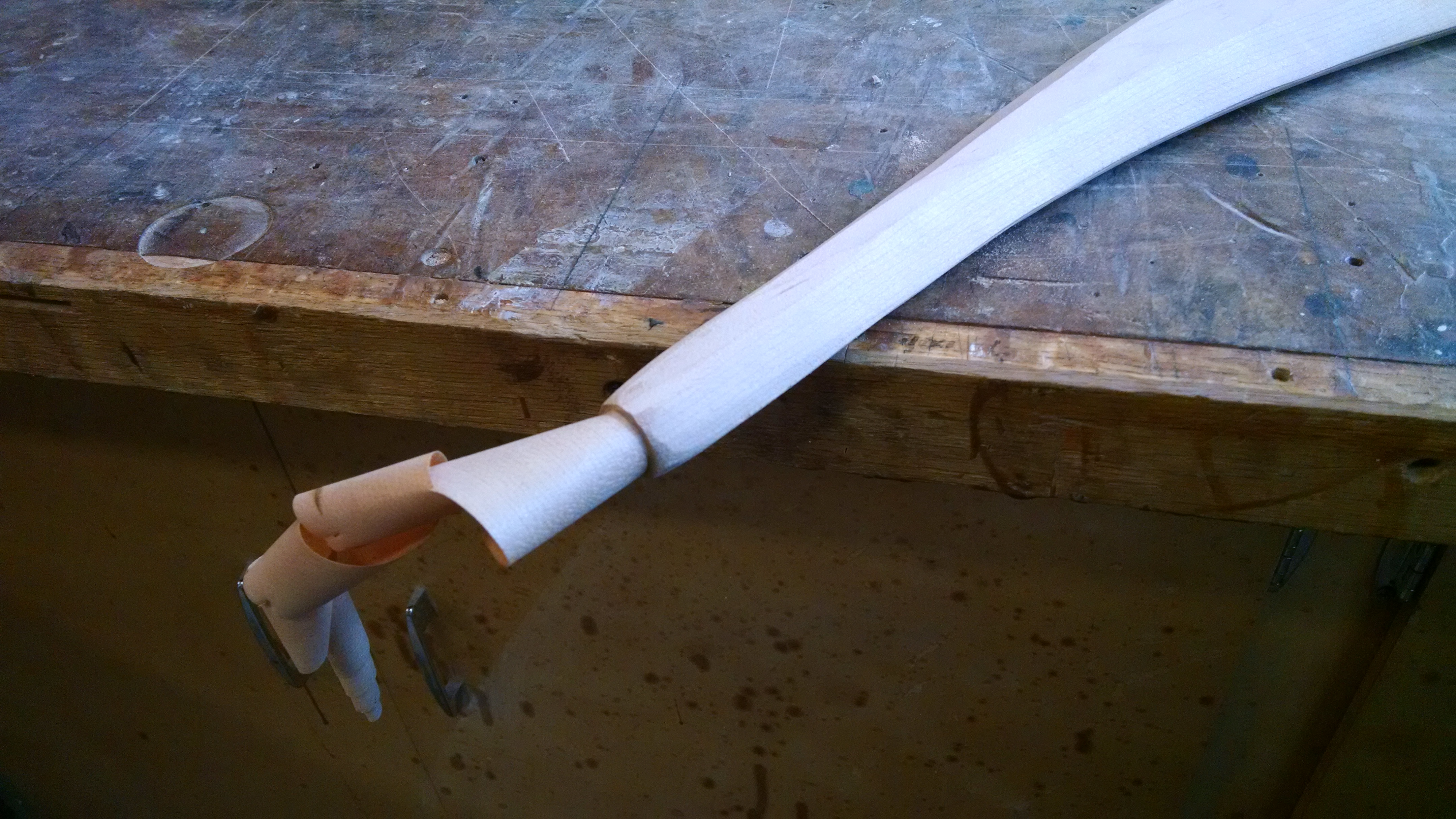

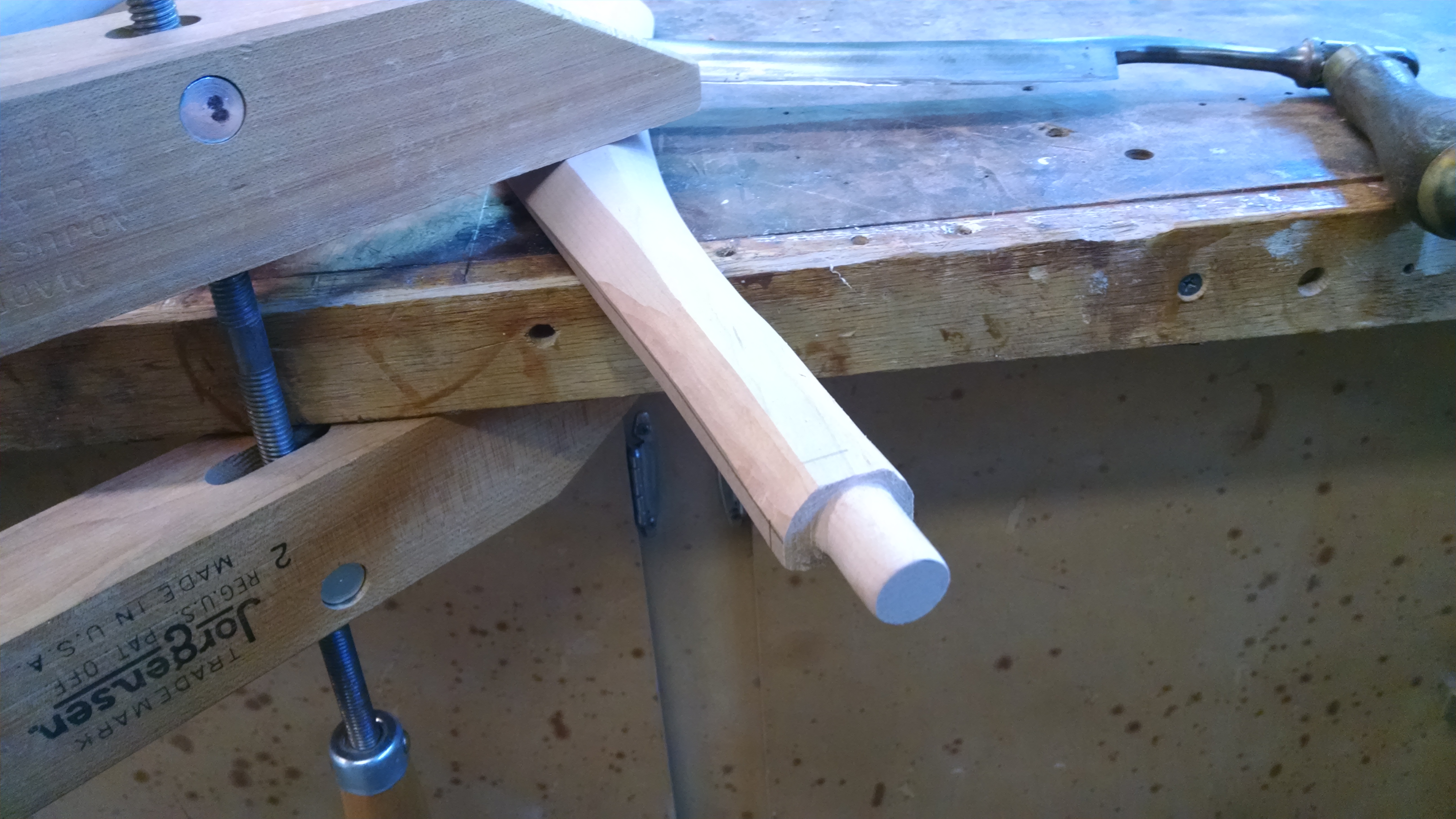

March 12, 20179 yr Popular Post comment_101927 While fitting arms to a rocker I am building, I pared down one side of the tenon a tad too far, and I had tenon that was too loose on side and too tight on the other. I did a little research and found a method that worked beautifully to fix this problem. Since the tenon is the last part that is shaped in the arm, this means I've already invested a bit of time in the arm, so I was not about to trash it over a loose tenon. So I wanted to salvage the arm. I had my own ideas on how to make this tenon tight, small un-viewable wedges in the mortise, among other ideas, but this idea I came upon was absolutely brilliant. Take note how loose the tenon is, then by eye use our block plane and round up a few shavings from it. The tenon below was shaped by hand, a combination of a hand saw and file, but one side of the tenon was had too much material removed. It looks pretty round, but when I fit it to the mortise, it was a horrible fit, especially after I tried to line up the arm with the front leg, it was angling in the wrong direction. Apply glue to the tenon, then wrap the tenon once with the shaving you produced from the hand plane, trim it, then wrap it again, build it up oversize, this way you can always reshape it. In this case, I wrapped it twice, (in the image below the tenon shoulders are shaped, I worked the shoulders to where I needed them thus the reason why it's a different look than the image above. But it's the same arm.) Trim the access off with a razor knife or other sharp implement of your choosing, and let it set. After I let it set for just an hour, I was able to re-shape the tenon and get the tight, exact fit I needed. It was a great recovery from what I first thought was a nearly hopeless situation. I wish I could quote or reference the source where I saw this fix, but in my haste to find a solution, I whizzed right through it, and out to the shop I went for the fix. I cannot take credit for this great idea, but I can show it off! Report

March 12, 20179 yr Author Popular Post comment_101934 I found this, a pretty good explanation at https://www.woodcraft.com/blog_entries/furniture-repair-tips The one thing I disagree with on this image, is it appears the woodworker is wrapping the tenon over and over, this will produce an un-even lump where the layers overlap at the end and the begin of the wrap. You should do as I did, and wrap it once, cut it, then wrap it again, this way you are ensured an even build up of shaving. Report

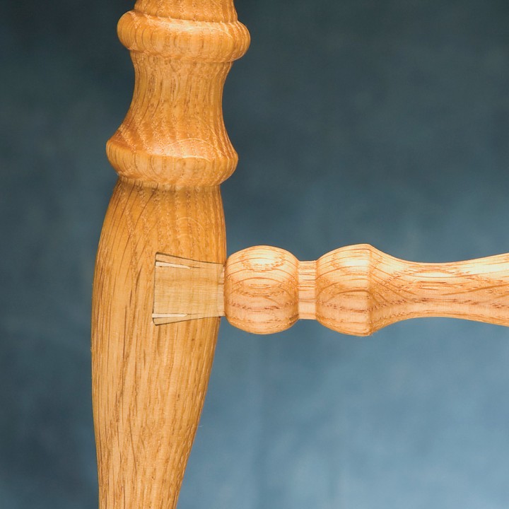

March 13, 20179 yr comment_102010 A foxed tenon is when you cut a slot in the tenon and use a wedge in the end, but also on a foxed tenon the hole (mortise) is slightly wider in the very bottom. What this does is not only fill the space but creates a joint you cannot pull apart without cutting the wood or drilling tenon out. And no I have not done that but learned about it in one of Ralphs Wood quizes. Report

March 13, 20179 yr comment_102019 48 minutes ago, John Morris said: So it would have to be a through tenon? no... use a single double tapered wedge... use this pic as a an idea former... these legs are set up for single wedge wedged fox tenon... here's w/ a double wedge... (cut away)... this joint won't come apart... Edited March 13, 20179 yr by Stick486 Report

March 13, 20179 yr comment_102069 13 hours ago, John Morris said: So it would have to be a through tenon? No usually used in non-thru tenon, but could be used on either Report
March 13, 20179 yr Author comment_102072 12 minutes ago, Gerald said: No usually used in non-thru tenon, but could be used on either Looking at the diagrams here in this topic Gerald, I like it, thanks for opening that idea up here, appreciate it much, always learning! Love it! Report
