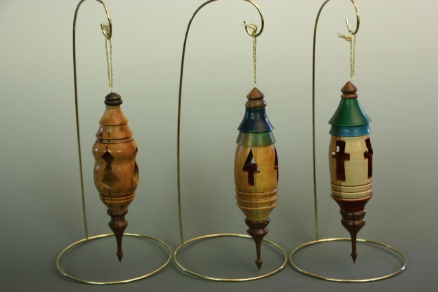

February 17, 20179 yr Popular Post comment_98459 Decided to go ahead and make inside out ornaments for Christmas this year. Much more glue and clamp time than I envisioned not to mention running all the pieces through the saw to size them and make sure they are square. While running them through the saw I keep track of the grain match too. Turning them is the easy part and takes the least amount of time. I start out gluing two pairs together and when they are dry I glue the two halves together to get the square blank. Then they go on the lathe and turn the inside and put some shellac finish on with a rag while still on the lathe. Then I break them apart, turn them inside out and glue two pairs together and when they are dry glue the two halves together keeping track of the numbered pieces to keep the grain oriented. I glued 36 blanks up, here are some of them. I am now working at turning the final shape and will have to put the finish on once they are turned. Whew! I make 60 to give away each year so I still have another batch of 24 to do after these. Report

February 17, 20179 yr comment_98524 nice.... so, theoretically, it should be possible to do the glue-up with alternating light/dark woods? not sure how well it would work. Report
February 17, 20179 yr Author comment_98526 2 minutes ago, p_toad said: nice.... so, theoretically, it should be possible to do the glue-up with alternating light/dark woods? not sure how well it would work. Just envision one of the squares in the pictures with two different colors turned on the lathe into a cylinder. I think it would look okay. I have been thinking of different configurations myself. Report

February 18, 20179 yr comment_98534 40 minutes ago, HandyDan said: Just envision one of the squares in the pictures with two different colors turned on the lathe into a cylinder. I think it would look okay. I have been thinking of different configurations myself. would dissimilar woods be a turning issue.... Report
February 18, 20179 yr Author comment_98572 2 hours ago, Stick486 said: would dissimilar woods be a turning issue.... It can be a problem if one is a lot softer than the other. Color bleed while sanding is another issue. Report

February 18, 20179 yr comment_98581 1 hour ago, HandyDan said: Color bleed while sanding is another issue. what woods to you find to be the worst.... Report
February 18, 20179 yr comment_98593 Stick to answer your question this is cherry and maple. Color bleed would only be a problem with woods like paduak or bloodwood or similar woods. Report
February 18, 20179 yr Author comment_98597 Oily wood would be the ones to stay away from. The dust from them tends to settle into the pores of the other wood. Edited February 18, 20179 yr by HandyDan Report
