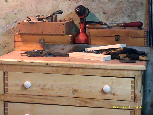

Well, sorted through that pile of Orphans, re moved the chisels and the screwdrivers, and was left with this..pile..
Hmm, got almost than many upstairs,   The Stanley #70 is just along for the ride...thought I make a tote that would fit inside Drawer #4.    Nothing real fancy, just use up the big scraps..

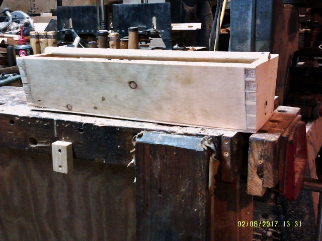

Dovetails into edge grain...do not work.   Cut the mess off, re-located them to an end grain side.   Bottom board now became the side of the tote.
But, I only had ONE long board....I did have a 1x2 about the right length.    Made a notch to house it, and a screw and glue to hold it.   Sized some plywood scraps  to fit..
Plywood is glued and nailed in place, ends are glued up.    Will let this mess sit overnight, and then see about a handle, and MAYBE  a divider or two...

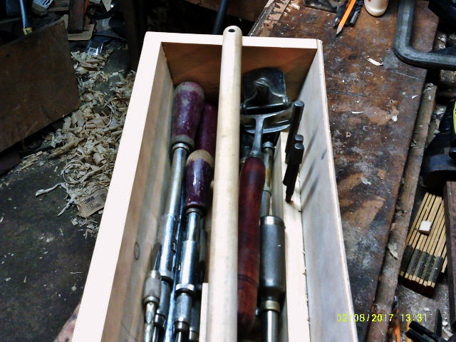

Tote is now completed...

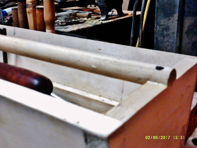

The "good side.   The handle?
I simply notched the ends of a 7/8" dowel  and drove a screw.   Added a bead of glue.   Tote is about half full..

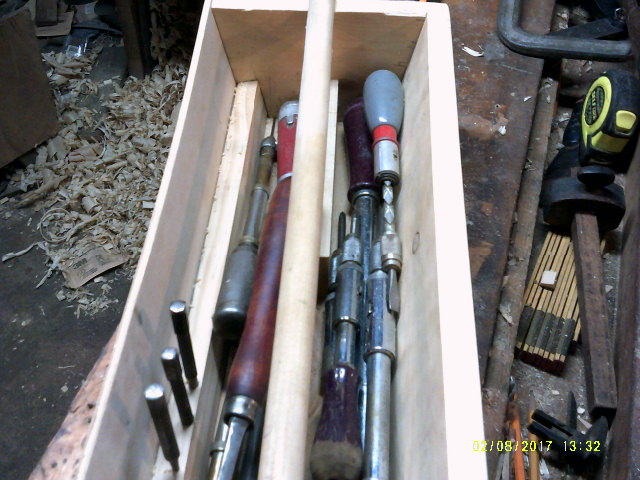

Drills on the right, drivers on the left and there are a few nail sets as well..

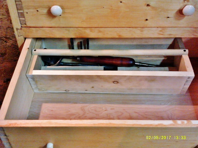

There is enough room, just  in case more should show up:rolleyes: tried the tote out in the drawer..

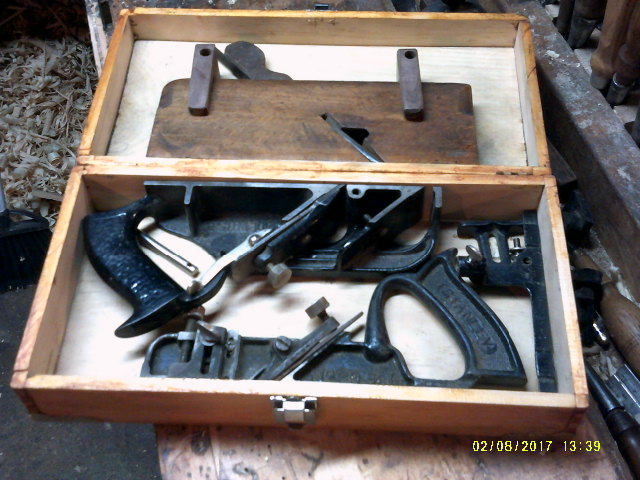

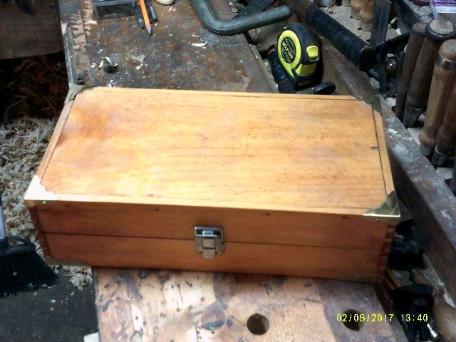

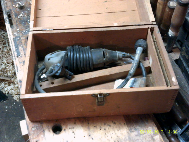

Seemed a bit lonely sitting there.    Got out the OEM Stanley 45 box, and loaded up the Dremel..
Then closed the lid, placed the box in the drawer with the tote, and shut the drawer...
Put all of these "special" planes back in their own box.....
Closed the lid, and then found a spot to stash the box..

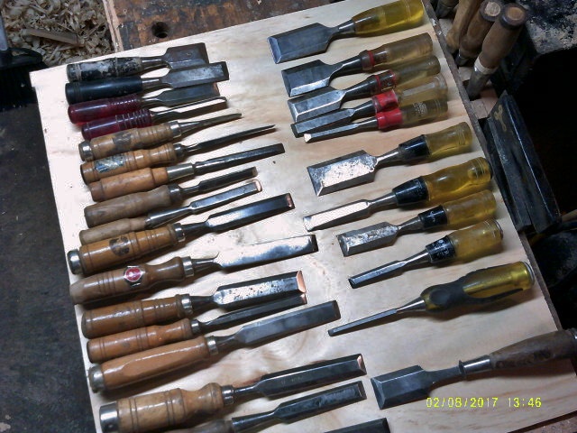

Next up?   Well....I do have a few chisels to box up..
Most of them.   Might take more than one layer?   We'll see how this turns out....

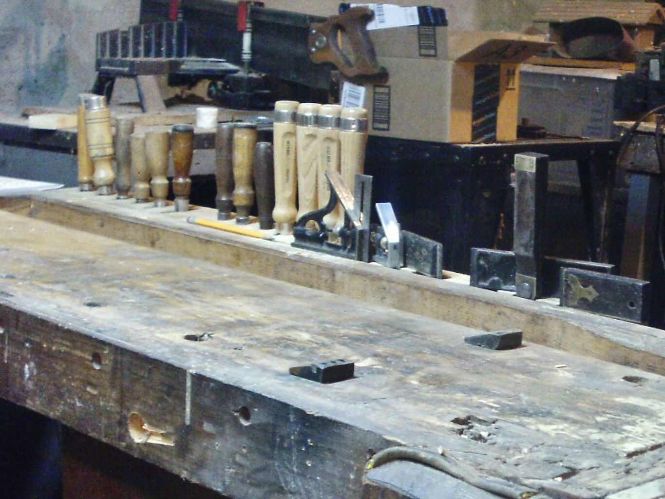

That one is full, at the moment..

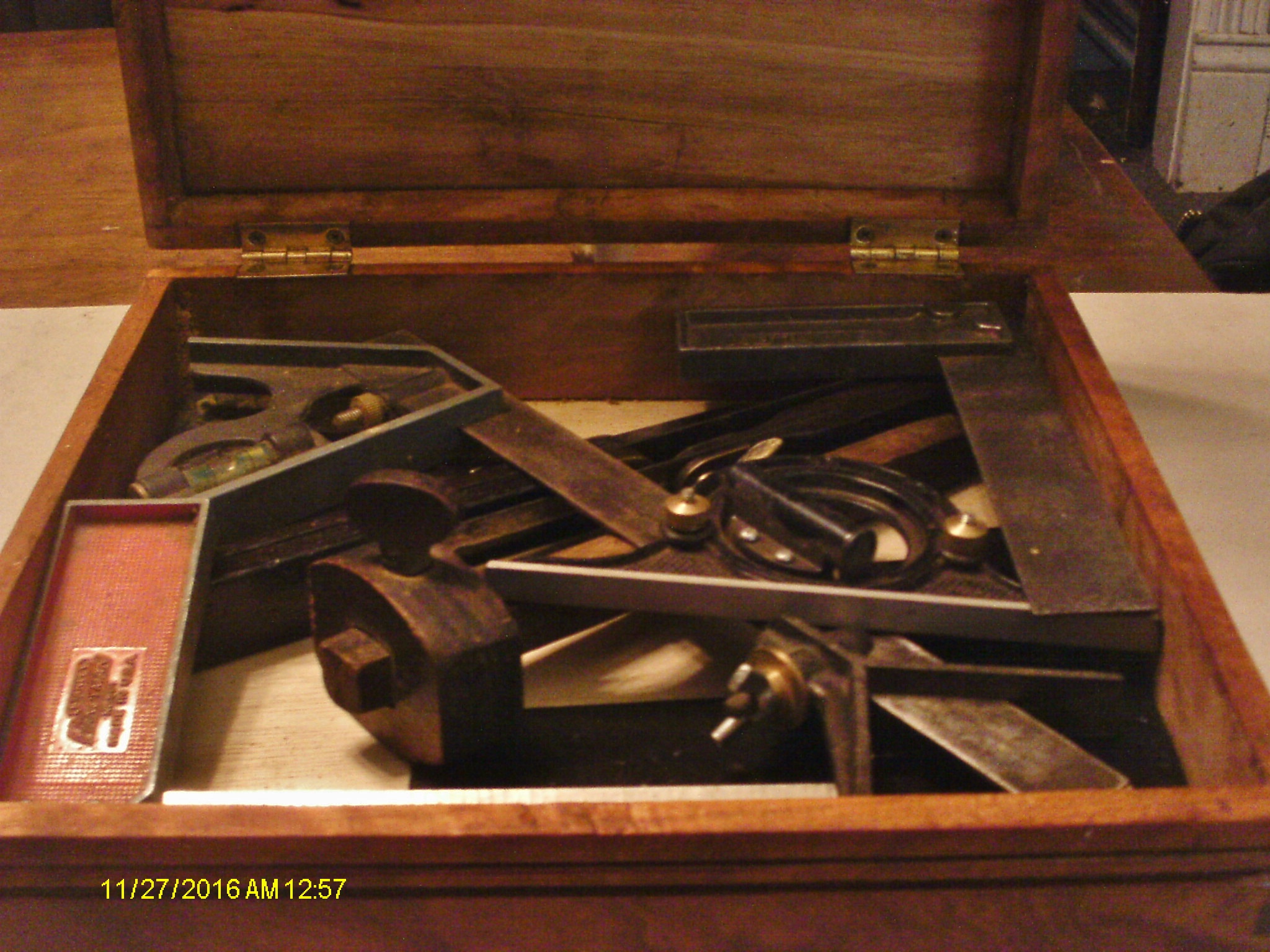

I could move the squares out, but I'd need a new place for them.....
As this one is a bit full, right now....
